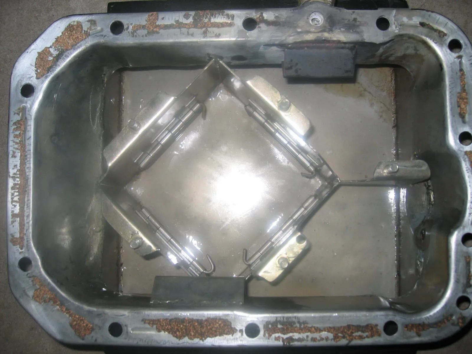

Regarding the pan...it really depends upon the type of driving you intend on doing with your car. If you expect mostly straightline driving with little g loading to either side or front/back then there is little chance the oil pick-up will get uncovered and the OE system will most likely be sufficient. If you intend mild g loading that may see minor movement of the oil in the pan then an AWR pan would help. If you expect moderate g loading then I would recommend a pan with a gate system built into it similar to what we run on our race motors to prevent uncovering the oil pickup as the oil sloshes inside the pan.
Hope this helps???

She is just a daily driver, and does not see any super hard canyon runs since she is so low. So I can probably get away without the AWR pan?
