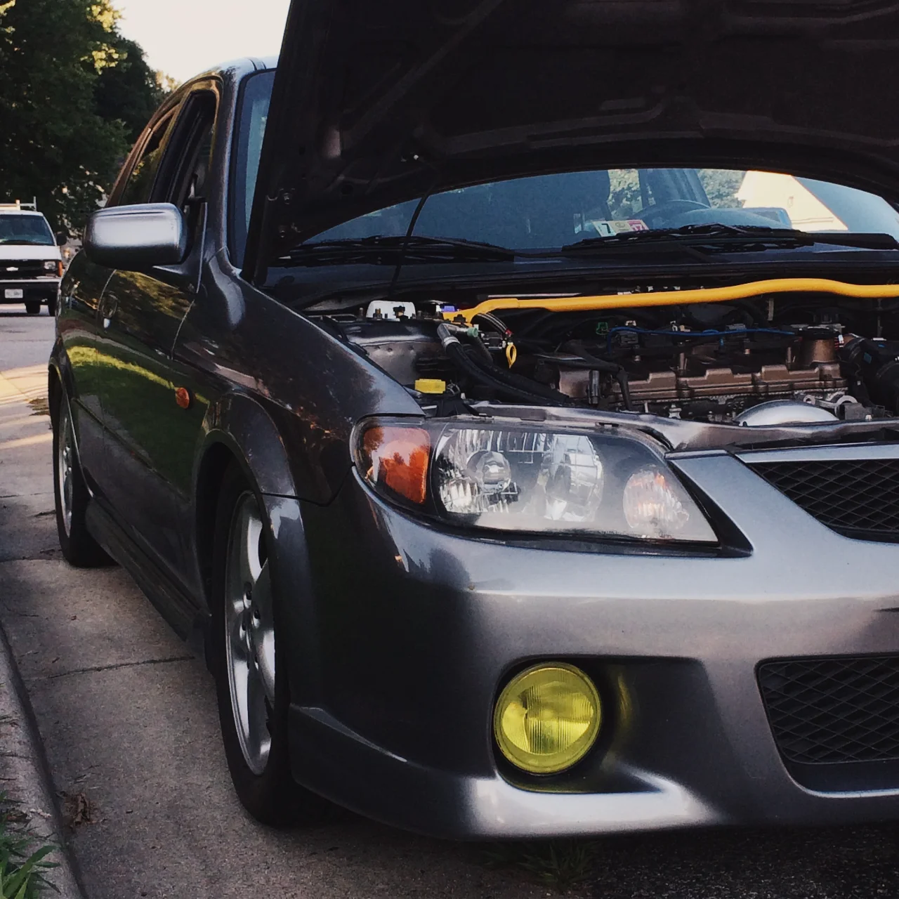

encountered a new leak. what's new this time is it ISN'T an AN fitting lol. this time it was by the rear passenger corner of the oil pan. i cleaned it off and drove it the next day to see where it was leaking from and appears to be the oil dip stick tube where it goes into the engine. i HOPE i'm correct thinking it's that because it wasn't previously replaced so now i ordered an o ring. my mechanic told me he thinks i could just be having too much positive crank case pressure and to add a check valve from my catch can to my intake main to prevent boost going from the intake mani back into the engine. check valve is in the mail and in the mean time, i vented my catch can to see if there's any improvements on the leak.

- wiped off all oil before work, took car off jack stands, drove to work to test it out. pushed it a little
- checked car during my lunch break, oil is present again in circled areas which were cleaned off in the morning (pic 1)
- thinking it is the oil dip stick, i cleaned and wrapped a napkin around it for my drive home. thought about it some more, dip stick would spray in 360 degrees right? (pic 2)
- during my drive home, oil was leaking onto my exhaust causing smoke making me look like an idiot.
- got home, found that napkin around dipstick is dry. found oil coming out of vc at the gasket and at my oil cap (pic 3 and 4)
- going to replace vc gasket and pcv and try again.
- will drive it around the block for testing purposes. i thought i was past this point lol..
- other than that I don’t know what else to do or look for
