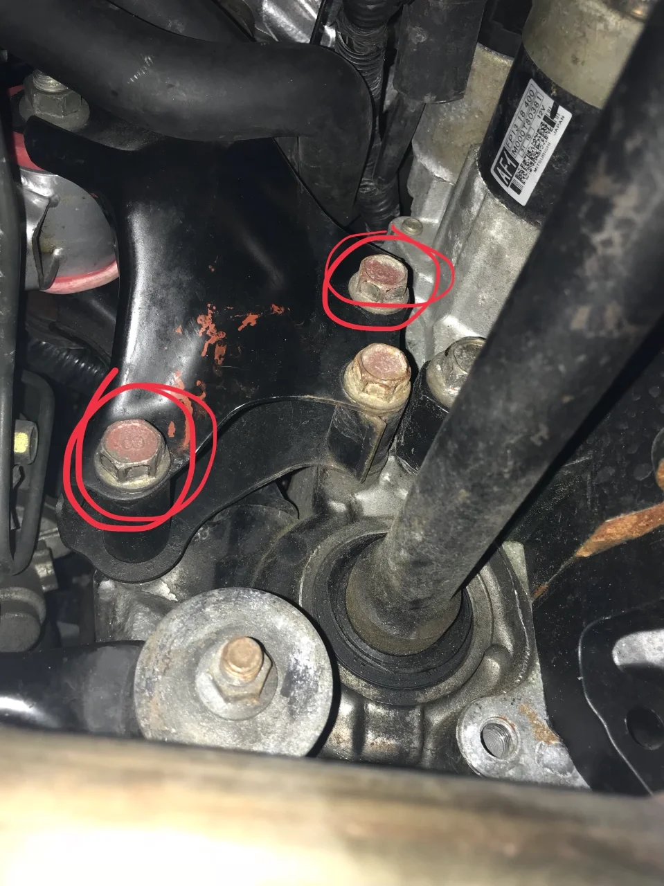

only issue at the moment is the car developed a weird rattle that resembled the sound of an exhaust heat shield around 900-1100 rpm that seems to be coming from the front left side of the car. having the ac on at idle would sometimes rev the car up just enough to trigger the sound as well. rattles while at a stop, moving, clutch in, clutch out, braking, not braking lol. it's somewhat driving me nuts. once the car is revved over that specific rpm while stopped or moving, the car operates as normal. i've been under it twice with it idling and the ac on and couldn't pinpoint where the sound is coming from. couldn't find anything loose. it sounds loudest near the area of the trans and intake mani from under the car. looking under the hood you don't hear it at all. i'll have to bring it to a friend to have him take a look see when i get some time.

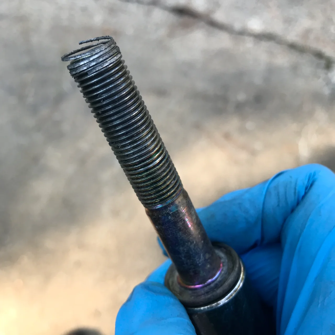

My mechanic friend found the rattle. The rear motor mount connects to the transmission via a bracket right? There are 3 bolts on that bracket. They were all loose and 2 of them are stripped. Anybody happen to know the specs of those bolts so I can shop for a helicoil kit?
Circled bolts are the ones that are stripped.
That looks like something i had to buy recently.
Its engine Mount 1 close to the firewall and attaches to the manual trans from its side?
If so,i have the receipt and diagram with the parts number,just have to dig it out.
Give me a day or two since its a holiday weekend to get back to you
