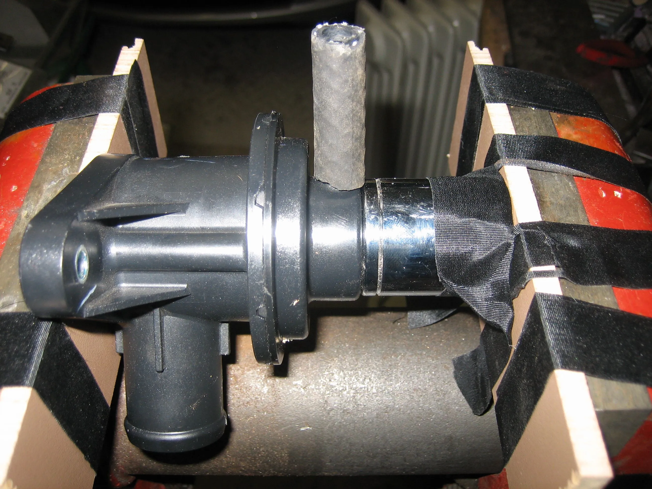

The Valve is glued or melted together it seems, it would be a bad idea to try and rip it apart i would think, unless you just had a spare and didn't mind possibly destroying it, thats why i came up with the heating and crushing method so that the factory seal wouldn't be sacrificed in anyway.

i work as a tech at a mazda dealership so i'll shell out the money to buy a stock one and try it out so if it fails or ***** up i don't care and can just throw it in the trash. it's a neat idea and i know would work if our stockers were metal but the whole plastic i just don't know if it'll hold up to a tap and the pressure from a adjuster nut. I'm replacing my stocker with a HKS SSQ i have. i have the HKS BOV i just haven't installed it yet cause i bought the brad new designed version from HKS the day it came out and didn't think about buying the recirc kit and it didn't come with it so next week i'm ordering it from ********** so maybe i'll just try it out on my stock one when i take it off. i'll let you know whats up but this post here is a great post and idea for a free mod that works

I did the heat and crush on my stock BPV and the butt-dyno says it pulls much stronger above 5500. I think I need to adjust my shift light upward now. :)
I recommend using a large socket on top of the BPV in the vise to improve the heat gun access and putting a piece of fuel line over the vacuum nipple to insulate it from the hot air. The fuel line over the vacuum nipple also guarantees clearance for the vacuum line after crushing.

ok i did this and tried it till i put my HKS BOV on. it worked great boost holds all the way to red line. i didn't even push it in that much about a 1/4" at the most like he said. well to bad it's getting removed soon for my HKS but it's all good. my HKS will be full recirc. so i'm wondering how loud it'll be with my COBB SRI that i have now. one little tid bit of info. let the valve cool down before releasing the vise. i did that the first time and it poped almost right back to stock. second time waited for it to cool down which took like 10 minutes and it didn't move at all.

Did this mod over the weekend along w/ the coil mod. Car seems to pull better, no stutter and pulls to redline.
