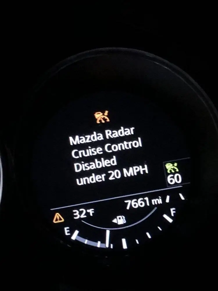

Installed Fortin Fortin EVO One in to my CX5 had few issues but got them sorted out except one I get an error it says “Mazda cruise control disabled under 20mph but, at the time I get this error I’m traveling above 50mph (see picture) and the cruise control can be set and works good it just this error on display that doesn’t go away, also just to mention it is happening only when the car was started via EVO One remote start and when entered the car the push to start button was pressed for takeover, if someone knows how to fix it, please let me know.

Other cx-5 owners seems to have had similar issues (see link below). doesn’t seem to be a problem with the CX-9.
Fortin in their FAQs online recommends choosing a setting that turns off the engine when door opens to prevent it. Which is not a great solution in my opinion but could work. Other than that some people have had success with updating the firmware of the remote start.
Fortin is supposed to have great customer service. I would recommend giving them a call and see what they propose.
I have the latest firmware on the EVO One Fortin response to this issue was to enable option D3 (This option turns off engine when door opens) I agree with you it is not a great solution. So IMHO leaving everything as is and when remote start enabled unlocking the car and pressing brake pedal (that would shut off the car, then restarting it by pressing pts button) that would basically be the same as enabling option D3 and I would not have to disconnect and reconnect EVO for that?
I would think so. some users also said that if cruise control is off when you start the car then this issue doesn't crop up. Turning off cruise control at the end of your drives would allow that for your next restart. I still recommend calling fortin about it. they may have a different solution since (or maybe you already did, not sure if Fortin response above is from their website or from calling them).
I spoke with Fortin Tech Support, they have only one remedy for this issue is to enable option to shut off the car with opening the door. If the cruise control is off before the engine shut off on my car even when the car is started via EVO and the cruise control is enabled during the drive the error is still displayed.
Just FYI Fortin has released firmware update for EVO One Ver 85.11, this firmware fixes "Auto Hold" and Cruise Control error/problem. Updated mine on 2017 CX5 Evo One and now it works perfectly no issues.
@metro2cx5 are you referring to the error “cruise control disabled under 20mph”, something to that effect?
Yes, there has been an update released to tackle the Cruise Control under 20MPH message. Firmware 85.11.
Once the module has been updated to that firmware, RESET the module before reprogramming it to the vehicle. Keep in mind the RESET will also put the bypass option back to default so you will have to change those back as well, or just first enable this option, "Settings Protection" before doing the reset.
