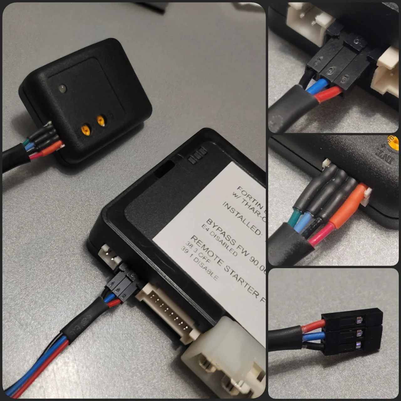

Since I had a dual zone proximity sensor, without the 4 to 3 pin wire, I decided to solder the wire directly to the sensor pins. For the Evo One, I'm going to use header pins
I plan on testing this out this weekend and see how it goes.

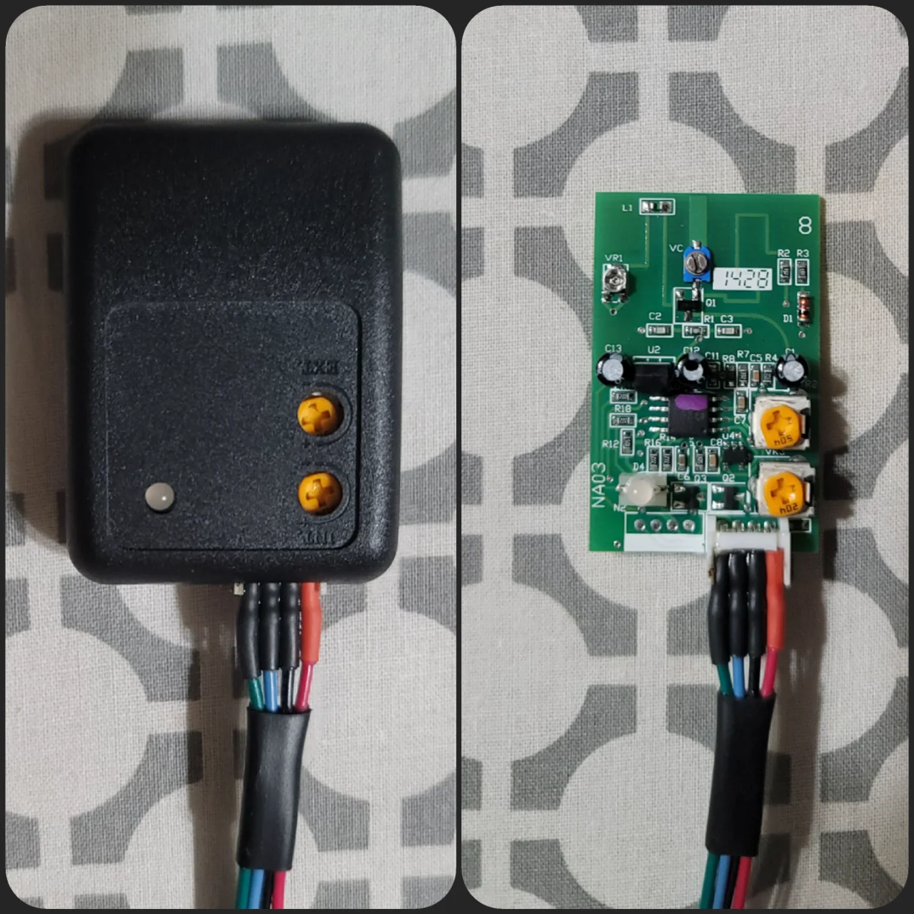

Here's a pic of the Omega AU-94TM Proximity Sensor.

@RedBaron - I dry fitted and tested it out and works great! It does the warn-away (2 beeps) and full alarm without any issues.
Below is the link... WARNING - LOWER YOUR DEVICE VOLUME BEFORE WATCHING IT.
I need to do the final install and adjust the sensitivity setting and lower it down a little.

How did you wire it to the Fortin (where/what pins?). I assume it's to the black "F" shock sensor (?) connector, but I can't find any pin-out of that connector in the instructions.
Also, when I installed, I just enabled E4 as the instructions said. If you disable it, can you still lock/unlock with the remote and door button (is it just the walk-away that's removed?)
Excellent! Thanks.
I got the pin out in the one youtube clip that exist from Lessco. From left-to-right, ground-sensor-positive. The header pin connectors is a perfect fit. On the sensor side, I connected the blue and green together to the blue on the Evo-One; then red to red, black to black.
Yes, lock/unlock still work with the remote.
I just have to manually unlock the door since the door handle to unlock the door is disabled. It's a little inconvenient but it's better than going through the back lift gate to unlock the doors. 😉
The walk-away to lock the doors still works. Plus I have the Evo One set to lock the doors anyway.
