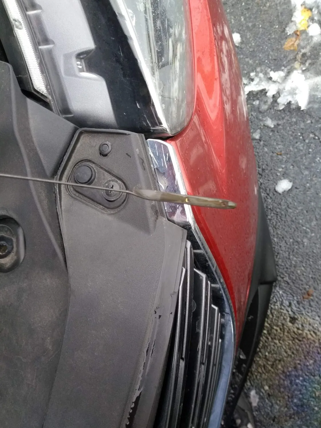

Changed my oil and my oil pan...this is where they put it.

I wonder why therere so many oil over-filled stories by dealers oil change. Is it because they believe customers tend to be happier when they see more oil given by the dealer (the more, the better)?
BTW, have you noticed any oil capacity difference after you received new and revised oil pan?
I wonder why there*re so many oil over-filled stories by dealer*s oil change. Is it because they believe customers tend to be happier when they see more oil given by the dealer (the more, the better)?
They were genuinely surprised when I complained about it, deer in the headlights kind of look, so apparently they don't don't get this complaint. They asked me if it was a hot level or cold level, my reply was that it didn't matter because it was way overfilled. Yes capacity seems to be more as I've commented in other threads. Used to be a tad under 5 quarts would put me at the fill line, now it takes more.
