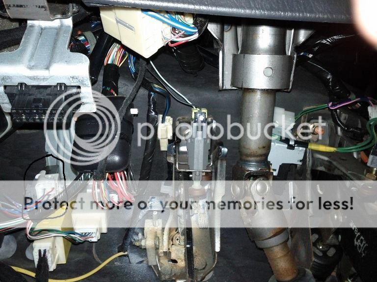

after looking underneath for hours.... i am completely lost... anyone give me an idea where exactly the relay would be?
also i found this connector not connected. any idea? (red circled)
