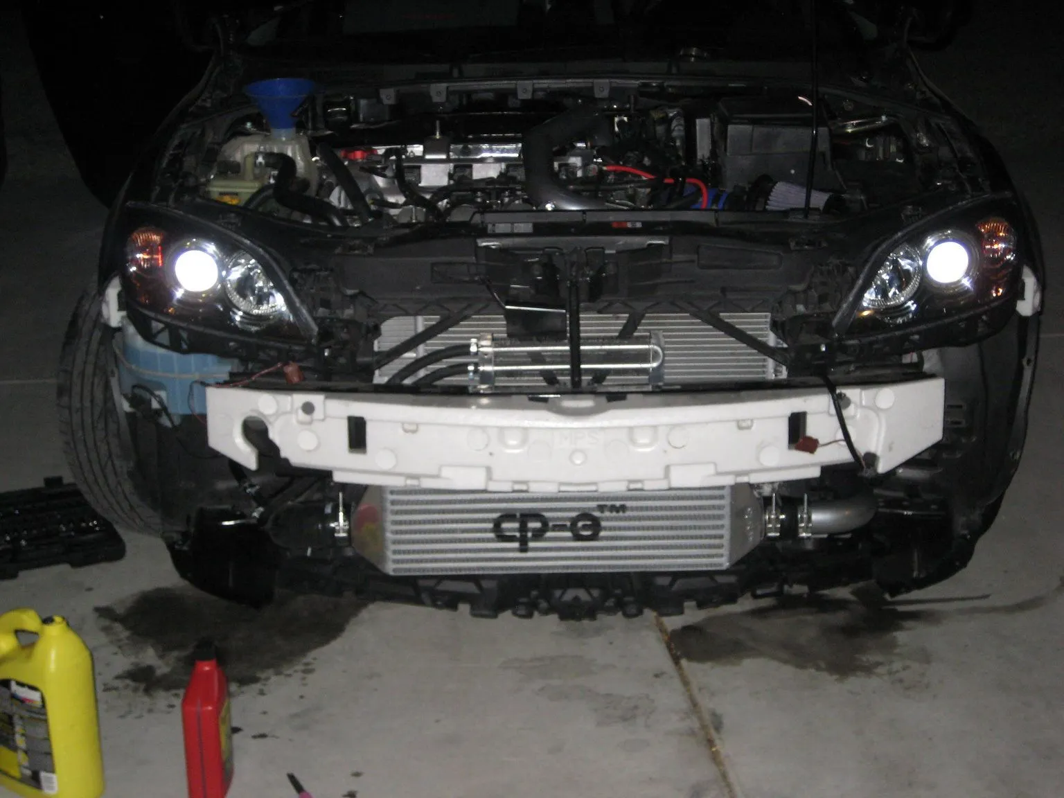

1 gallon radiator fluid
1 bottle power steering fluid
yes u need them....and put down alot of new paper...its gonna get messy!!
look at the drive way
