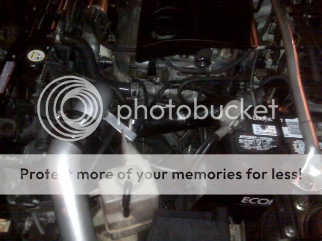

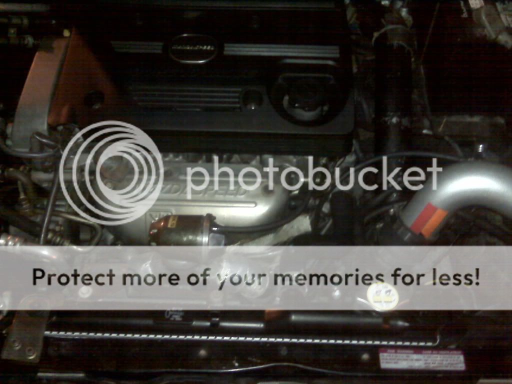

feul cut....help!!!!!!!!!
what the hell!? I never saw a bov on the hot pipe like that. Anyways I also dont see that you are using the stock bpv either so you should relocate the maf to your cold pipe. 6in from the throttle body or so. Theres a couple good threads about it on here, its where I got the info to do mine.
