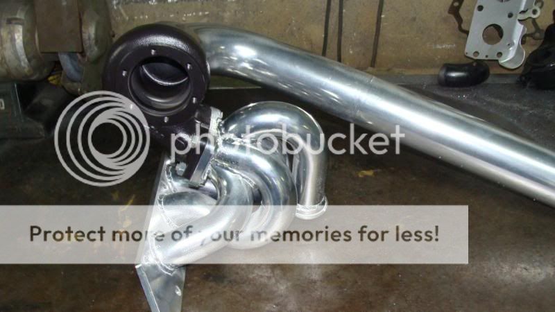

That is exactly why I spent my 2k on a custom manifold and DP so I could run a standard T3 gt35, with Garrett housings and an external wastegate..
