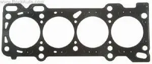

I had a suggestion that the head gasket might be the problem. I always assumed that the water jackets would be closer to the cylinder than the oil channels, but after looking at a head gasket, I'm not sure.
Can anyone tell me what each of the holes in the head gasket are for, or describe how the head oiling system works? I know that there is a main oil source in the middle of the head, but how does the oil return?
