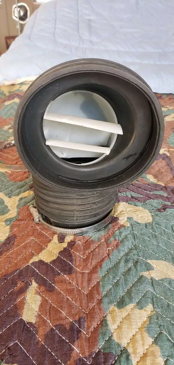

Here is a pic of 5.9 CTD turning vanes normally mounted in the elbow at the turbo air inlet. I picked up a second set of TVs and mounted in the first elbow in the TIP. Cummins/Ram did a nice job designing these TVs.

I'll make a sheet metal, one blade, TV for the Mazda's TIP soon.

A CTD friend built sheet metal TVs for a gas burner and found measurable gains at partial throttle.
Ok. They make sense if there are any sharp bends (close to 90°). The fabrication and installation of them at those points could be tricky.
