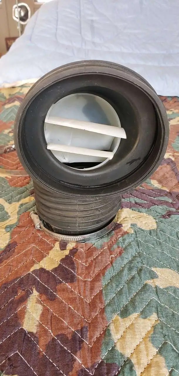

Here is a pic of 5.9 CTD turning vanes normally mounted in the elbow at the turbo air inlet. I picked up a second set of TVs and mounted in the first elbow in the TIP. Cummins/Ram did a nice job designing these TVs.

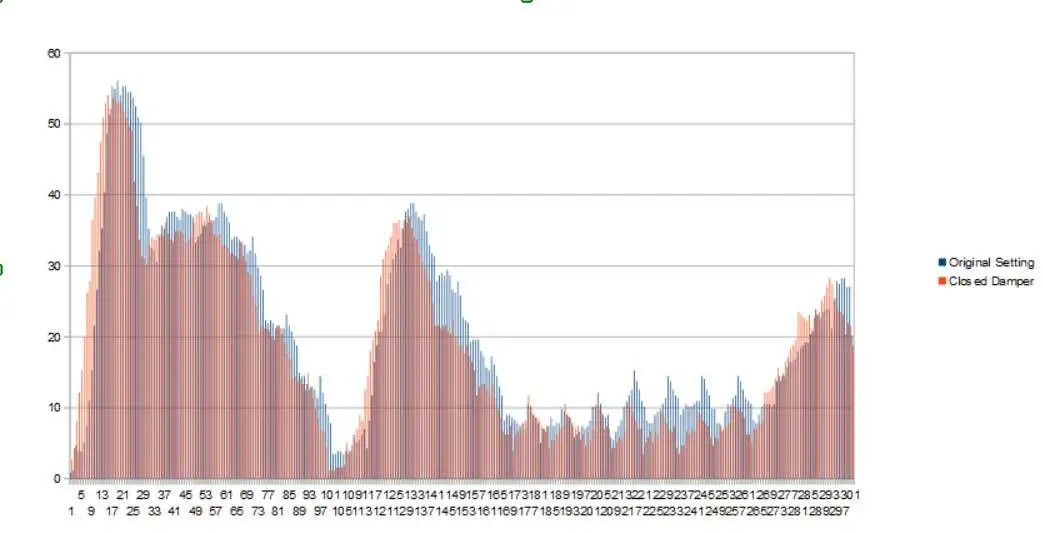

This is a graph of engine load over the same course. LESS engine load means the engine is more FE. We also confirmed the TVs hand calculating fuel mileage. Two other guys I know of did this mod and confirmed their fuel mileage increased. Some noted more low end toque. Honestly I can't feel much difference on a +600 torque at 1600 rpm, 6500 pound vehicle...
I'll make a sheet metal, one blade, TV for the Mazda's TIP soon.

I have a section of interstate I run on CC at 55 MPH. Terrain changes enough to give a decent partial throttle test as you can see. I'm not interested in WOT data on my DD. On my drag race car, yes ONLY WOT. LOL

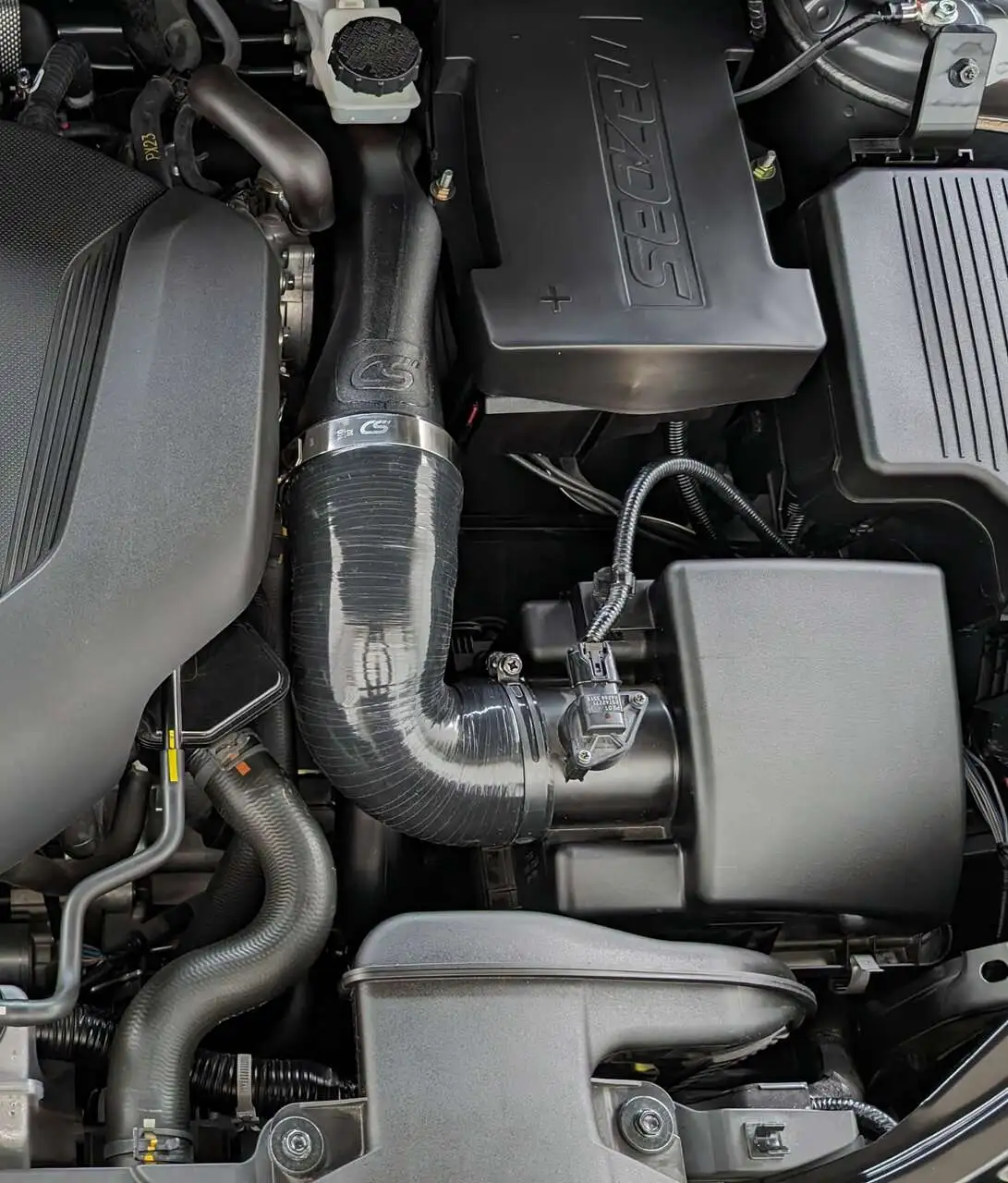

As I installed the new turbo inlet pipe over the weekend I noticed how the bend in the silicone hose could use turning vanes because it is a 90° (or slightly more) turn. However, I'm wary about putting something in there that isn't designed just right to not create a restriction which cancels out the effect.
You are thinking like myself and many of the Cummins Turbo Diesel guys were thinking. We REMOVED the turning vanes that Cummins spent considerable amount of time designing thinking we were improving our FE! It has been proven time and again these TVs improve FE.
I ran my CTD with and without, logging eng load, over my test loop. I found a nice bump in FE. Others have confirmed doing real world tests.

Latter, several of us added TVs in the first 90 in the Cummins TIP. This was a 90 was before a device partitioned into fourths. Again, we had removed this item thinking it was restrictive, NOT. AND we say a nice gain in FE at partial throttle with the added, MORE restrictive TVs.

The outer bend actually isn't that extreme, but the inner one is. Here is mine.

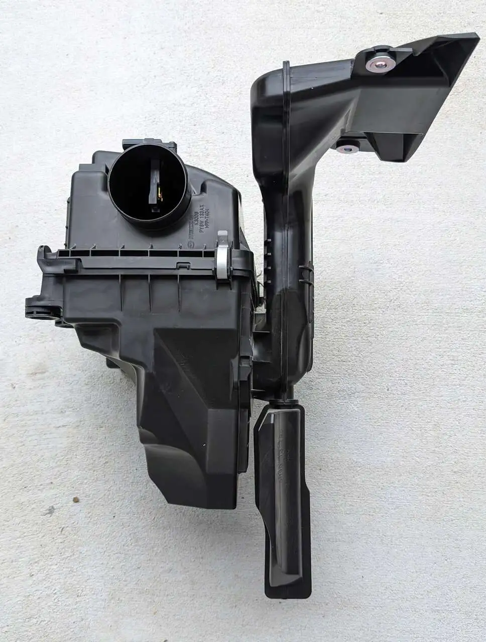

But since creative juices are flowing, the best intake setup would be to skip the air box altogether, and pipe the TIP + MAF straight into the snorkel, with an inline filter. Would take a bit more engineering and modification of the snorkel though.

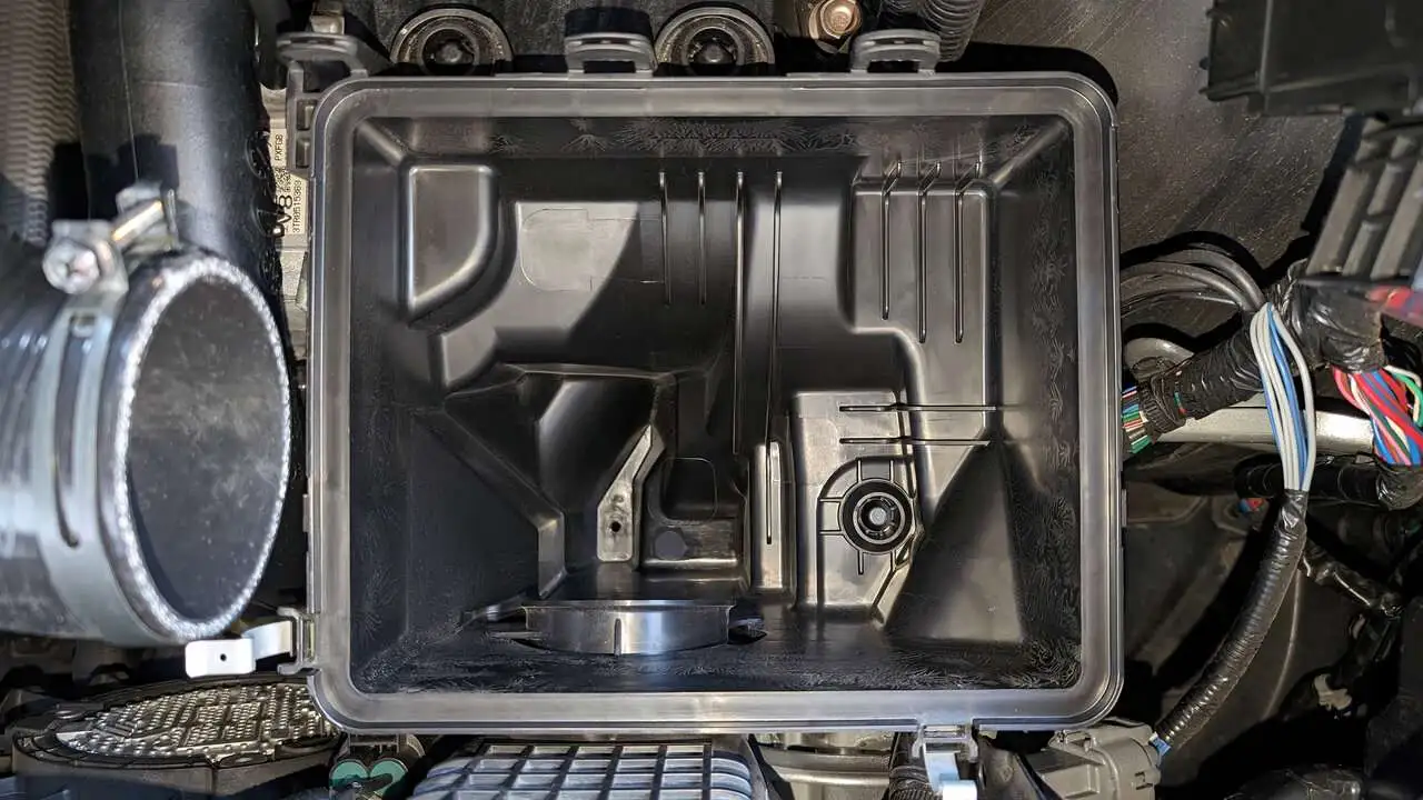

Looking inside the airbox:
It's not the most restrictive thing I've ever seen, but we're still talking about a few bends that could be eliminated. I count after the snorkel 4 times the air needs to change direction, 5 if you include the pipe going to the TIP. Ideally, that would be 0. If you could package a snorkel->filter->MAF->TIP arrangement you could achieve that. The filter would no doubt need to be smaller, and changed more often. Kudus to Mazda and their filter, it is massive and should last a whole 3-year lease period.
This tip hurts my head. And we thought our 5.9 and 6.7 Cummins Tips were restictive. I'm sure Mazda considered other locations for the turbo. Our Cummins turbo are mounted on the exhaust side as well. Being an inline 6, there was room for a straighter shot for the tip.
