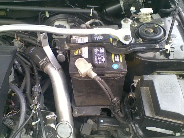

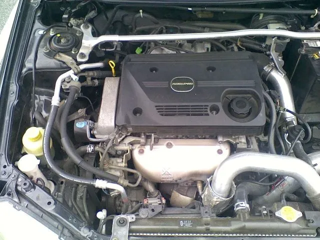

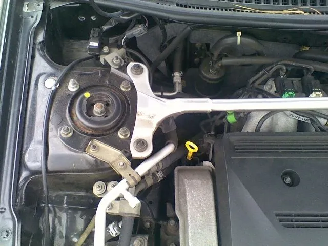

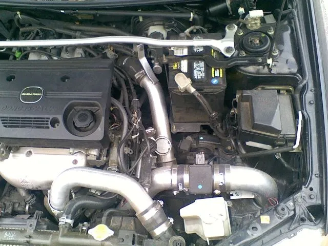

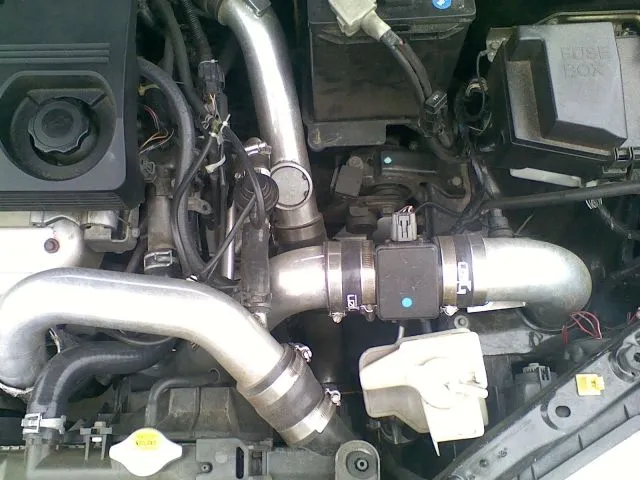

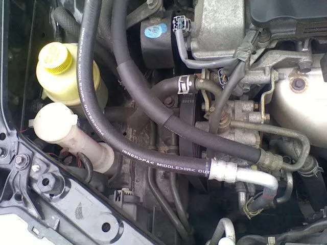

OK...... SO I AM AN IDIOT (sort of)!!!
Alright... so I thought I had a stock MSP because Ive never seen a Stock MSP engine. I thought the enhancements in it were from it being a "Mazdaspeed", but after reading the fourms awhile, I have come to see that i do not have a stock engine.
The only problem now.... i dunno what the heck i have... I took some pics of the engine. Have a look and see what you can see cause I am clueless!

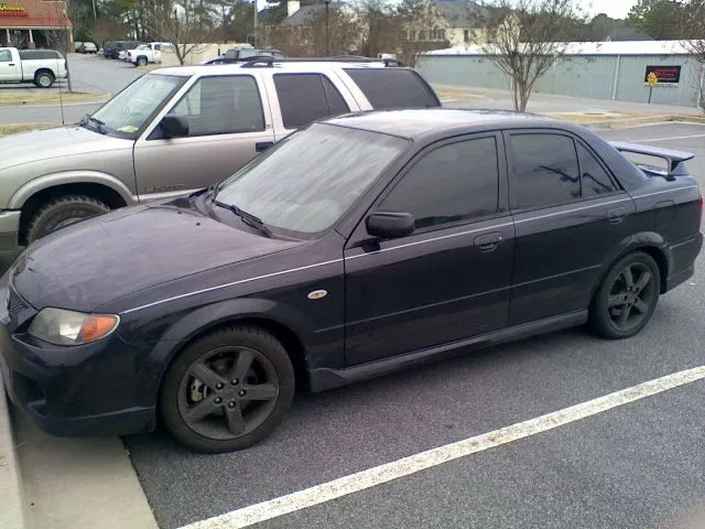

stock motor, stock intercooler with hardpipes, cold pipe has a blocked off BOV flange and is running the stock BPV and of course a CAI. Everything else appears to be stock
Don't know what rims those are, they don't appear to be stock either
would any of this shed any light on the issue im seeing? Rims are Mazda, just painted black... real crappy paint job, on my TODO list
Rims are from an 02.5 or newer protege ES or P5. Slap a bov on the coldpipe, relocate the MAF, add a vacuum block and upgrade to a bigger side mount.
