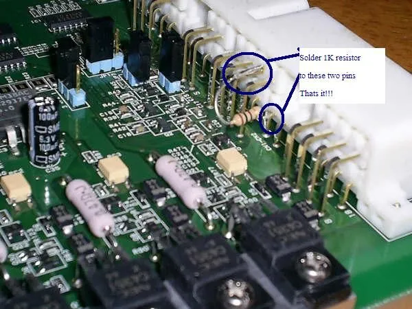

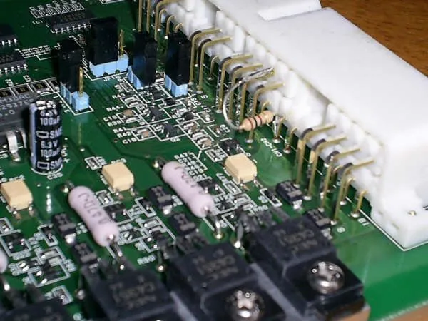

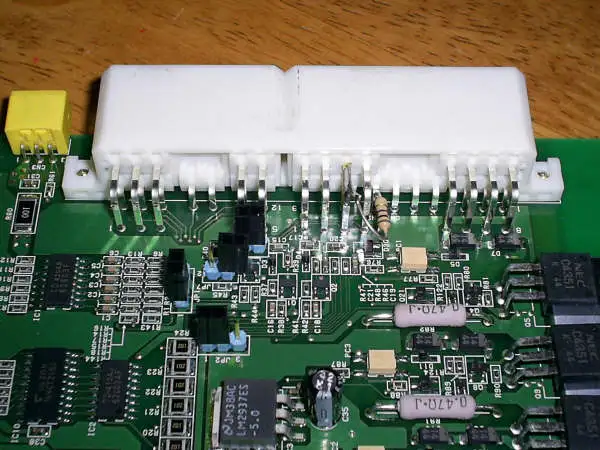

How to add the 1k (Brown-Black-Red-Gold) resistor to the Emanage Blue.

igdrasil said:
what is that for?
This for the MAF resistor. The EM includes a really cheesy box that is not very reliable for adding the resistor to ground. I did this mod last spring and I get PM'd 3x monthly on EM installs. The install is very straight forward, but this eliminates that cheesy green box. Just cut and wire in your MAF wires per directions.
The rest of the wiring directions are the same. (minus the resistor box)
I see....that happens on all piggys when trying to read and modify the MAF signal...at least on Proteges
Greddy includes this resistor in the EM for all of the MAF Mazda's (Ex: 94+ Miata's need this as well)
