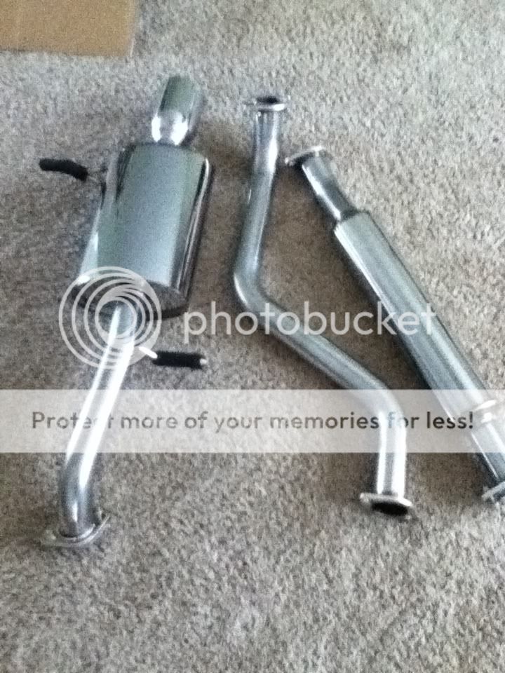

Got it all, stock one was rusted as hell so it took me awhile for me to pull it off. It went together with no problems really and no rattling!!! Agreed with briank or flippyfloppy (whoever said it) that the gaskets are bad but they'll do. Some pics and a few vids coming soon:
Tip sits straighter now, just did a lil adjusting
Overall I'm happy with it, strong welds, good fit, and my twin wants me to see if the guy has one for his '00 focus, so it must sound pretty good lol. Excellent buy for $125, and fast shipping!

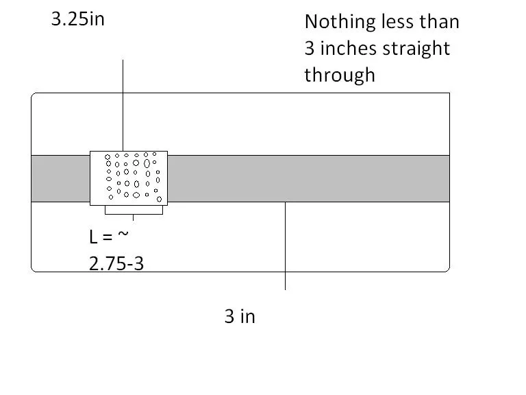

Ok guys, here's my thought about this cat-back. I think it my be too loud for driving in some of the cities I visit, thus getting me pulled over.(five-0) If it's too loud, I was either going to add a small muffler in the piping(if the inner diameter of both muffler and piping where close in size) or replace the rear muffler for a quieter straight through unit. This is what I think the ebay rear muffler might look like inside.
The attached file is a sketch of the inside of a ebay muffler for a Lancer Evo 9 cat-back. People say it's loud outside, but not so loud inside the cabin. Also added a youtube video of the inside of the same muffler.

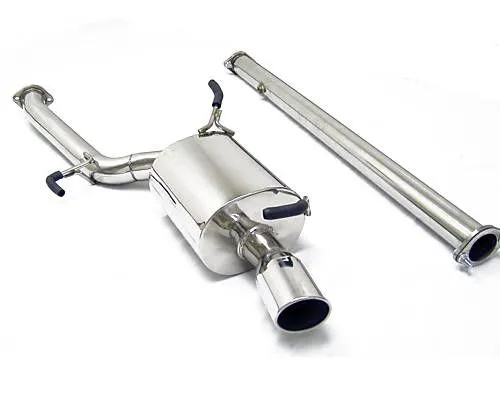

its on the first page
I think he meant he wanted some pics of it installed at different angles, or some more installation pics. And by "custom exhuast runs off magical fairy dust, and little gremlins live in my engine" you mean welded in a hundred different places with "x" amount of transfer pipes to get to the correct size lol... one day we will get that beast runnin top notch lol.
