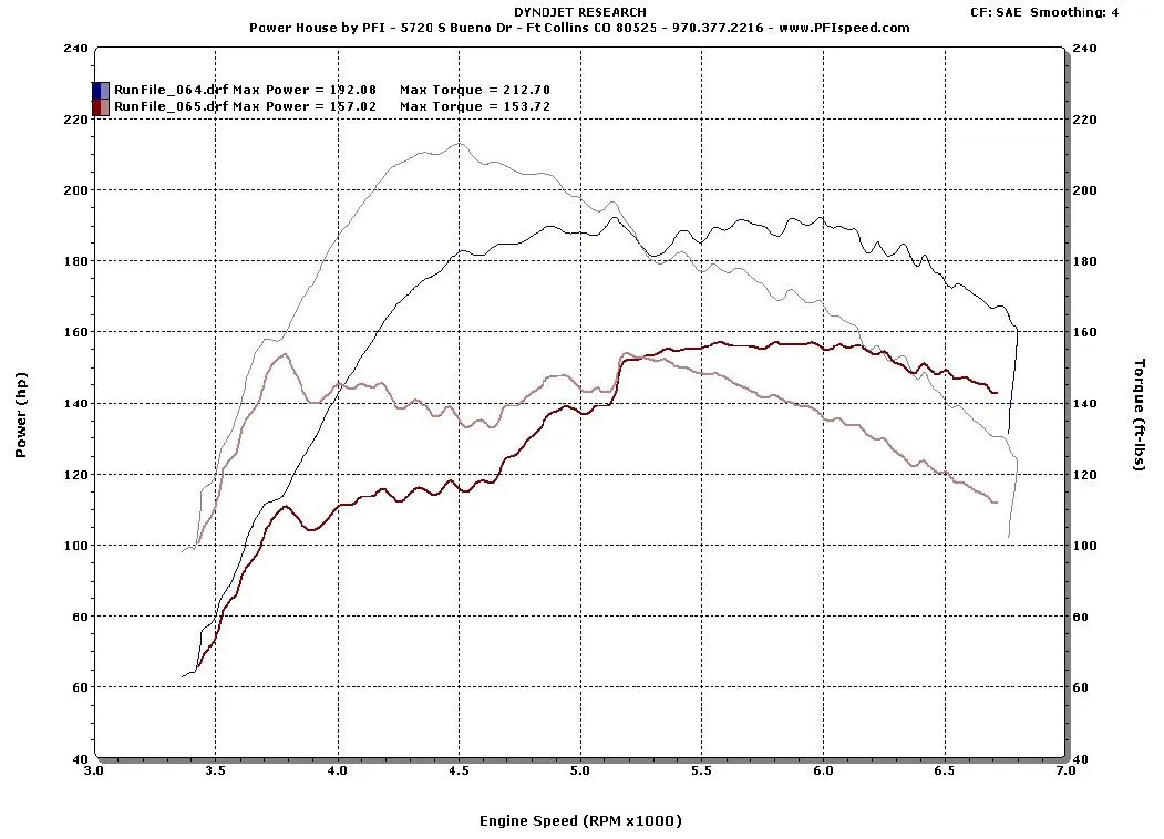

dyno results in
I asked a vendor about the injectors, he indicated it was a positive fit, but I'm not holding him to that statement. But it sounds like they are good to go. I'm going to give them a try when I get to needing them ... but it will be a while...
i need to get re dynoed cause now i have my fuel pump in and my down pipe on but ill post the old one too or you can pm david shea hes a p5 guy and hes stationed up here with me but i dont have a scanner so im not about to go to kinkos and pay to scan a dyno

boo ya speed- that is one of the roughest dynos i've ever seen, get that thing tuned :)
