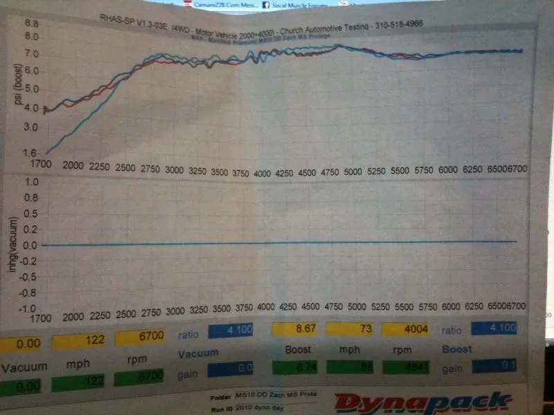

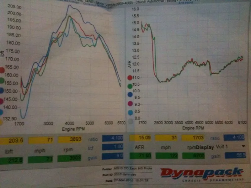

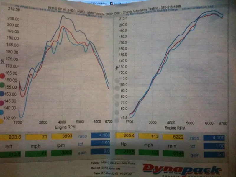

So I finally got a chance to dyno my car yesterday. I just reinstalled a JDM Sam tuned unichip(mail order tuned) last week so wanted to see how it did
mods are injen cai converted to sri, ms3 forge bpv, turbolife fmic, sls catted 2.5 inch midpipe, thermal catback and as mentioned the unichip. boost levels have not been increased but dyno was reading 8.5psi
heres the graphs. as you can see my afr is still pretty rich. a dyno tune is needed or perhaps a difference ems?

Nice. And this is with a stock turbo?
Hehe makes me wanna get a real tune. You just nudged pass my dyno
nevermind I saw it was 8.5psi, its pretty good, but your afr is kinda ustable, the AFR dig at 4500 rpm gives u a significant loss.
