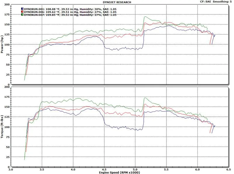

Run 1 is stock Unichip Map baseline, stock boost
Run 6 is custom tune, stock boost - Notice the 30+hp gains in the middle of the power curve, similar results are shown in the torque graph
Run 7 is custom tune, boost at 8.5-9 psi tapering down at higher rpm - with the slight increase of boost, gains up to 50 hp were shown over baseline run

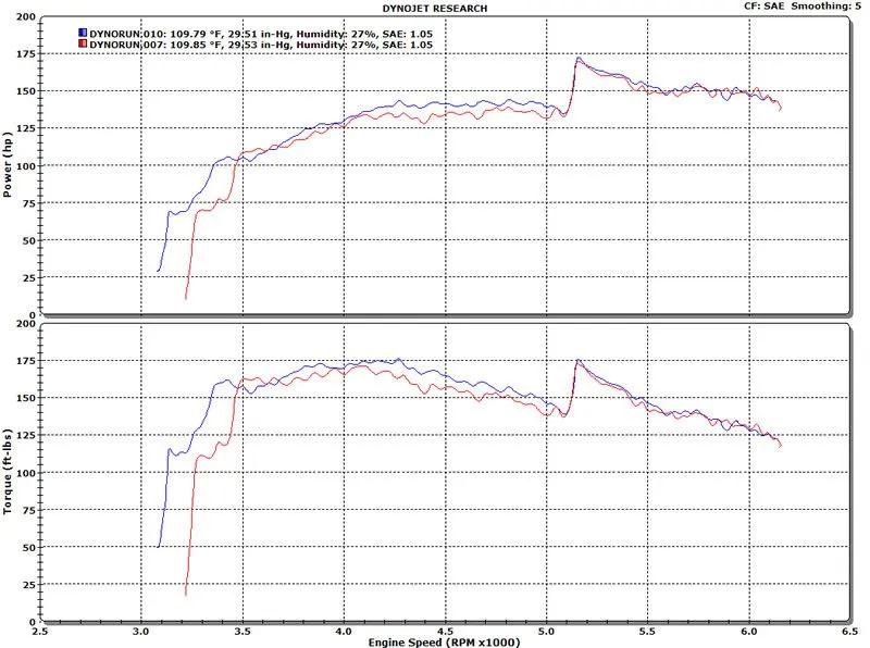

Run 10 verifies new spark plugs did restore lost power from worn out plugs.

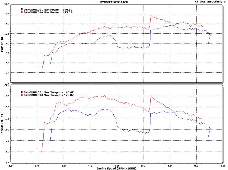

Final comparison. Definitely an improvement, but there is more to be had with even more tuning.

is that bump at 5200 the VICS change-over?
yes. it blows assholes -- we tried like hell to get that outta there, and while it's A LOT bettere than it was, it's still hanging in as you can see.

In my defence of the low numbers: we did 16 pulls in a little over 2 hours, and i got on the dyno immediately after a 4 hour trip; the last 30 minutes spent boosting like crazy cuz i was lost and late (boom06). Everything was done in 4th gear. heat soaks' a b****.
Car feels really strong now though, we advanced the timing a s***-ton but kept the boost down and it feels great. When we tried upping the boost, she had some detonation so we kept it down around 8.5psi after the initial spike. im pretty happy, but feel like i have to go get re-dynoed somewhere when it's a normal temperature, and i can have more than 2-3 minutes cool down between pulls (loser). AFR's were a steady 11-11.3:1 all the way to about 5700rpm where it dipped rich on to redline (conservative tune, there's still more which is good).

oh -- and if you havn't changed your plugs recently, GO DO THAT! cuz damn we added pretty big power with just new plugs, one stage cooler. ZFR7F's ftw.

....and yea, those plugs are the shiet! Glad u like em.....Its ZFR7F-11 for those who read this.

yeah, looks like you need to play around with that... doesn't the unichip take care of fuel and timing? can you hack the VICS with a seperate rpm module, and play around with the changer over? maybe lock closed, do a couple runs, then lock it open and do some more. then, where the open and closed curves intersect, make that the changeover point? just thinking out loud...
our thoughts exactly. We tried locking closed, locking open, running open vent and closed vent. The best setup was the original combo -- one open on ignition, one open at 5200 -- otherwise it would mess with the MAF reading too much and afr's were hay-wire.
Unichip does do fuel and timing. But we could not compensate the change with fuel, it just wasn't very responsive. And on the timing, if we advanced it too much it would detonate. So it's better, but the stock tune (including that switchover) still prevails as with any piggyback. Cuz believe me, we tried!(gun) haha.
