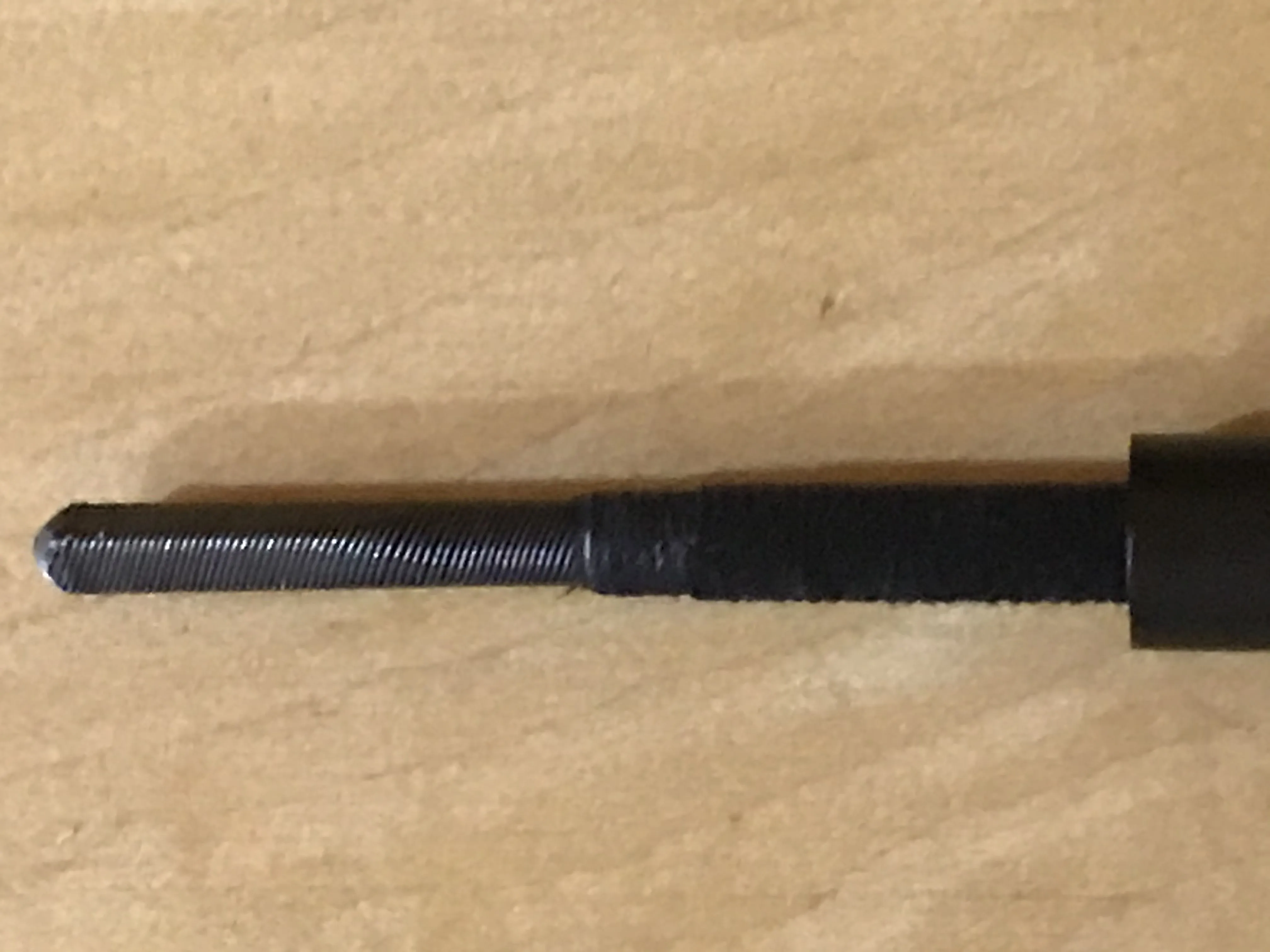

Hey Koz - I did motor side out first to take it out and then when I went to put it in I actually did motor side in first. That isn't really "reversing" the process but I found it easier to install that way. You don't want to get to aggressive bending the cable because you could put a kink in it but you will have to lift the center some in order to get the console side end far enough back to slip the end in - I also needed to use a "recurve" bend to bring that console side end back parallel to the ground for it to slide in place. Good luck with it!
I'm attaching a close up picture of the end of the cable to facilitate understanding of my description of the three component parts of it (hard plastic outer shell, cloth sleeve, closed spring winding).

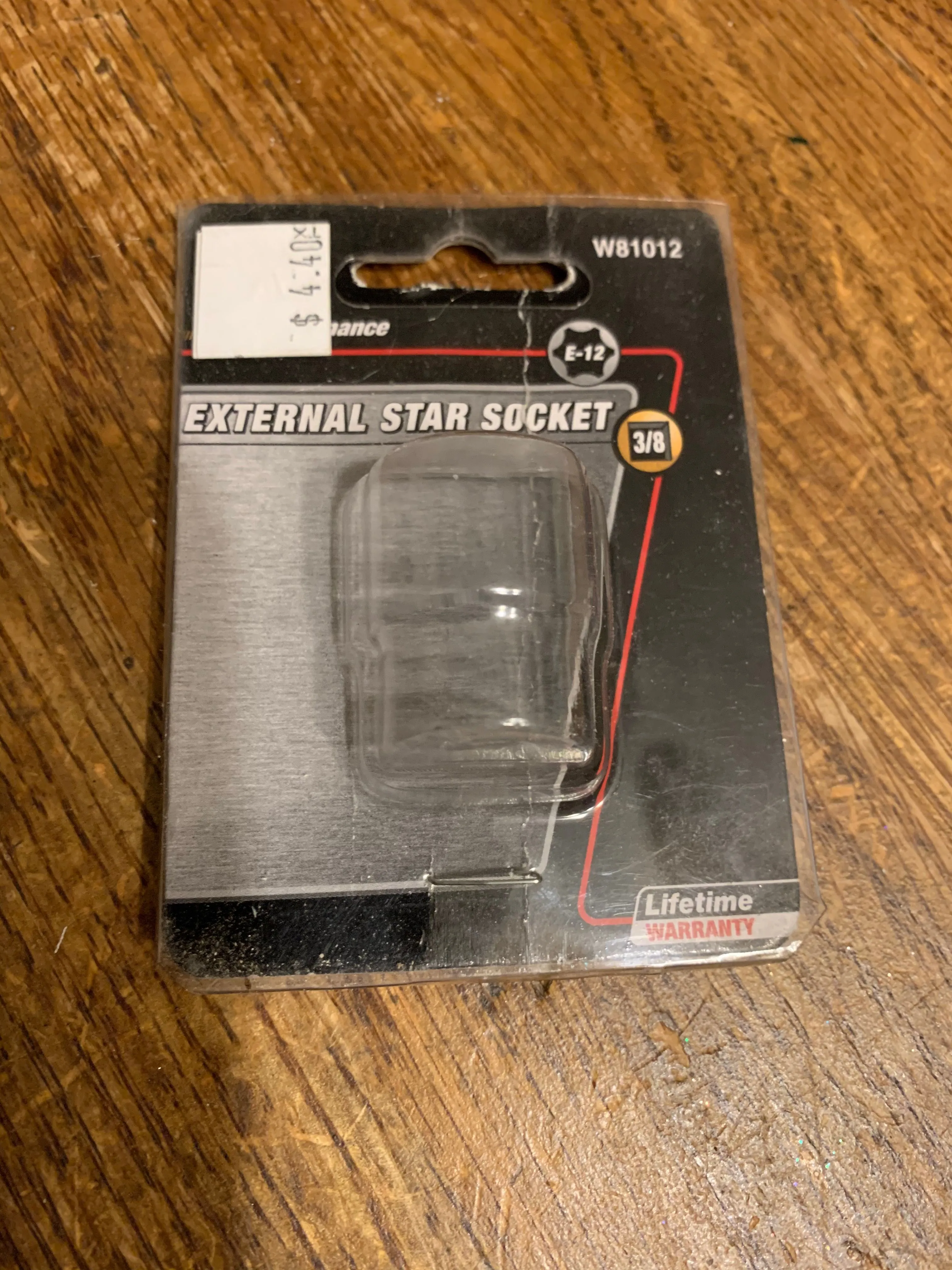

averageJoe - Want to say THANK YOU!!! This CX5 GT is now my daughter's car. I always tell her I will help her fix her car BUT I won't fix it for her. Today we picked up the cable at the local dealership, paid a few bucks more than ordering it online but they had it so we purchased it. Your instructions were excellent. We decided to remove the seat from the car so we could both work on the cable together. Didn't take long before she took control. She had it removed and replaced in about 5 minutes. She even looked at me and said, Is that it? A few more minutes to reinstall the seat and no more noise. Can't believe we lived with this problem for as long as we did with such an easy fix available. The hardest part was finding the 12MM e-Torx socket. Homey had a set for $24 which I almost bought. Local auto parts store said he had no clue what an e-torx socket was but after explaining it to him he called it an E star socket which he had. Posting a picture of the packaging. For under $5 you can't go wrong. Again. thank you!
