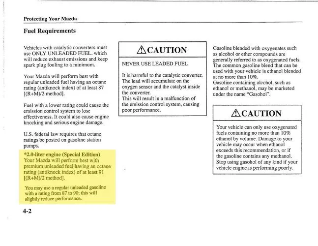

Straight from the manual:
Protege Manual said:
Your Mazda will perform best with premium unleaded fuel having an octane rating (antiknock index) of at least 91 [(R+M)/2 method].
You may use regular unleaded gasoline with a rating from 87 to 90; this will slightly reduce performance.
