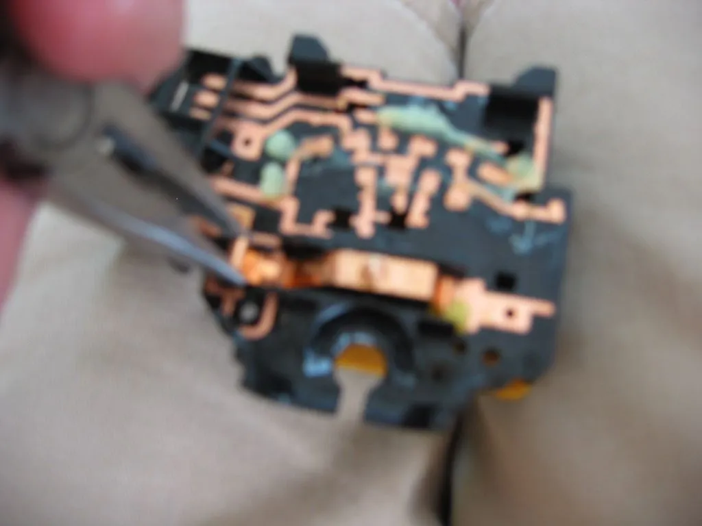

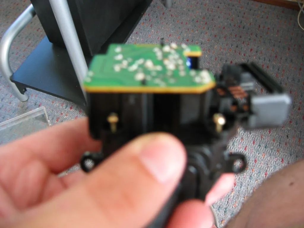

I spent about an hour taking the winshield wiper switch apart, and you can't just disable the wipers and keep the washer motor going. There is a switch inside the assy, and this swich goes to the circuit board and out to pin E to turn the washer motor on. So you can disable just the washer motor and leave the wipers on (but that doesn't help). The only way you could break the signal to the wipers and keep the washer going is to get to the circuit board (which doesn't come out unless you break it). I would suggest disabling both the washer's and wipers on the pull back position (I have attached a picture you just pull that brass piece out), cutting the wire that attaches to pin E of the connector and attaching that to a separate remote switch (single pole double throw momentary) and attaching to the other side of the switch the proper voltage signal to operate the washer. You might need a small amount of electrical know-how to do that, so don't get into it unless you know what you are doing.
jurgs, focus dude focus. Damn digital cameras. The carpet in the background is crisp and clear, but the thing you are taking a pic of is fuzy.
Try laying ti down further away and using the optical zoom on your camersa to zoom in on it to fill the frame.
LOL, just noticed that too. Most digicams don't have manual focus, so you have to use spot metering or macro mode or whatever to get it to work.
Macro would work, but honestly, I find the easiest is to back up away from the thing you are photographing and just optical zoom all the way in, then physically move the camera forward/back until it fills the frame.
I am no photographer, but the results look good. Plus no fish-eye effect.
I know the pics were fuzzy, but I didn't notice until I had already put the switch back on the car. It's easy to do and see if you take it apart yourself, and if you have any questions I will answer them.
