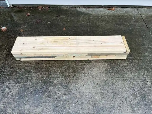

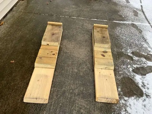

This is true. There's enough clearance under the car to get the job done. Unless you're a really big person that is. I mentioned that I use ramps when I do this work, they're homemade ramps (made with scrap 2x10's) and have three steps. I only put the CX on the first step which is only 1.5" high. This is just enough to make that extra bit of room that makes is easier to maneuver under the car.
When I change oil in my MX I have to put the car on the top step.
Interesting. I've had ramps, but never found a good use for them. I think I got rid of them, not worth fishing out. But I do have a scrap piece of 2x10, and I'm due for an oil change in the next few weeks.
Perhaps I'll just drive up on one thickness on the passenger front tire and see if its more comfortable that way.

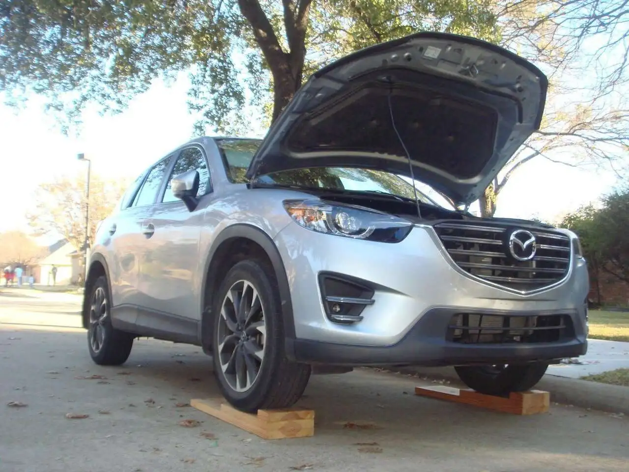

Many people say they don’t need to raise the CX-5 for the oil change. I tried it the first time when I changed the oil on the CX-5, I almost had to scratch my face to reach the oil change panel which is so deep. I couldn’t even turn my head underneath there. Don’t want to do that any more so I alway borrow a pair of self-made wood ramps from Conrad 16.5 each time I change the oil on my CX-5. 😙
Close, very close! Except that I have three steps.
