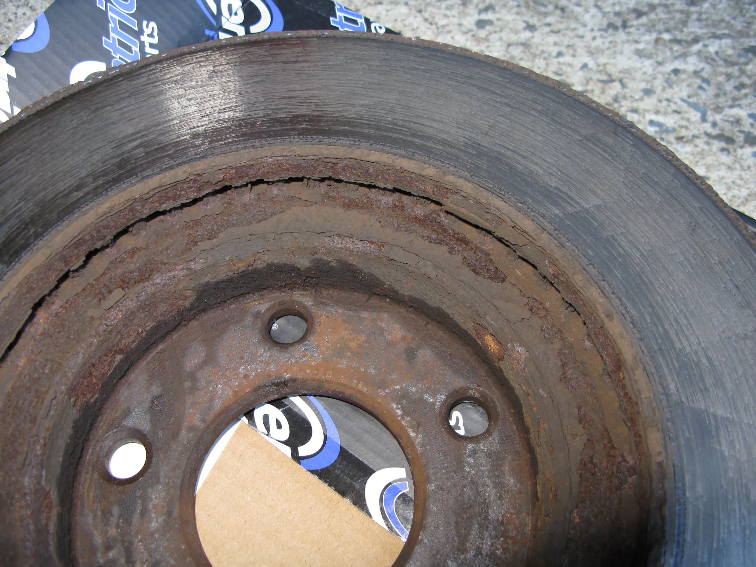

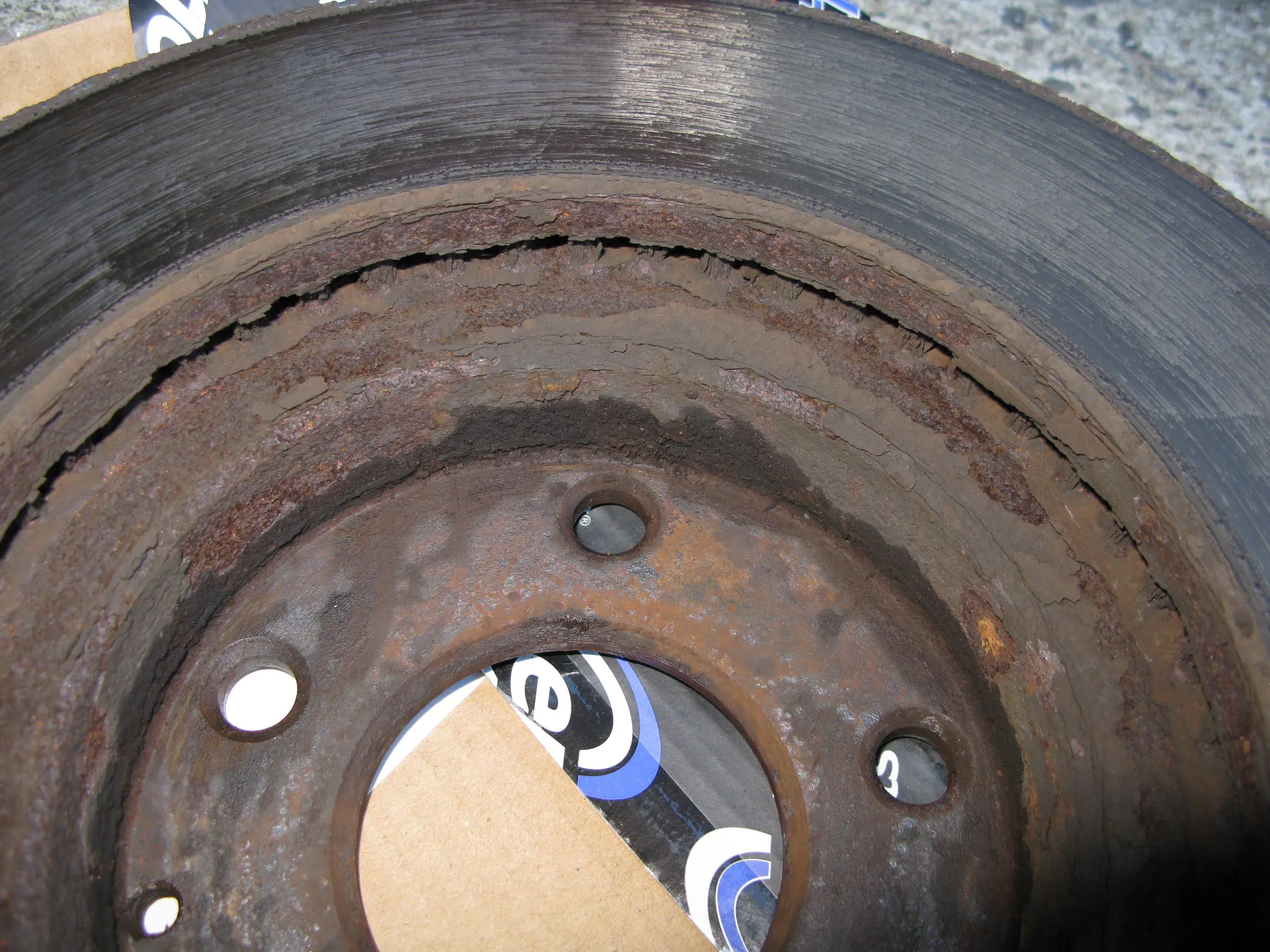

No surprise there considering the car is harder on rear brakes than the front ones like the numerous amount of post here suggest...not opposed to better rotors, even with better venting, but this example isnt a very good one...
My original rotors were rusted to hell after 60k miles.
attachment.php
attachment.php
