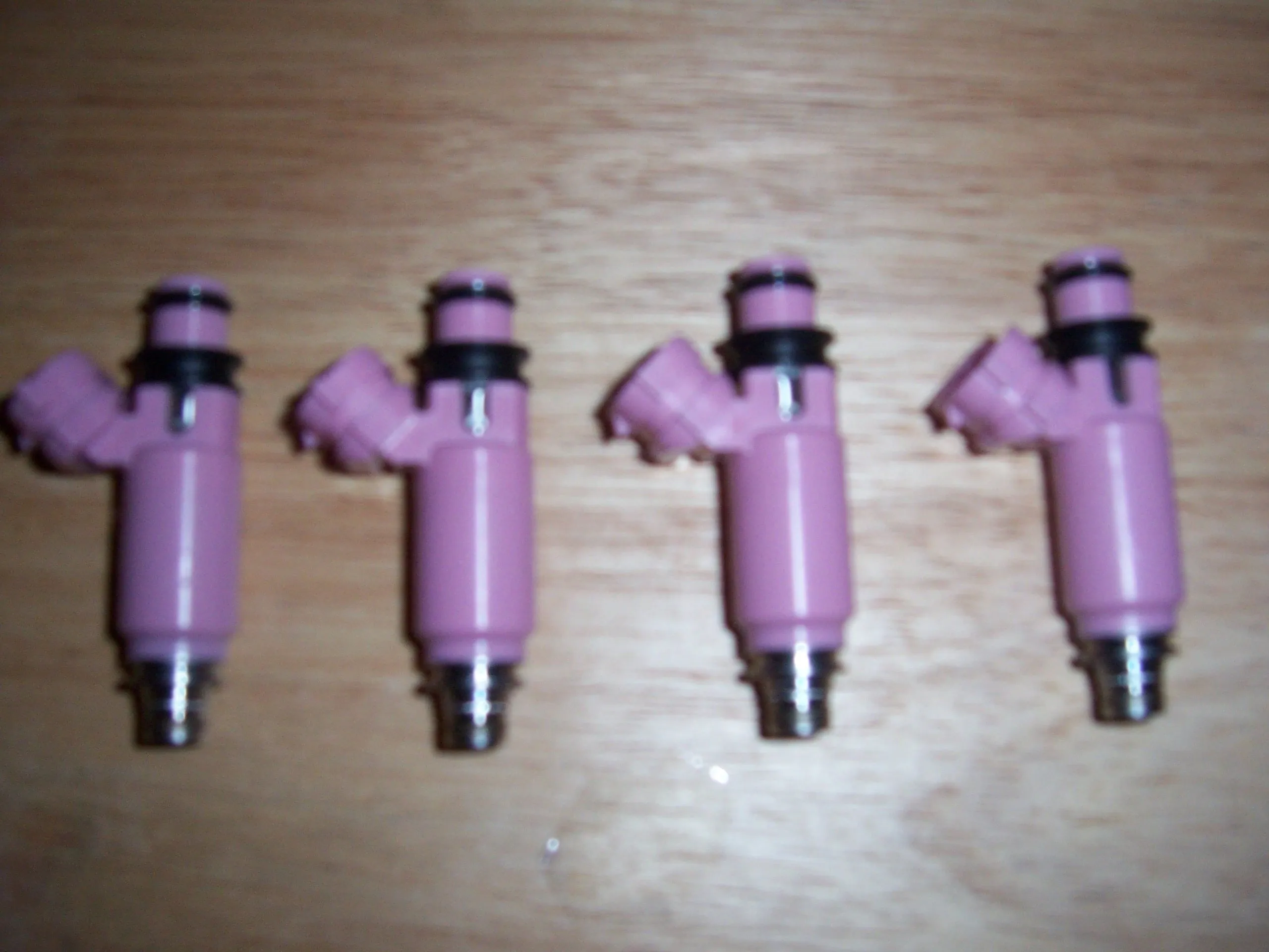

Anyone know where I can get bigger injectors bigger than 440cc that are plug n' play? RC Engineering maybe?

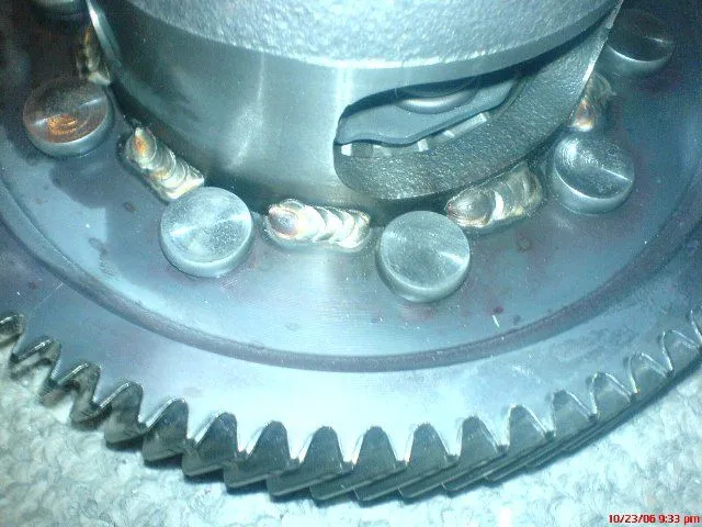

Yeah, I know I should probably weld the diff while the motor is out. Does any one have pics of where the placement of the welds needs to be? I know I could probably search and find it if not.

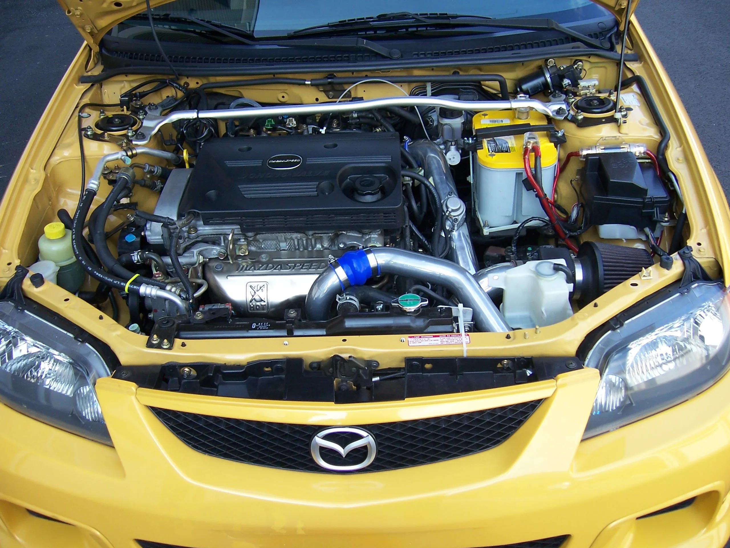

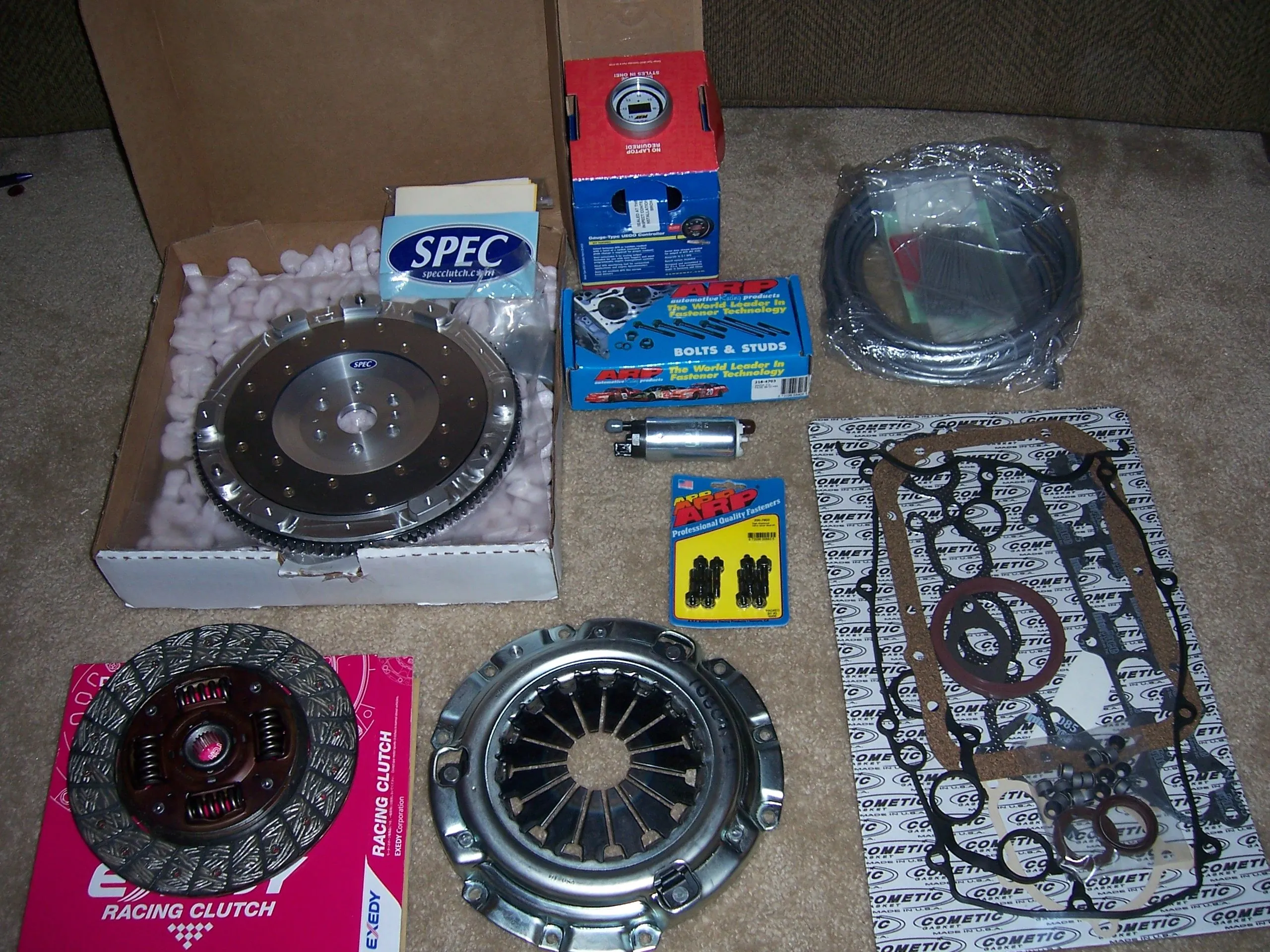

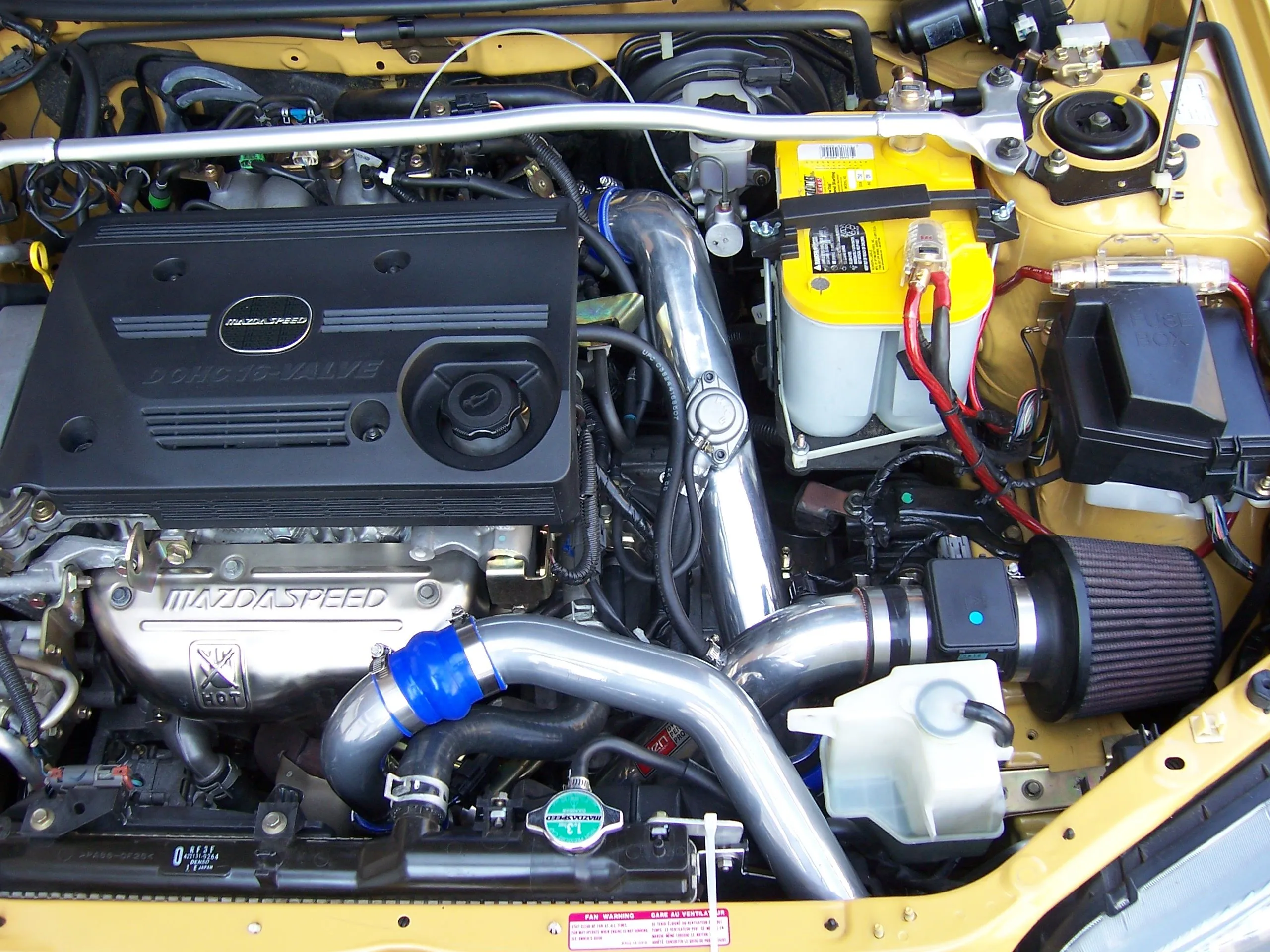

Here are some pics to start with. The block and some of the other stuff is at the shop. I'll take pics after Christmas. The pics of the car are a few months old. The intake/airfilter heatshield was not in yet. It basically just blocks off the corner where the air filter is from the rest of the engine bay. Also I have a yellow DGM grille on the car now that I got from Jeff@Tri-Point.

Attatched is a welded LSD, courtesy of CrazyCaker.

If you're thinking of bigger injectors you might look at the Sti "pinks" from the j-spec WRX Sti. They are the ones installed on the motor I got from Fountain Motorsports, and they ran around 11 psi from a modified GT25. IIRC, they are 565 cc/min. Not sure if they drop in or not b/c I don't think the fuel rail on my motor is stock. There's info on them around here somewhere.
the JDM STi Pinks are the same size as the blue WRX 440's so they will drop in. 565cc sounds right. Must be the JDM top feed though.
