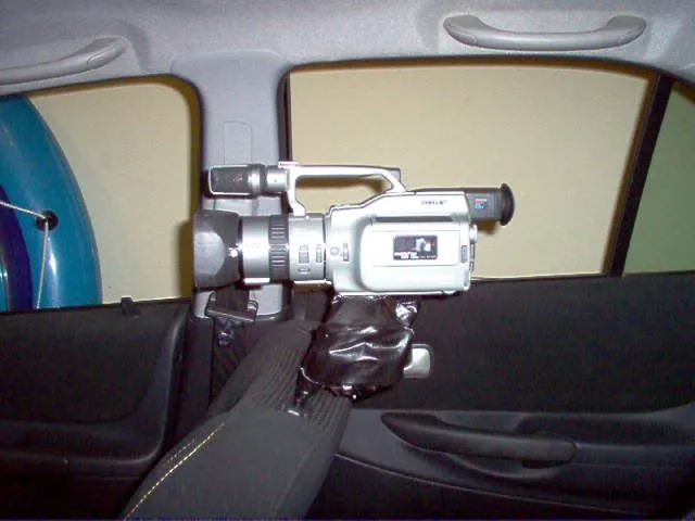

I made mine. I just went to a junk yard found an old head rest. Took all the stuff off it (foam and all that) Then got the top of a tripod(where the camera screws on) and glued it to top of the old head rest. After some tape and putting some cloth on it...it was done. So to use it i just take out my complete head rest and put in the one i made. Works pretty good, to be FREE

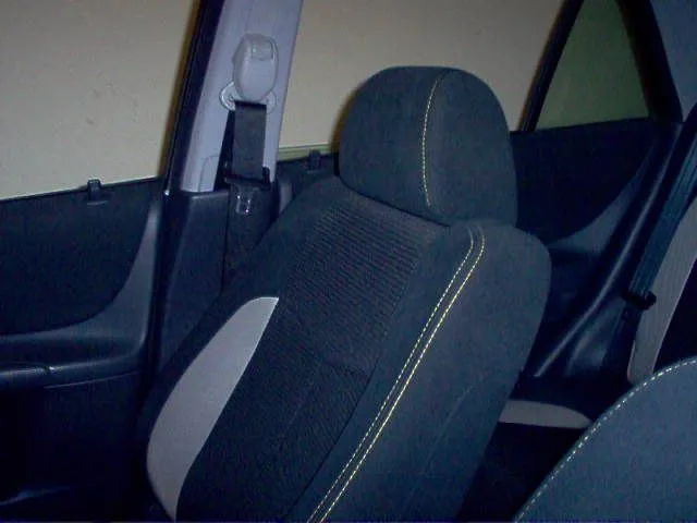

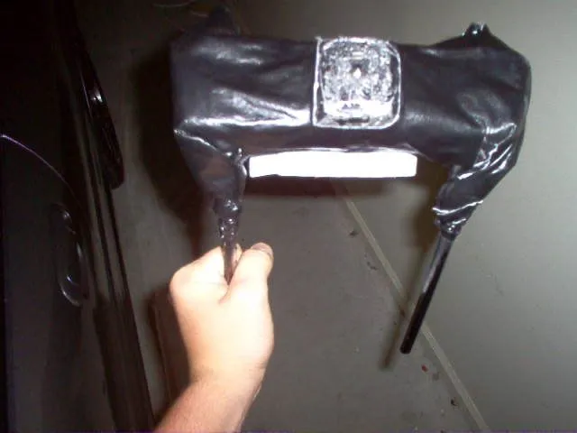

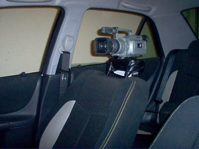

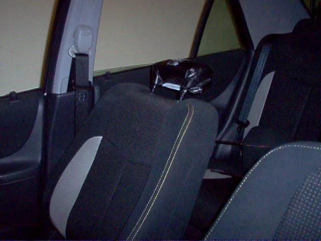

I used a spare piece of wood. 1/2" x 1" x 14" I drilled 2 holes for the headrest posts and one for the piece that comes on top of a tri-pod. I'll try to get pictures of it.
Okay here are the pics. I have to admit the mount is very GHETTP but it was free and made in about 30 mins. The pictures are pretty self explanitory on how it works. hopefully lol
