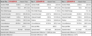

I'm thinking of going for 225/45/18 or 225/40/18 tires on the stock wheels.
There are definitely more options in these tire sizes than our stock 215/45/18 size.
Seems like the extra 10mm width won't be a problem on our stock wheels and the overall diameter of these 2 tire sizes is pretty close to the stock tire.
I've attached a comparison.
What do you guys think?
Here's the math:
STOCK
215mm x .45 x 2 (sidewalls) / 25.4 (mm-inch conversion) + 18" = 25.62" tall
OPTIONS
225mm x .40 x 2 / 25.4 + 18" = 25.09"
225mm x .45 x 2 / 25.4 + 18" = 25.97"
For all intents and purposes, I'd go either way, but if you want your car to retain value longer (by showing less miles then you actually cover), go with the 225/45-18's.
