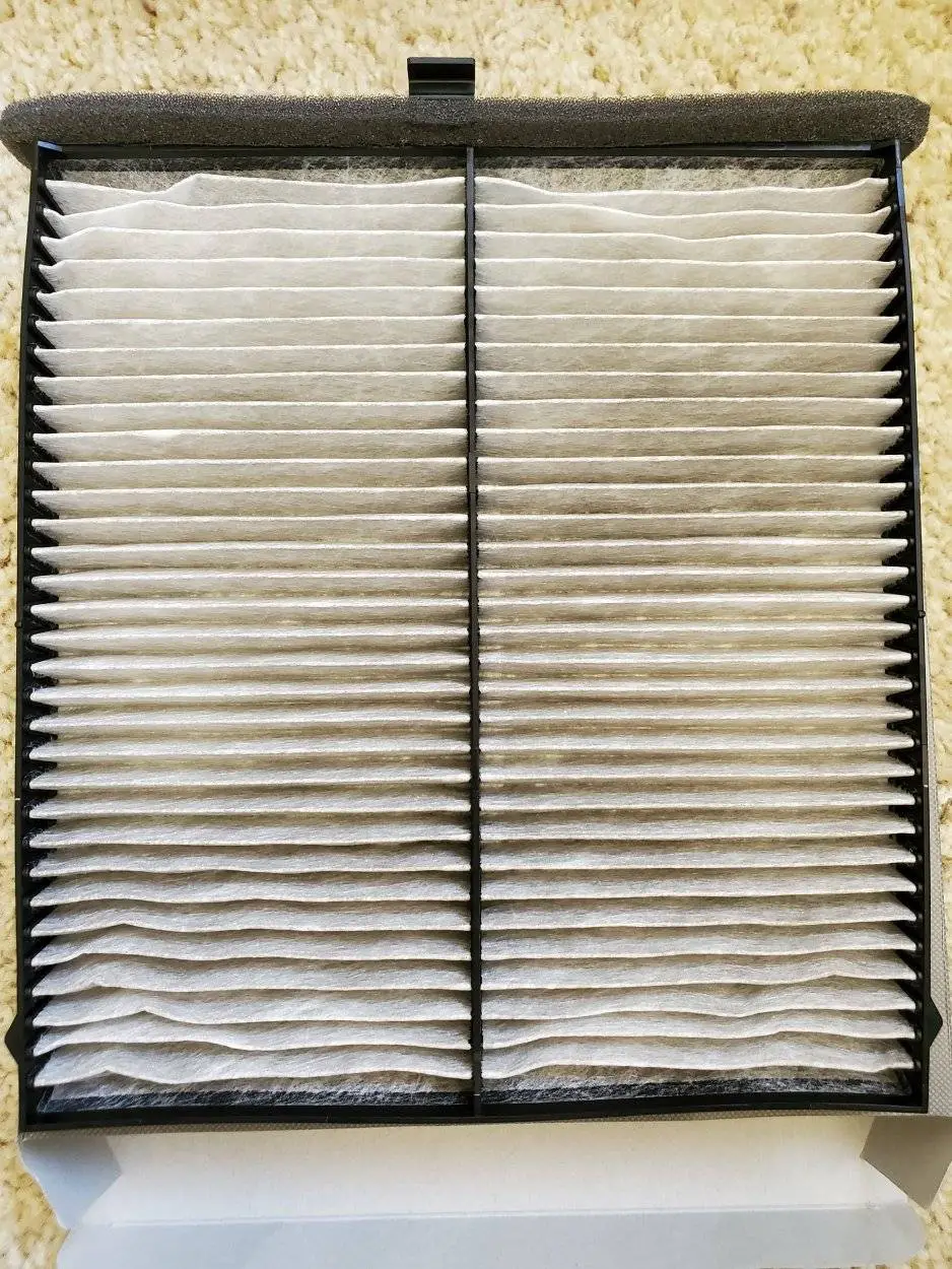

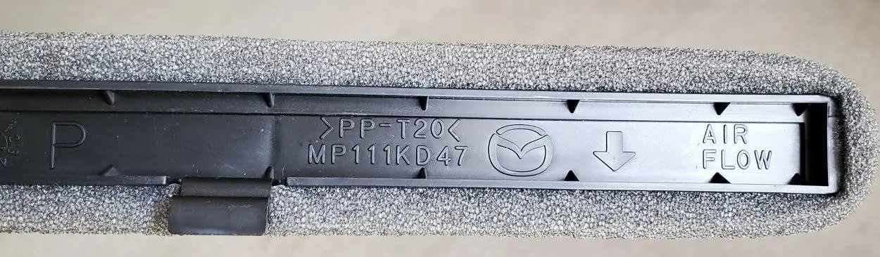

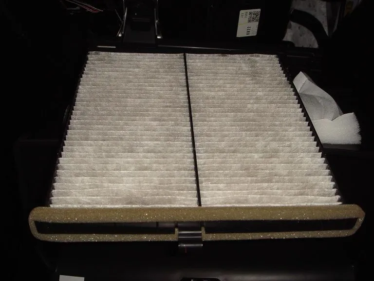

Original that comes with the car from factory. Not sold by dealers.
It had been discussed that is has small amount of charcoal in it and has darker look even as new.

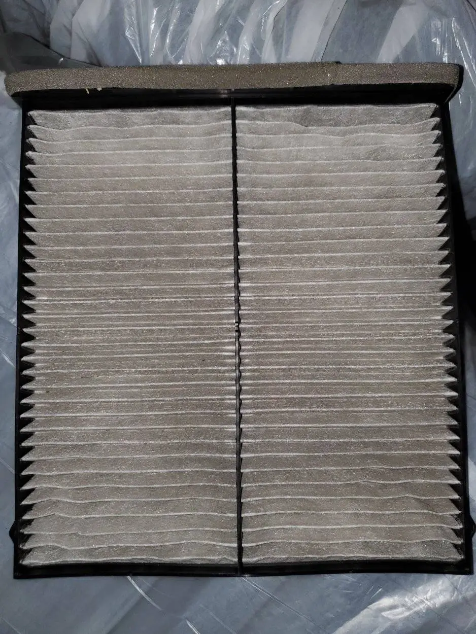

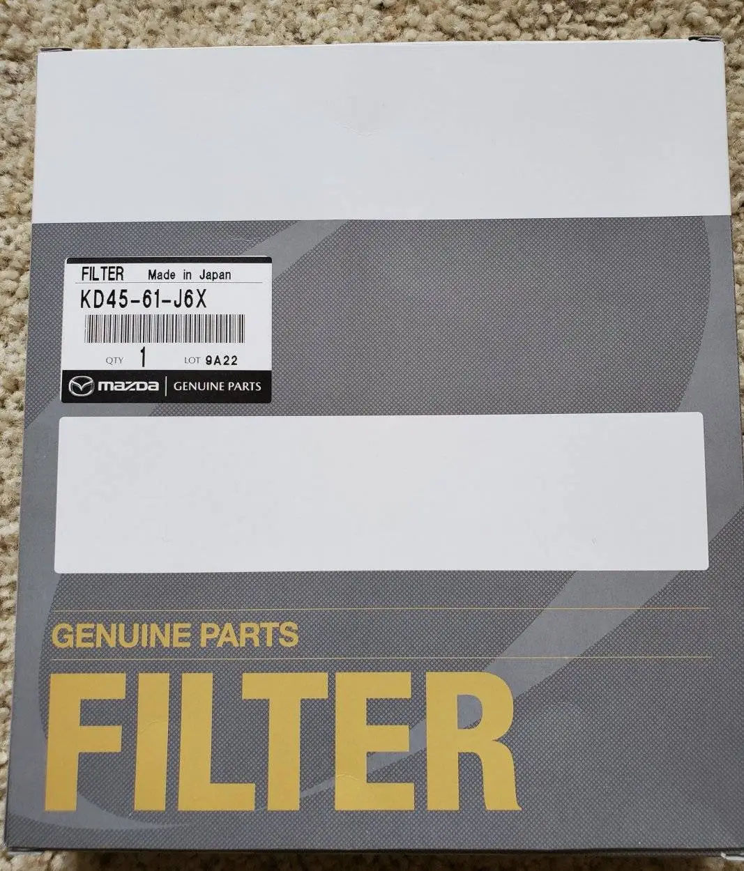

Oem made in Japan. Part no kd-45-61-j6x. Sold by dealers but recently superceeded by new part number kd-45-61-9u. Don't have details yet what is changed or new in the new part no.
Sorry but the pics are from my used one, it’s a bit dirty (used).

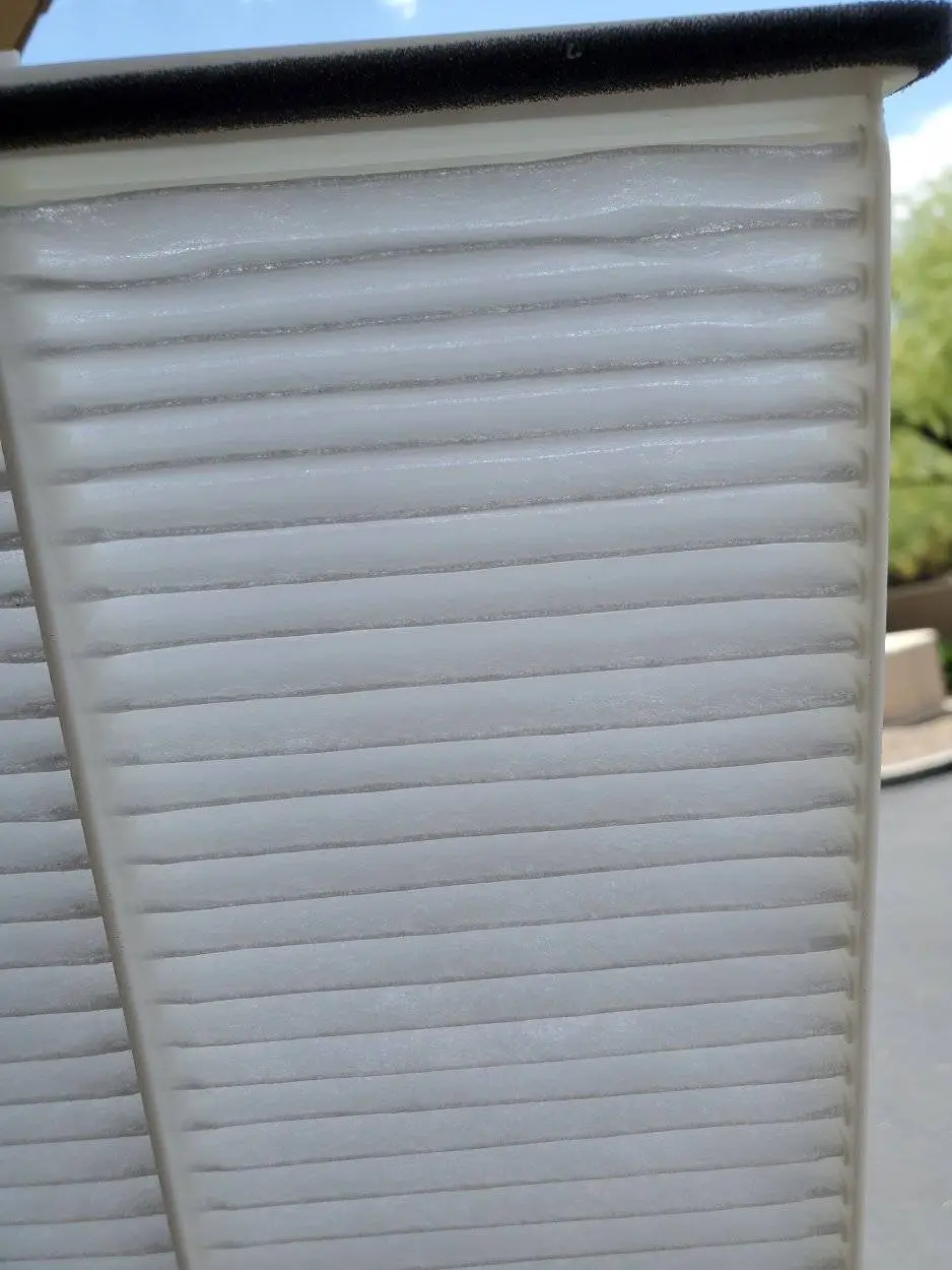

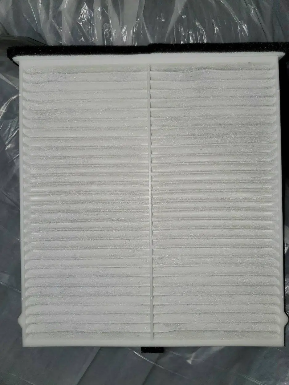

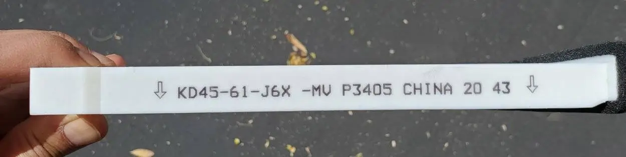

Value line. Made in China.
Part no kd-45-61-j6x- VM

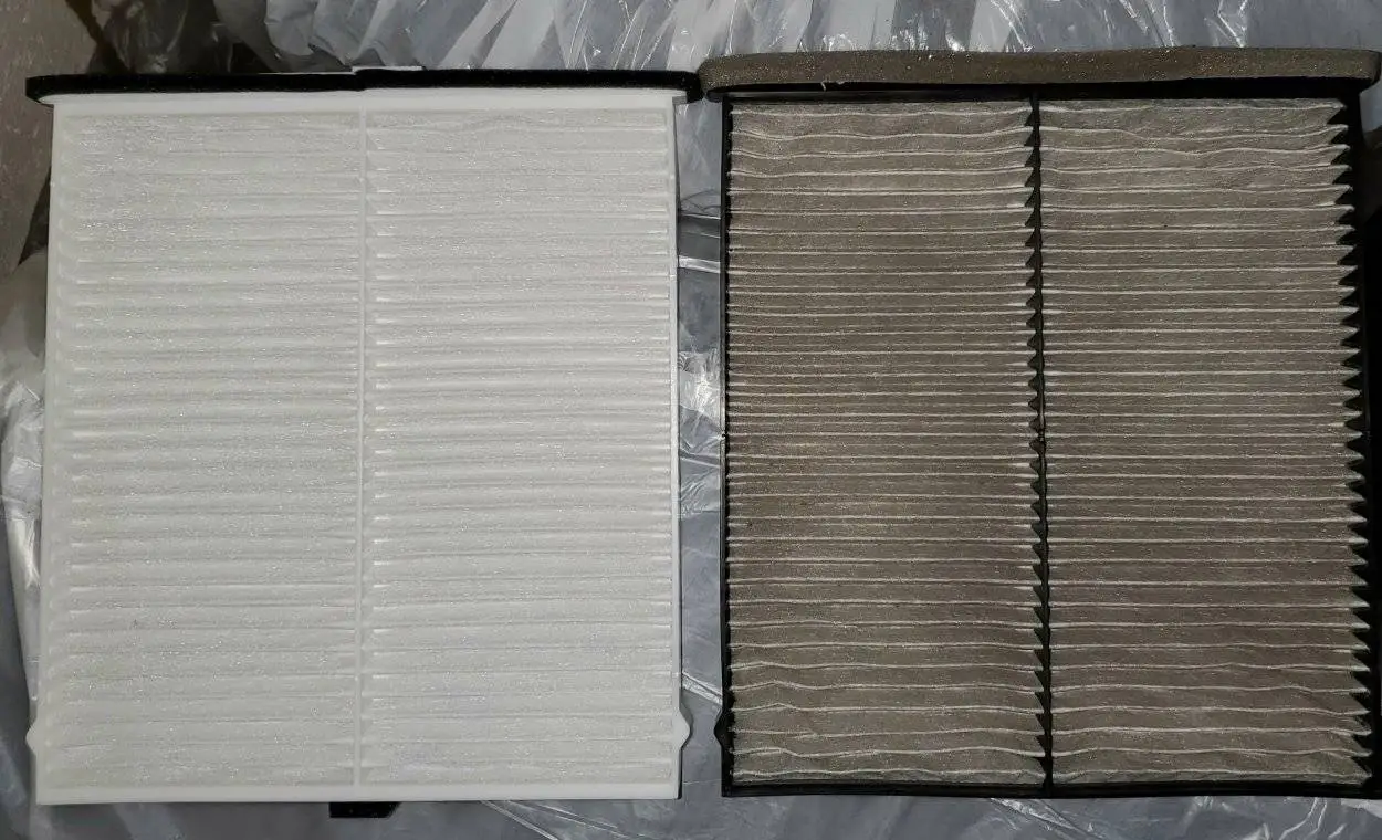

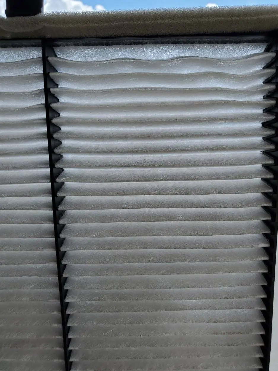

Made in Japan (on the right) vs made in China one. Side to side pic.
Again sorry, the Japan one is used and that is why it’s dark.
On a side note, the Japan one seems to have a bit more surface area counting it to 32 vs 29 for the 'value line' one and the value one kind of seems just a bit more dense vs the Japan one.

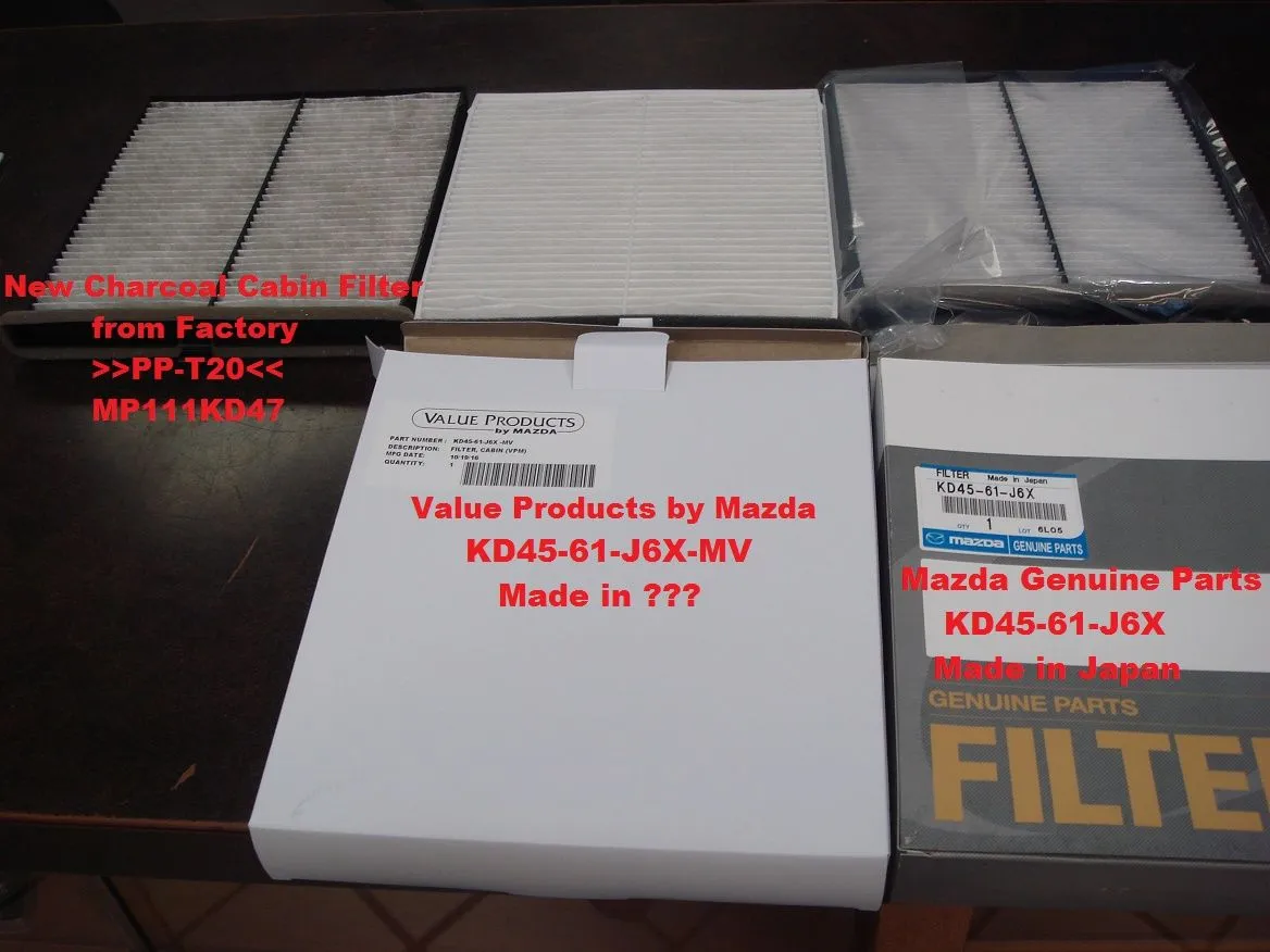

Went to my Mazda dealer and pulled the cabin filter out from a brand new 2016.5 CX-5 Touring in the showroom. The cabin filter from factory is indeed a charcoal filter as I suspected. This means my 17,315-mile cabin filter is not as dirty as I thought! Many people may actually throw away a perfectly fine charcoal cabin filter too early as it looks black and dirty comparing to the white "genuine" charcoal-free cabin filter from Mazda dealers.

Mazda Cabin Filter Comparison

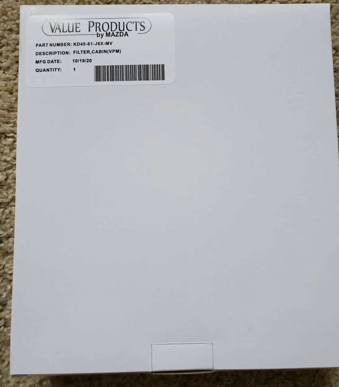

Went to Mazda dealer yesterday and took more pictures on 2016.5 CX-5's new charcoal cabin filter from factory, Mazda genuine non-charcoal cabin filter with P/N KD45-61-J6X, and Mazda Value Products non-charcoal cabin filter with P/N KD45-61-J6X-MV. From the comparison picture below we can see the picture you posted earlier is Value Products with white plastic frame instead of black. Value Products cabin filter is about $10 cheaper than Mazda Genuine Parts on list price.
attachment.php

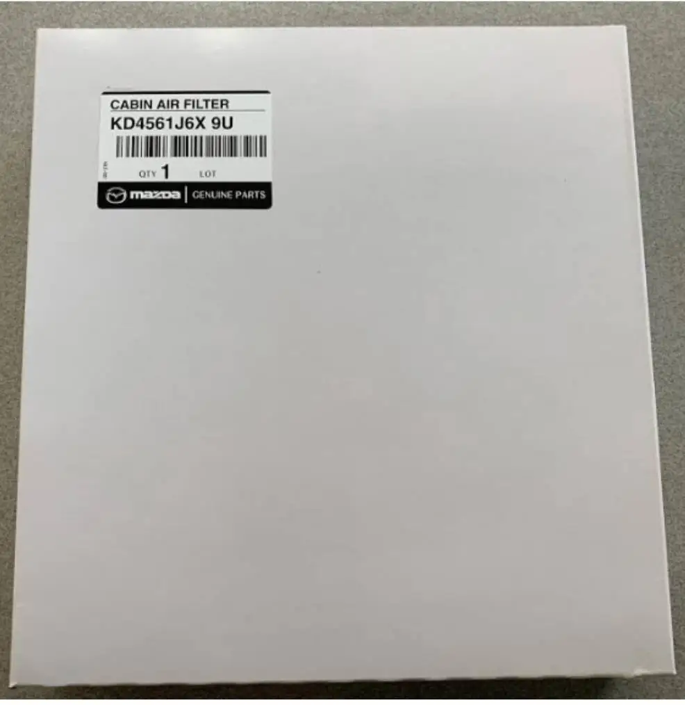

BTW, there seems to be a Mazda genuine non-charcoal cabin air filter with different (newer) part number KD45-61-J6X-9U which superseded KD45-61-J6X mentioned above. The packaging is different and it looks like a Value Products white paper box. It doesn’t say where is it made, and the previous KD45-61-J6X non-Value-Products cabin filter is made in Japan.
interesting, the japan one is a bit darker vs the Value line seeing your pictures. Unless its used one on the picture or the plastic package darkens it. :)
May be it has some charcoal after all although not as much as the oem that comes with the car.

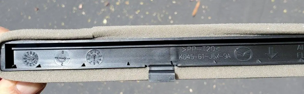

Also I now noticed that the japan one actually has -9A on the part number at the end. ie kd-45-61-j6x-9a.
Its on the filter itself not the box.

Unlike those from factory, the filtering element of Japanese KD45-61-J6X cabin filter is white without any charcoal. The plastic bag does darken the Japanese filter a bit in the picture.
Curiosity got the best of me and after checking the box of a spare filter, it shows replacing " OEM No. KD45-61-J6X-MV " (doesn't mention Mazda though) in addition to Fram,Pennzoil,Purolator , etc numbers. I haven't checked the price of the Mazda MV filter but I wouldn't pay too much for it.

KD45-61-J6X (new number KD45-61-J6X-9U) - $30.77
KD45-61-J6X-VM (value line) - $21.58
