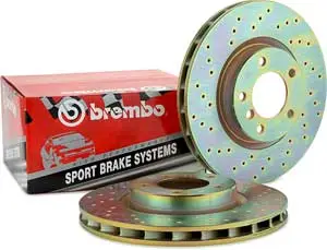

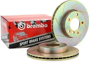

sorry dude heres some pics. back to your thread
