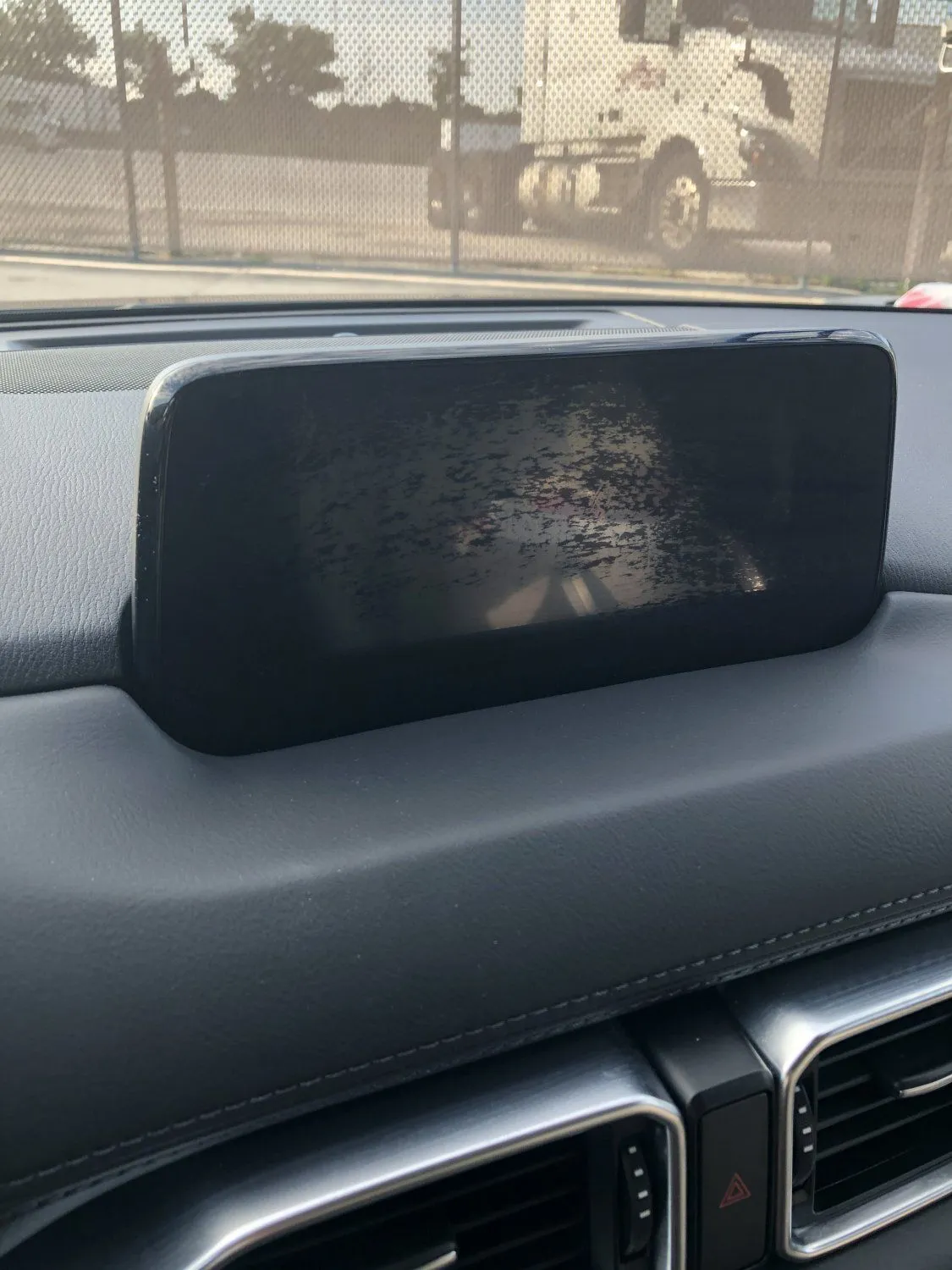

Hi! So I’ve literally been looking all over for some solution to my problem. I have a 2018 CX - 5, Touring Trim. I had my car detailed on Sunday, and by Wednesday I noticed my screen looked foggy/cloudy. I wiped it off with a wipe that’s supposedly good for navigation systems and it did nothing to clear the screen. Then I noticed it appears as if the screen was peeling or damaged. I believe the protective coating/anti-glare stuff is coming off. Can this be fixed and about how much would it cost or is this damaged beyond repair? I do have warranty left, but I’m not sure if this is included. View attachment 226151
UPDATE - My warranty covered a brand new screen. Took about an hour to install.
Hi , May I ask under which warranty was it covered? I’m having the same issue in my 2019 cx5 . What was the process you went through with the dealer ?
Hi! I just called my local Mazda dealership and once I got there they checked out my screen and ordered a new one once they saw I still had warranty. You have a 2019 so you should still have car warranty unless you went over the mileage or something. The whole process took like 5 minutes literally.

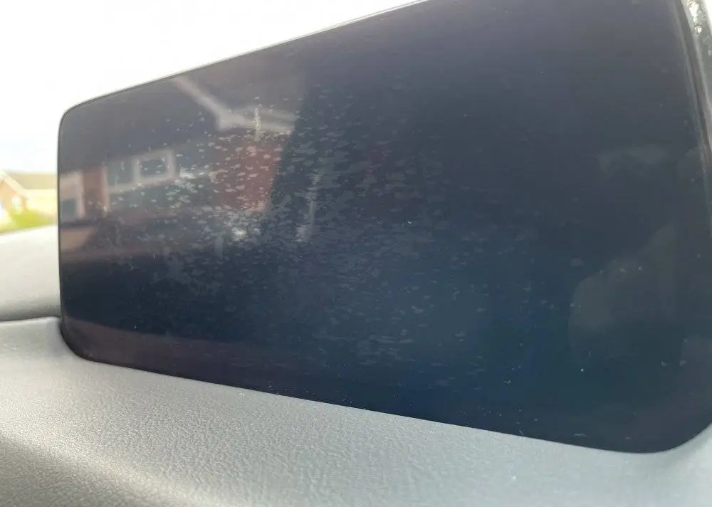

Hello folks, just wanted to add my experience here.
I had the same issue after getting a 2018 Sport Nav - only noticed it when driving home, I thought it was just smearing from when they got it ready for me to collect.
When I got home I used a microfibre cloth but it made no difference. I booked it in to be checked this morning and when I went to pick it up was told that they think it was some cleaning solution which had been put on the screen during valeting, which shouldn't have been done.
They managed to remove the 'bubbling' marks by using a little washing up liquid and slowly rubbing it into the screen. Its removed all the marks, although I can't tell if all its done is remove the anti-glare coating or the liquid.
Either way, it looks good as new now - only took them about 15 mins to sort out.
Hope that helps someone!
