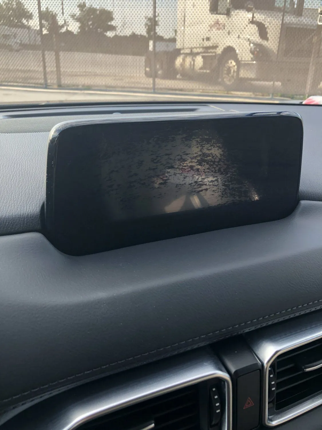

Hi! So I’ve literally been looking all over for some solution to my problem. I have a 2018 CX - 5, Touring Trim. I had my car detailed on Sunday, and by Wednesday I noticed my screen looked foggy/cloudy. I wiped it off with a wipe that’s supposedly good for navigation systems and it did nothing to clear the screen. Then I noticed it appears as if the screen was peeling or damaged. I believe the protective coating/anti-glare stuff is coming off. Can this be fixed and about how much would it cost or is this damaged beyond repair? I do have warranty left, but I’m not sure if this is included.
UPDATE - My warranty covered a brand new screen. Took about an hour to install.

I believe that is the anti-glare coating (or another coating of some kind) that has deteriorated due to the cleaning agent used by the detailer you took it to. This isn't common knowledge, but most touchscreens in vehicles will likely have this coating. You're only supposed to use a soft cloth and distilled water to clean a modern infotainment screen/display, according to what I've read on a couple of auto detailing forums.
Bring it to a Mazda dealership and see if they will honor a screen replacement under warranty/goodwill. I took a quick look in the owner's manual and I didn't see specific instructions regarding cleaning the screen (there really should be). If Mazda won't do anything about it, you'd have to go after the detailer. They should have known not to use a cleaner for the screen, but they will likely fall on the defense that they were not asked to treat the screen any differently than the rest of the interior.

There is no protective plastic. I’m sure this was removed already. I think whatever probably was sprayed dried and left those marks.
I have an appointment Monday with Mazda to see what can be done.

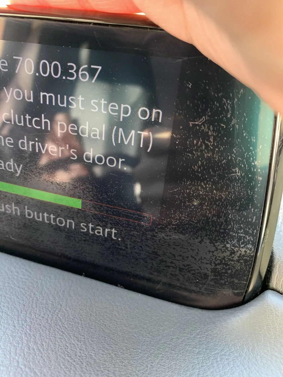

It’s the anti glare coating. Just use the same product to remove the rest of the smudge off. It looks fine without the glare coating to be honest. I haven’t installed a screen protector yet as recommended by others but I will post the before and after pic of the screen protector once I apply it.
Trust me. I had the same heart attack as you last month lol.

That would be a good relief if it is just an anti-glare coating.

My warranty covered it!
Oh wow I have the same issue with a used 2018 CX-5 I just bought. I don’t know what the previous owner used but mine looks very similar. Any idea of what product you guys used that both caused it and solved it (once you wiped off all the coating)?
I used the Meguiar interior cleaner.
