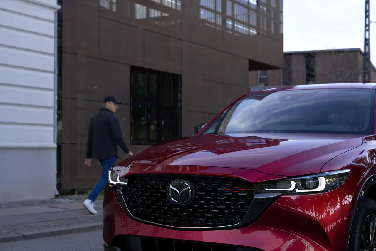

I really like the look of the 22+ with DRLs off.
That does look light years better (pun intended). How do you get that? Is it parking lights for certain models or is there a setting? We have a 22 S Select and a 24 Premium Plus.
Yup, Parking mode on Premium and above trims.
