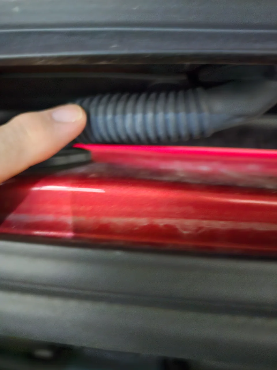

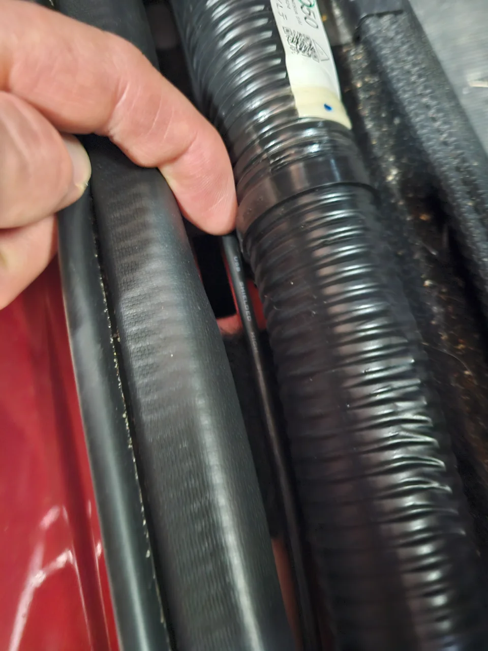

Bronzeglide, thanks for your reply. Does the headliner separate from the edge easily or did you just tuck the wire into the molding? Pics would be very nice. I fear damaging the headliner if I get too aggressive. haha

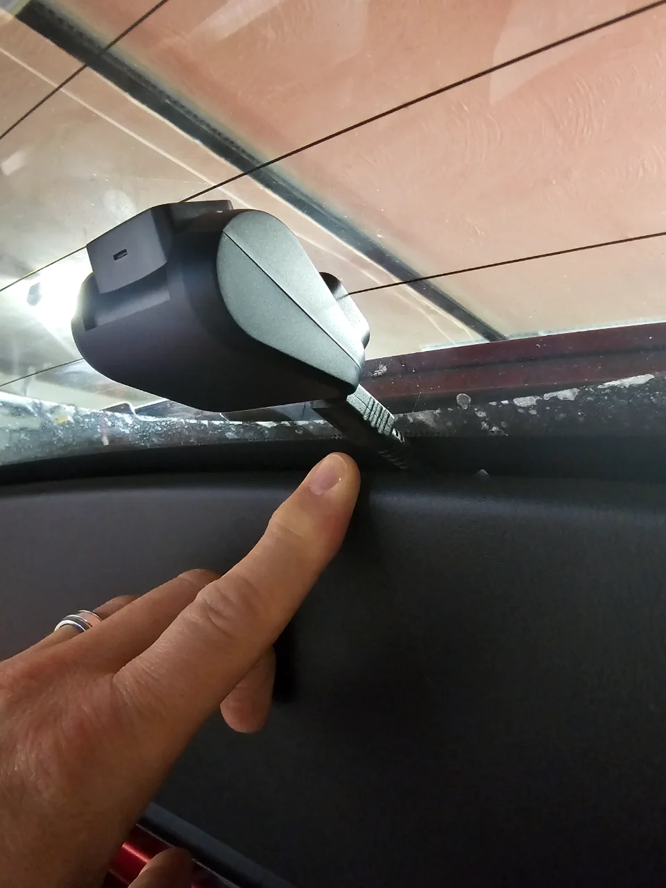

I'm sorry I forgot to send photos! Looking at the car I ran the cable under the door sill towards the back of the vehicle, back up behind the passenger door (driver side), then up to the rear hatch with the stock wiring. I removed the plastic cover on the hatch to feed the wire. I also used a fish tape to pull from the back door area towards the hatch. When running along the A-pillar be sure to run the cables behind the airbag along the stick wiring.

Is there an advantage to having the camera at the bottom of the window instead of at the top?
Hmm, it could be. I thought I saw a wiper blade though.
If you’re referring to the dark red rectangular object, it looks like it might be a roof or some other part of a building past the white canopy. I think most rear cameras are meant to be installed at the top of the glass and is angled to point downward. If it was installed at the bottom, the camera would be pointing up to the sky.
