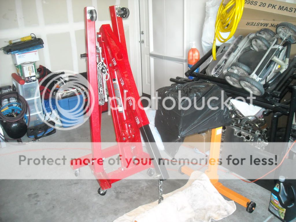

Well my Bro and I went down to his house to grab some misc things we may need and some of my old Protege stuff he had laying around and said eff it, we are bringing his damn 2 Ton Engine hoist in his P5 with us, so we did. We had to take it apart to bring it but it was worth it to make it a hole lot faster to take out the motor on the MSP and put in. We also mounted the engine to his engine stand that he let me borrow ( mine is being used by an extra Engine I have for my Acura ). I will hopefully be starting the tear down today if time permits. One main thing I need to do is get some better lighting for the garage so I will be shopping around for some Fluorescent lighting to install in my garage early this morning. Should have them up and installed in no time.
haha that hoist looks familiar...sitting on my front lawn right now lol. havent decided where to put it now that mine is done...speaking of which, how far did you get today?

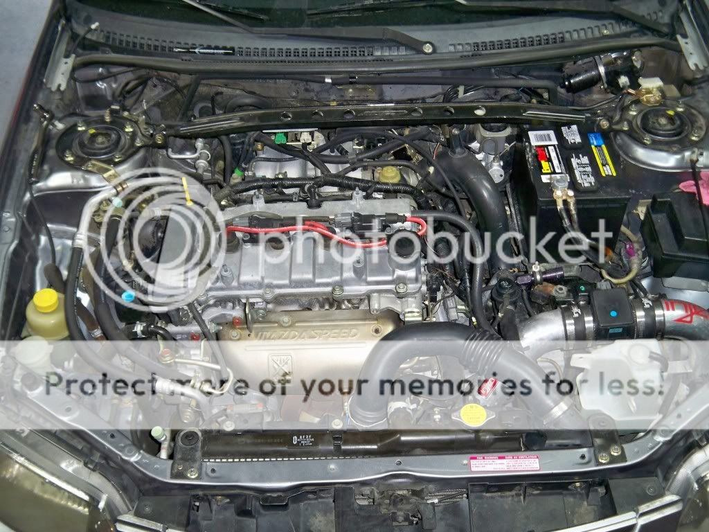

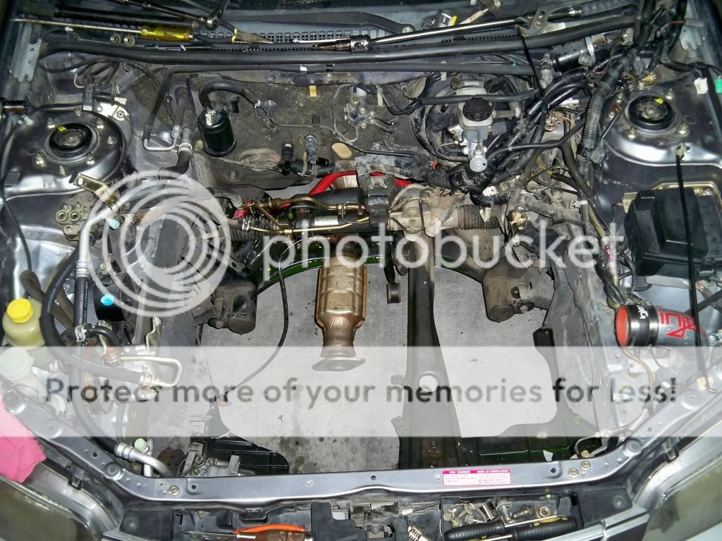

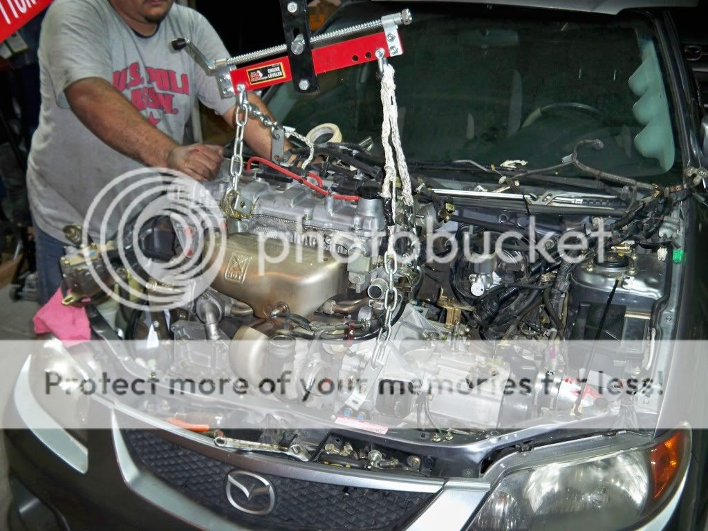

Well my bro and I finally took the plunge. He had the day off and so did I. It was all worth it though. I'll let some of the pictures speak for themselves.
And here is the final outcome.

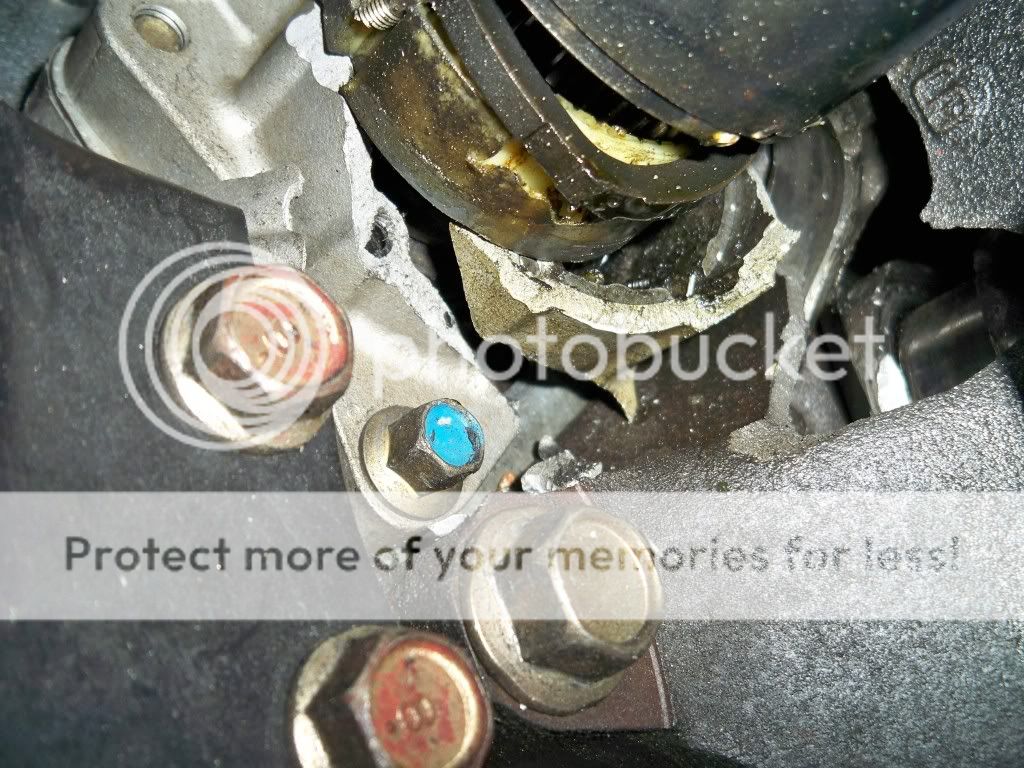

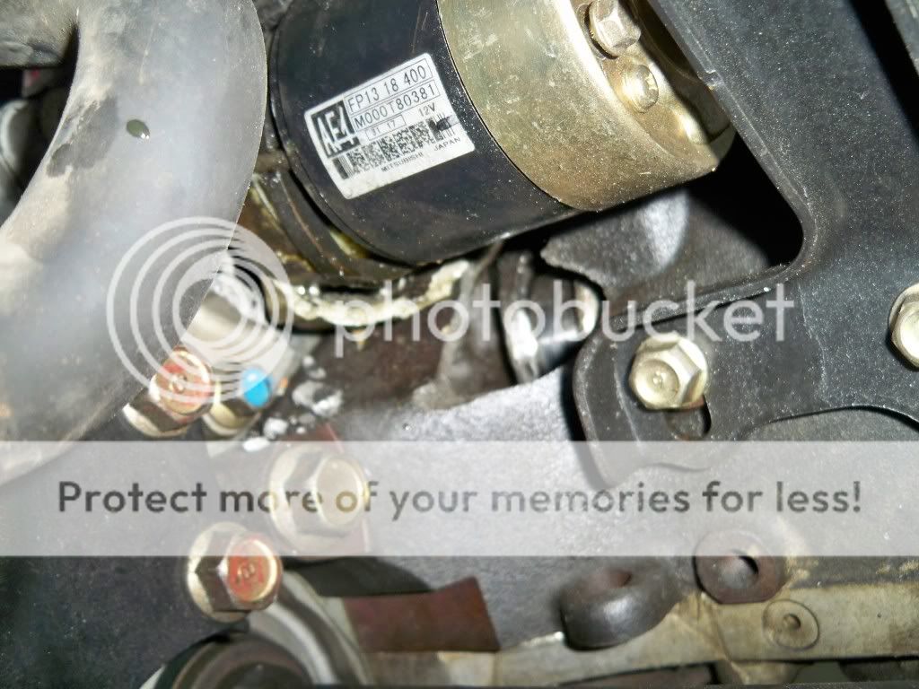

Well this is the low down. The block is shot which I already new. The MBSP has a small section at the bottom ( no picture for this though ) that is missing like a hole punched through. Because of the damage to the block it went through and actually damaged the starter! The trans was unharmed which is a good thing. Front engine mount is completely shot, rear engine mount is brand new, Trans mount is in good condition and the passenger mount is also completely gone but I already have a new one for that.

Well couple of updates. Have been taking off all the accessories to the blown engine and noticed the turbo is soaked inside with oil and also a lot of shaft play. Will have to look for a new turbo. I am hoping to find a GT28R or GT28RS for a good price and cheaper if I have to rebuild, I dont mind. I am going to see if I can fix the MBSP as it still looks like its in good condition. Here are some pictures after I took off the starter.
