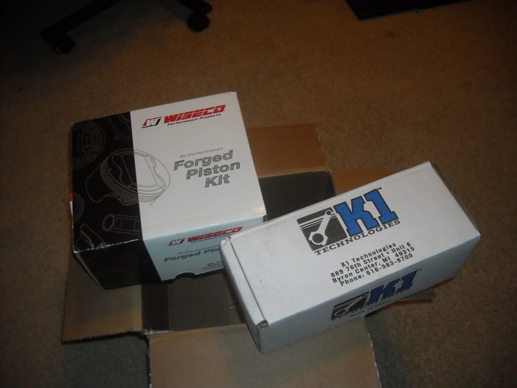

Just got my Pistons and Rods today! So excited. Going to drop them off in the morning to the machine shop for final clearances. Hopefully she will be up and running by this weekend or the next. (naughty)

those the wiseco's and k1 longs? i have those two same boxes next to me lol. taking all my stuff to a different shop on monday so i can have it back within a week including short block assembly.
No actually Stock Length Rods and Stock .040 over 9.1CR Wiseco's. Just got my pump yesterday. Just waiting for the shop to say when to pick up everything I got from them and start the build.

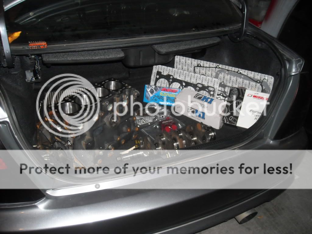

Got pictures up of everything.... well except the Water Pump but its a Brand New Bosch Pump thats not pictured. Have it all in the trunk ready for install. Just need to go get the braided lines with the oil filter relocation kit. Some odds and ends like sensors and fluids and I am all set.
I just noticed the Bearings are missing from my set...... Hmmm well I wasn't charged for them at least. Gonna call them up tomorrow and see why they were not ordered and will have to take the crank back so they can check clearances unless he has them and forgot to give them to me. Oh well anyways this is what I have at the moment.
