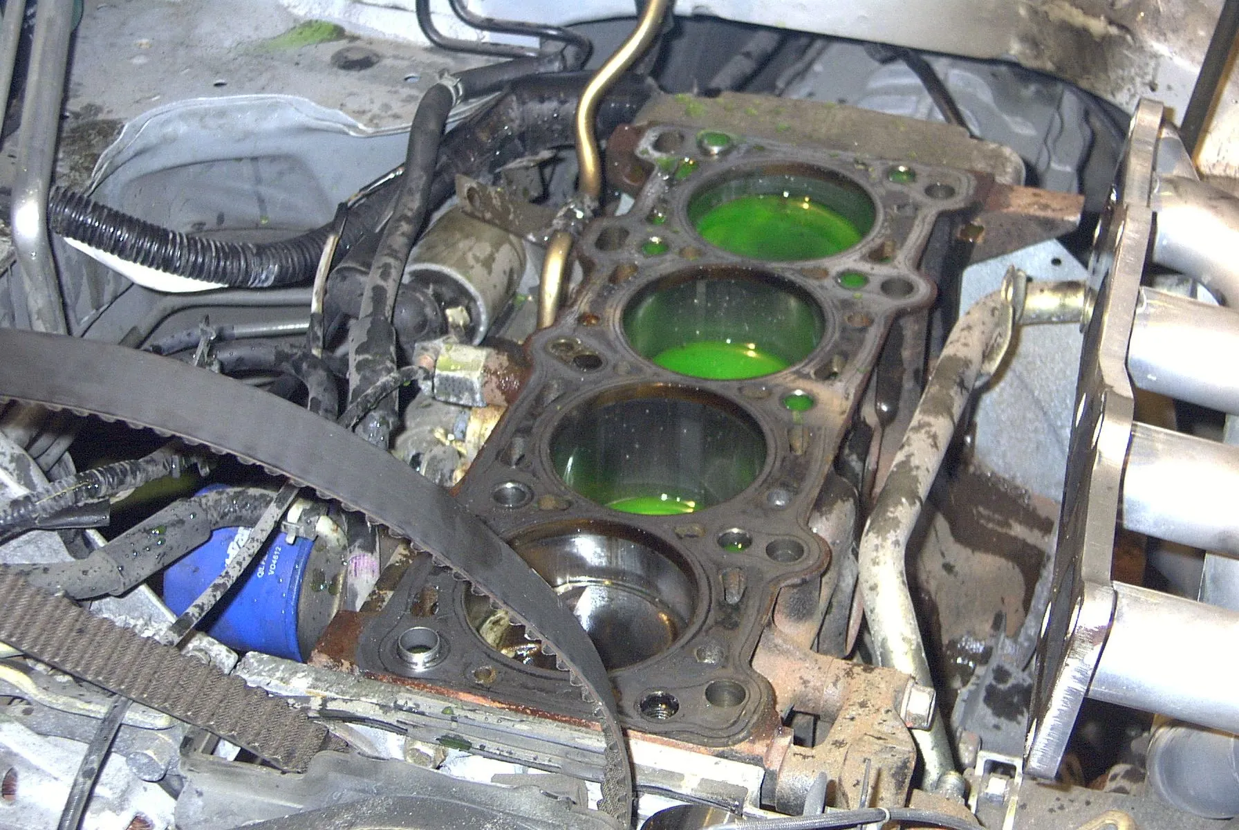

did you get your cylinder head back I presume?
did you remember to remove the coolant before removal?? LOL im an ass
