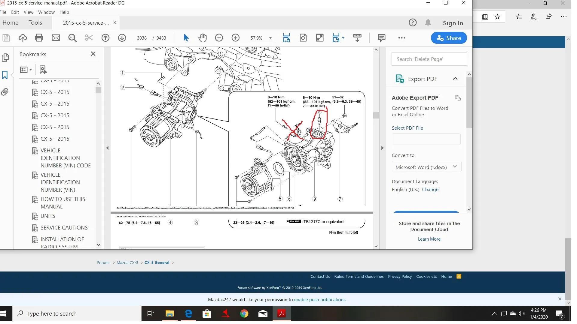

Unobtanium usually takes the CX-5 to his Mazda dealer for service. Here is front transfer case and rear differential gear lube checking and replacing procedures from Mazda Workshop Manual:
Finally found a couple of pdf attachments thanks to our great Anchorman! I converted them to jpg's and here they are:
attachment.php
attachment.php
Just make sure when you follow the procedure, you need 0.75 ~ 0.85 quart gear lube for rear differential than stated 0.48 quart (0.37 quart for gen-2 CX-5).
