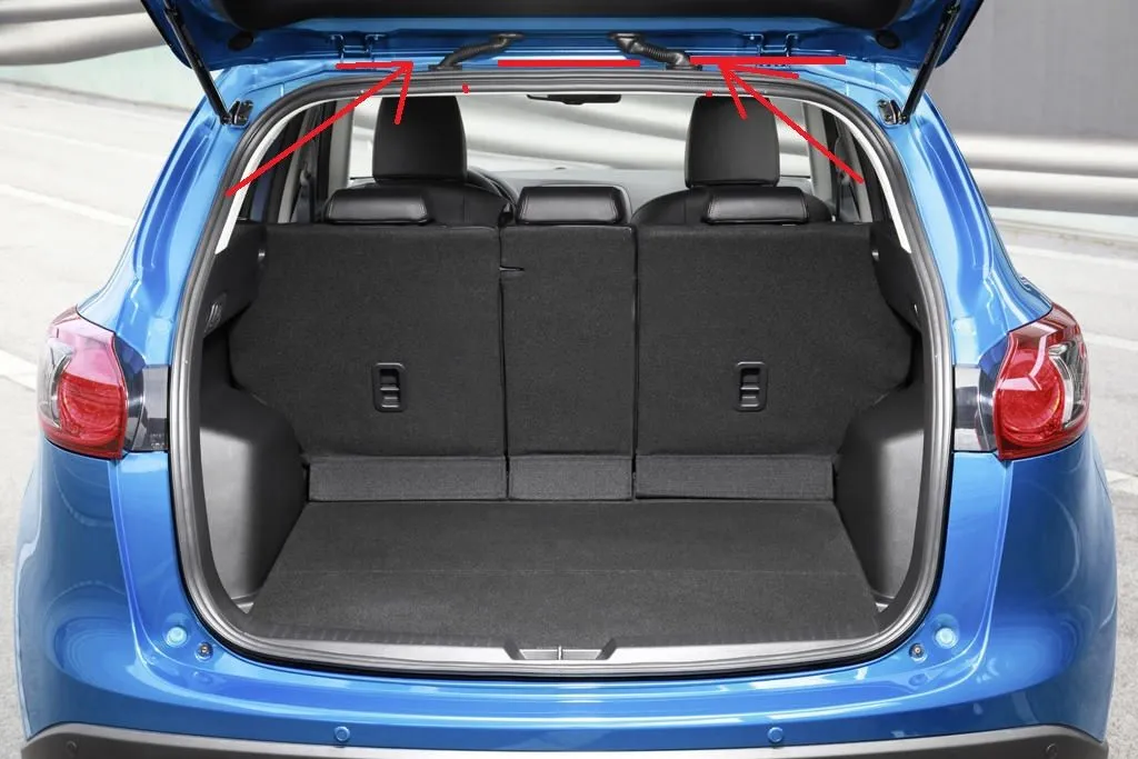

One thing dho... it's happened at the same time when we had snow storm and freeze and defreeze... and found that a lot of snow is getting inside between the roof and the trunk near those protected cable that go to the rear trunk (attached picture to explain better). I wonder if the snow/ice squeezed the cable for the rear camera, other light on the trunk is working fine dho...
