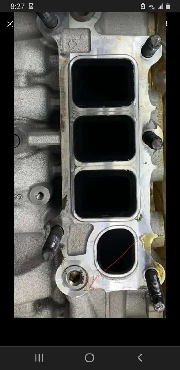

CX9 Built Jan 2021. Many months after the vin range for coolant leaks for cracked heads. This was on Facebook. This guys car should have had the updated head but it cracked. I spent a ton of time looking at his head and the tsb and the heads look the same. Maybe Mazda just put in deeper exhaust studs? I know the exhaust gasket was claimed in the TSB to have been revised also. Anybody know?
I don’t know if it is a typo, but a 2020 cx-9 built in 2021? I would expect a 2020 cx-9 to being built in 2019 or early 2020. Maybe it is a 2021 CX-9 built in 2020?
That would change whether it has the updated head or not.
