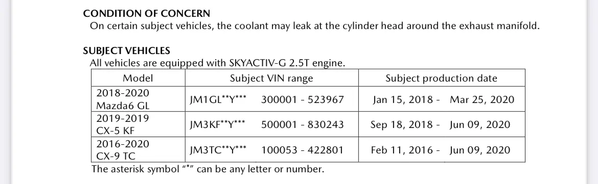

The warranty was extended for 10 years (120,00 miles) and those that paid for the repairs out of pocket before will be reimbursed.
https://static.nhtsa.gov/odi/tsbs/2024/MC-11011136-0001.pdf
Owner who want their previous repairs reimbursed will have 6 month after the letter mailing date to claim the repair. See the details here:
https://static.nhtsa.gov/odi/tsbs/2024/MC-11009658-0001.pdf

Sorry if I'm asking what's stated in the tsb but is it clear that the 2021 do not show this issue? I own a 21 my CX9 2.5T and also a 19 CX5 Signature 2.5T (that I did get the warranty letter for yesterday).
For the moment, 2021s are not yet part of the extended warranty. See table below:
Your 2021 does not have this issue. It has the other issue with defective exhaust valve seals causing excessive oil consumption. There is a special service campaign for that from Mazda as well as an extended warranty and you need to go get that fixed ASAP
Mazda has extended warranty on this issue to 10 years or 120,000 miles.
