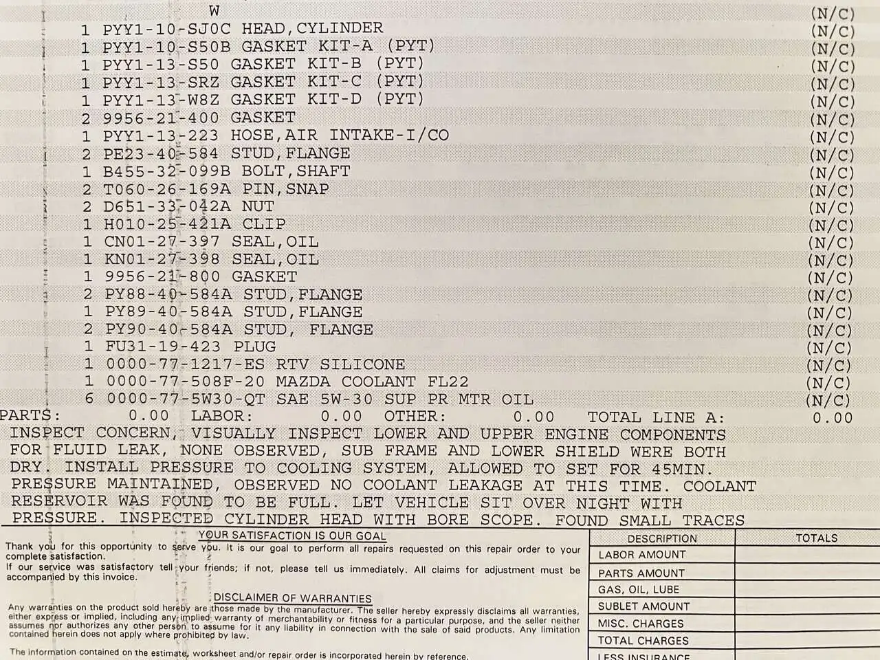

But you should receive an invoice with 0 balance showing all the parts used and labor for any warranty work after the work is done.
The invoice doesn’t mention any transmission fluid or transfer case gear oil, but it does include the drain plug crush washers and oil seals for those, so if they replaced those the fluid would have come out — but here is no mention of the fluid for those on in invoice with zero balance.
So my question is for those who are familiar with the actual TSB repair procedure for coolant leak/head replacement on the CX-9/CX-5 if the transmission and transfer case got a drain and fill as part of this repair.

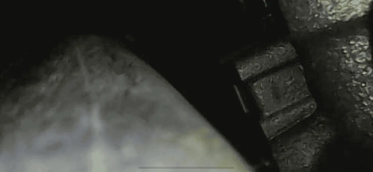

It’s very tight to get to the TSB location 1 on the exhaust manifold bolt and past that to get to TSB location 2 where the head cracks.
I got a $30 endoscope for iPhone on Amazon with a built-in LED flashlight and sent it in from the passenger side just between the turbo and exhaust manifold - you can follow the 2 exhaust manifold studs down to a tray (metal exhaust gasket) and use that to guide the bore scope to the TSB location 1 and then onto TSB location 2. You have to pop the bore scope out of the tray to get around to TSB location 2. It takes some twisting of the scope cable but eventually you can get a picture of it.
Here is location 2 with green coolant drips from a small crack on the head.

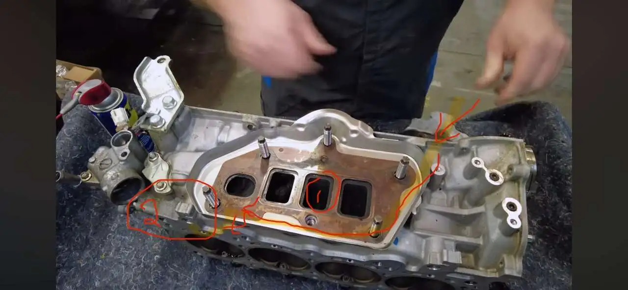

Also found the CX-9 coolant leak engine tear down video from Car Wizard on YouTube “Why does it cost $4k to replace $50 gasket” super helpful understanding where I needed to look.
Picture below is the metal exhaust gasket (tray) on the head. The bottom of this picture faces down when attached to the lower block and the 4 exhaust ports face to the back of the car, so this is what it looks like if you’re sitting in the passenger seat and could see through the firewall, with the head tilted forward 90 degrees.
So you slide the bore scope from the upper right, down past the two exhaust studs on the right, hit the bottom right corner of the tray (metal exhaust gasket) and follow the tray along the bottom from right to left, go past the middle bottom stud (TSB location 1) and keep following along the bottom of the tray to the lower left exhaust stud, and then twist the bore scope cable to pop out of the tray to get to TSB location 2, which is that small rectangle with rounded corners sticking out from the head (cast aluminum).
It takes several tries to get a good shot of TSB location 2, but this is what worked for me, ymmv.

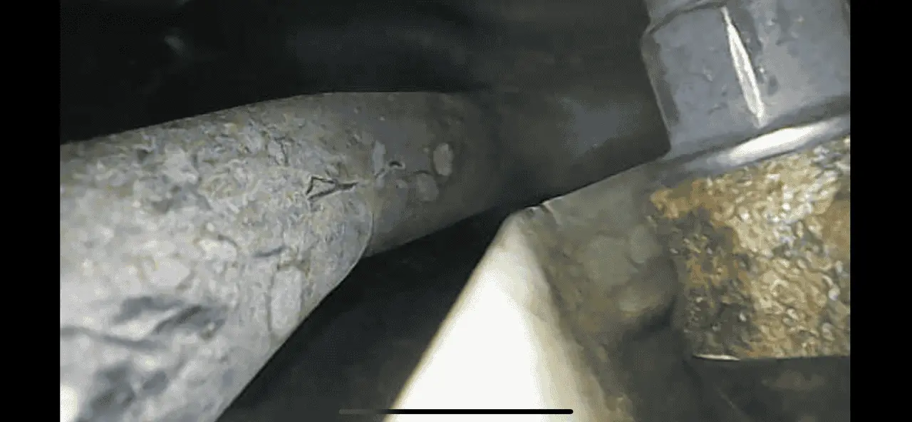

It also goes without saying to wait for the engine to cool off before slowly threading the bore scope in and out — but also driving for a bit will create fresh coolant spray that is easier to see, so I did that and waited for the engine to cool off and then sent the endoscope in.
Here’s another picture (rotated 90 deg to the right) of the lower left exhaust stud just above location 2 on the TSB. You can see the dried coolant on the hose on the left which is just below TSB location 2.
