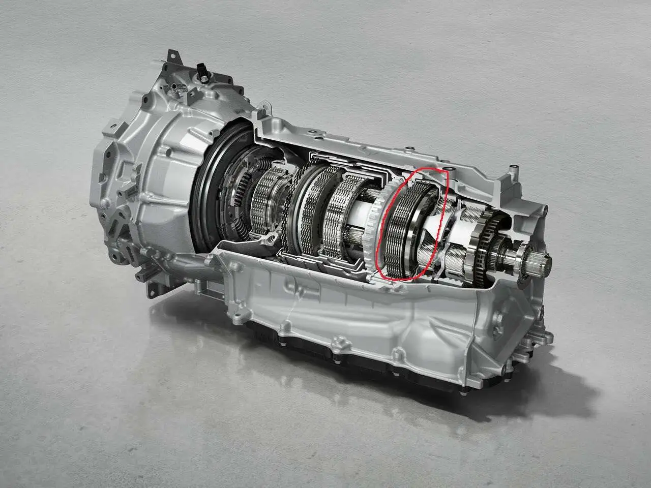

To answer your transmission questions. I don't have the CX-60 in my country so I assume it behaves the same as the CX-90 and does have creep function. For your second question about the clutch. The clutch set that is slipped during launch is the biggest in the trans and is designed to handle it and is located in the rear of the trans. One of the unique aspects is that it is a brake clutch vs a driving clutch and Mazda refers to it as the "B2" clutch as it is the second "braking clutch" inside the transmission. There are two other clutches engaged transmitting torque, the B2 slips and couples the output shaft to the intermediate shaft. The electric motor provides torque assist at launch that a torque converter would normally provide. I've circled the clutch set in question in this cutaway picture.

Is the lowest forward ratio in the gearbox low enough for all eventualities, given that the connection between engine and gearbox is an auto clutch, not a torque converter, so there is no multiplication of the first gear ratio for a start demanding higher than normal torque
I had forgotten that the vehicle (CX90/CX60) uses Mild Hybrid Technology (MHT), so your response is interesting and helpful, as well as making an important point.
