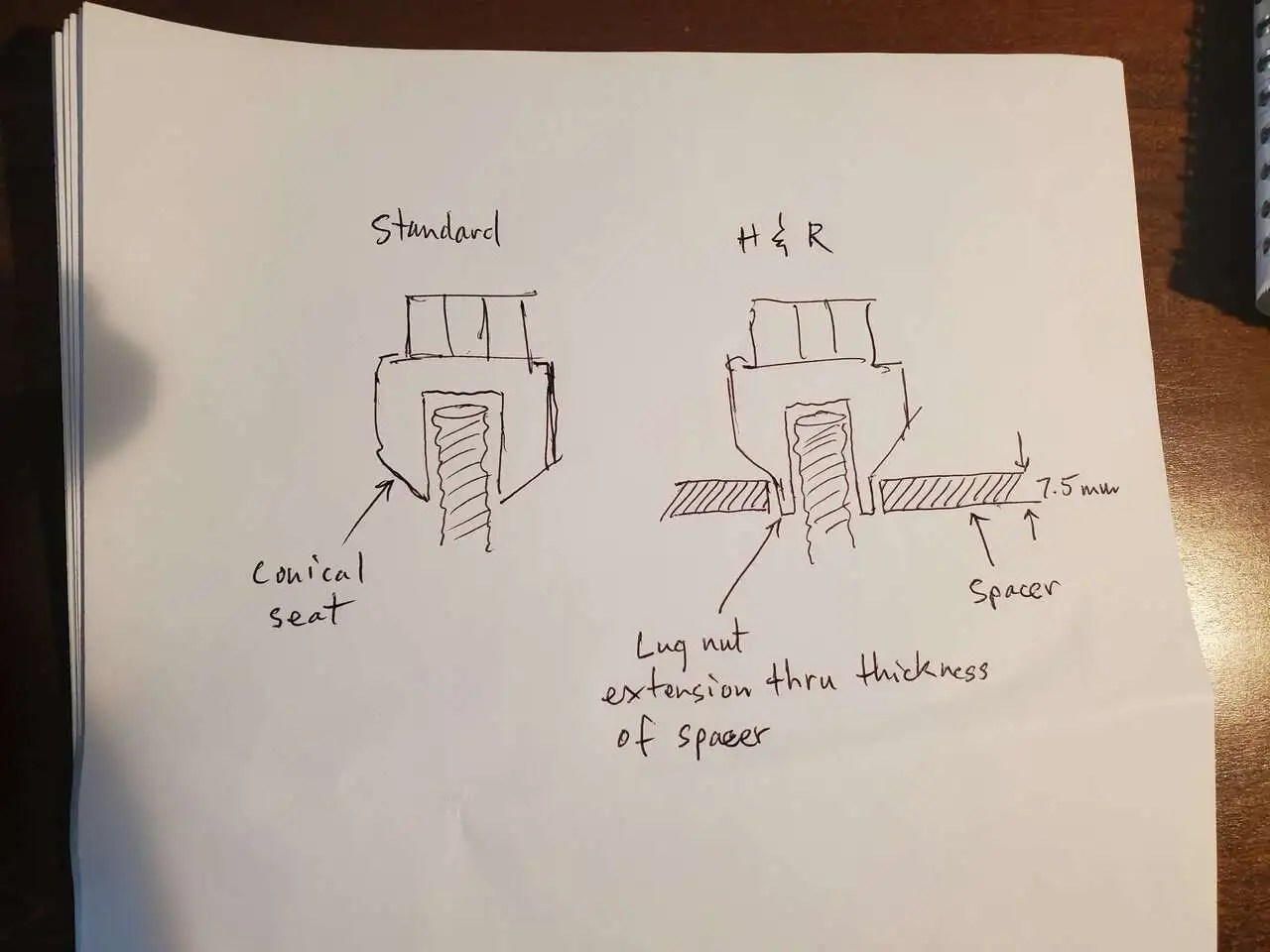

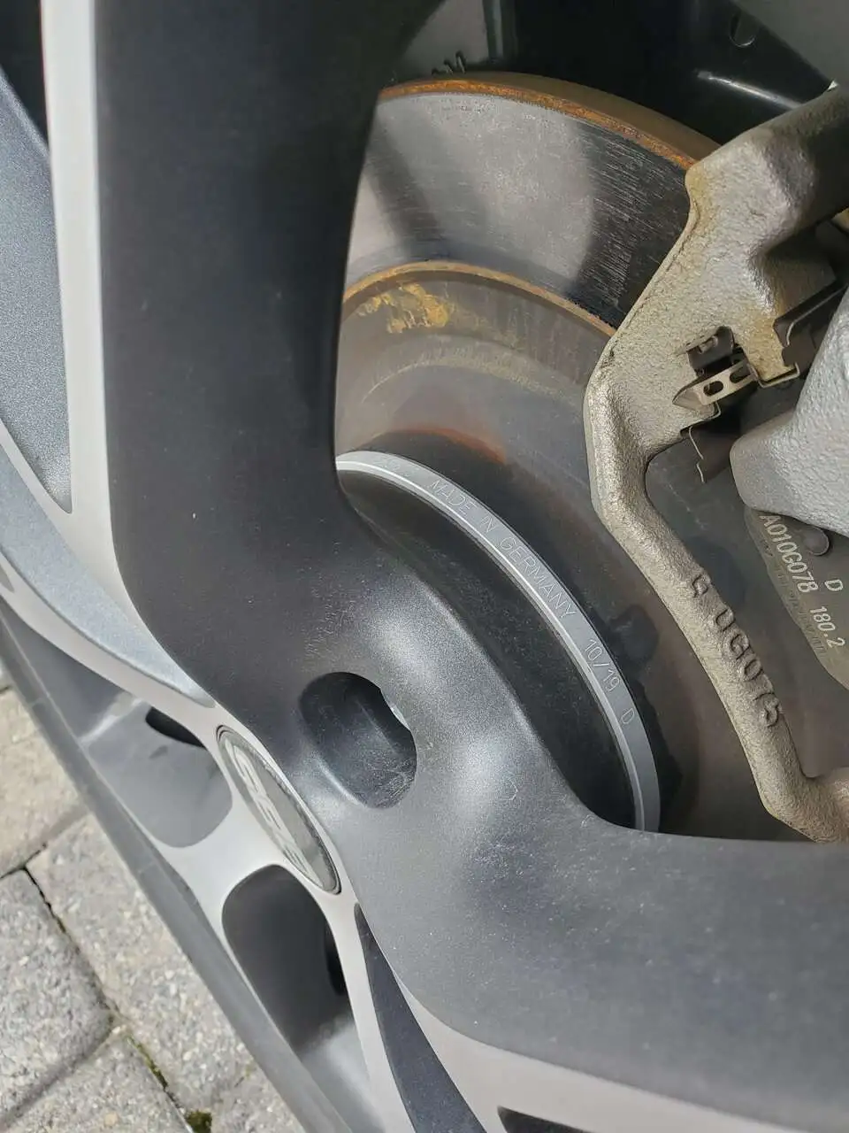

Well, as of a month ago, nobody is listing spacer fitment for the -50. So I went to school on dimensions and decided that the CX-5 (model year 2017-2021) should fit fine (and they do!). I ordered these up from Redline360 (they are a very responsive outfit - no affiliation with them for me other than being a customer). Redline contacted me with the “well now, we are not sure they will fit and it is your risk” caveat. I decided to go for it and all is well. I got the H&R DRS 7.5mm. These are slip on fit and you don’t need to change the stud length because they come with special nuts that fit the spacers and work with the standard lug depth. I counted 9 turns to tight, which is 3 more than H&R says you should have.

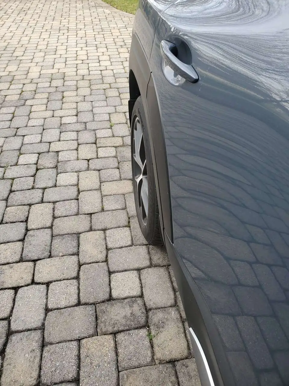

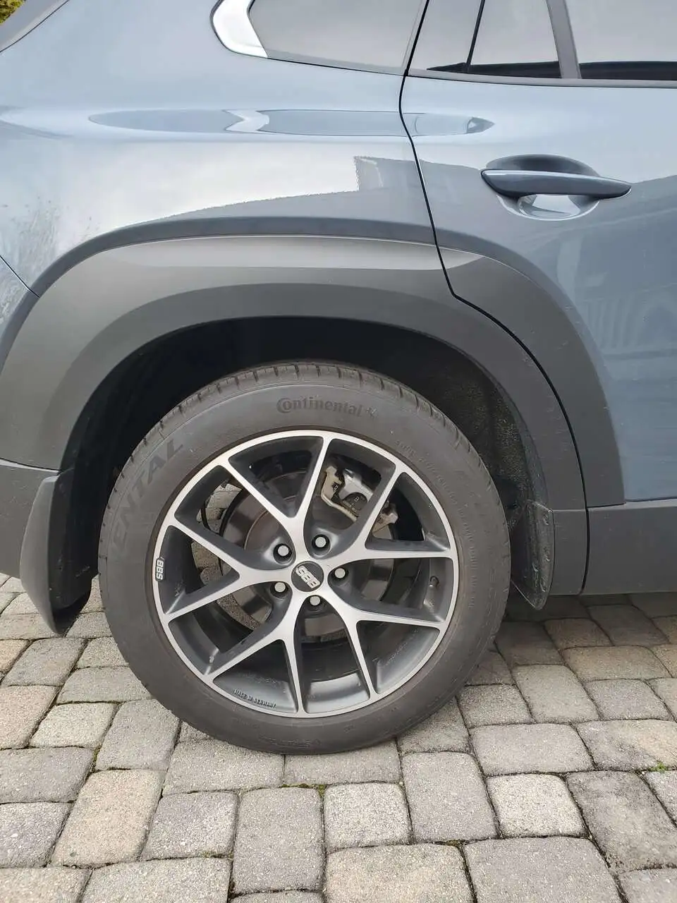

And, in the end, the combination of 6.5mm (from wheel width) and 7.5mm (from spacer) giving 14mm total outward movement of the wheel face is just perfect to give a “the way the factory should have done it” appearance. No poke, but also now my -50 doesn’t look like it needs a trip to the gym for a leg workout!
Sorry for the wordy post - just wanted everyone to know that 15mm is a good track increase number for the back and about half of that or around 7.5mm matches it on the front. No compromise to anything - just looks more ‘finished’. Enjoy your rides.

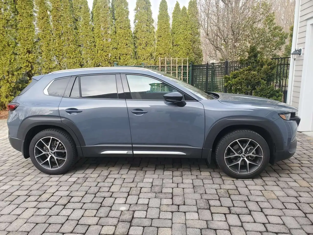

And if anyone wants to know, I went with the BBS SR wheels in 19x8.5 ET45 (Tire Rack). The anthracite matte finish inside the machined aluminum spokes matches the black plastic on the car perfectly - it is a very ‘factory’ looking setup. Those same wheels are available in ET35, which I sort of wished I had bought instead of the ET45 - no need for any spacer at all on the back but the front may ‘poke’ just a little. Still will run fine on the CX-50 or our conservative friends at the Tire Rack would never offer them.

Looks very good. I assume the factory studs were still long enough at the back?
