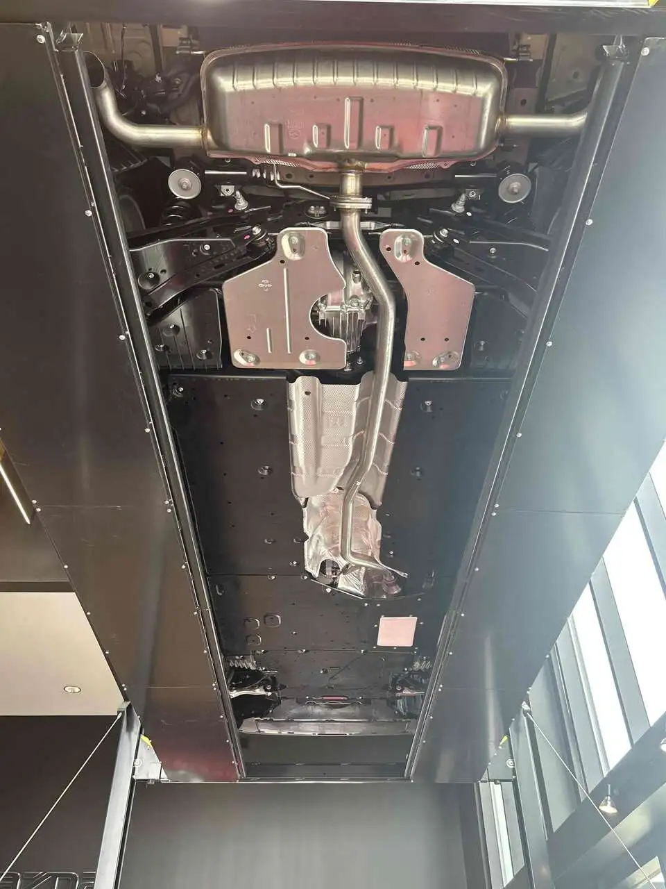

I wonder why they don't put flat panels under the entire car like race cars use. They know it would help economy and keep things clean.
I believe the 2024 CX-90 has a full belly pan. They had one up on a lift in the showroom where I bought my CX-5.
From the dealership in Lakeland, Florida. Most of the underside is covered.
