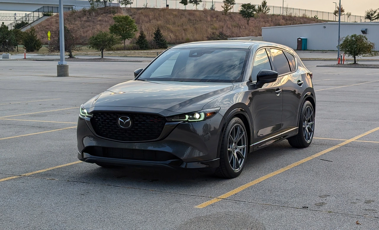

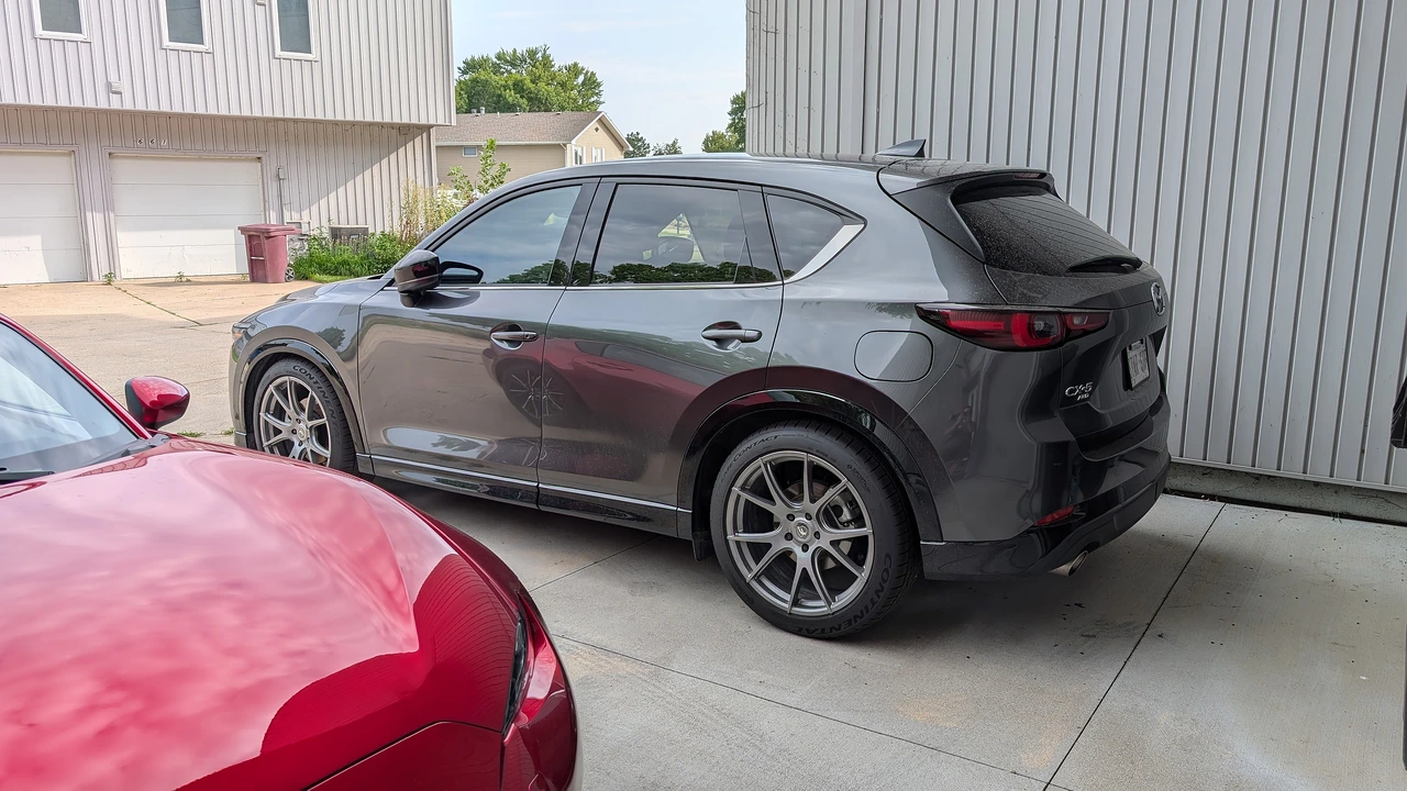

20×9
245/45/20

@N7turbo documented his process on here. I think he created a thread or two on the subject. It's very in-depth and worth a look through, covers a ton of bases with good questions, answers and explanations from the community throughout.
