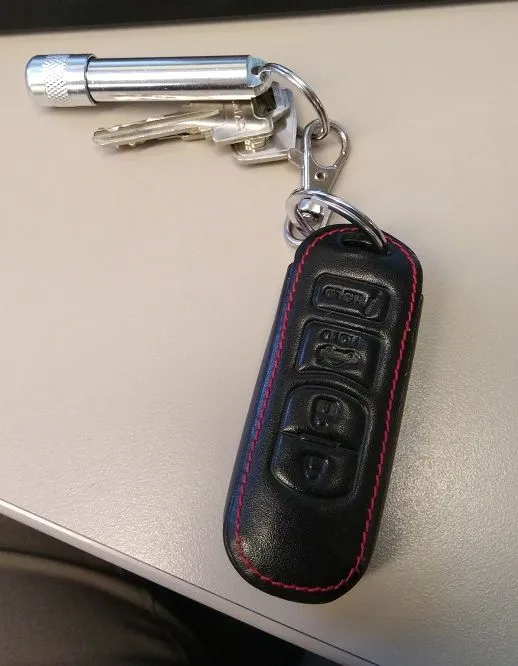

Maybe a leather case?
But obviously you have to open the case to press a button. Too inconvenient for me.
I'm guessing the buttons are less sensitive with a https://www.amazon.com/dp/ (commissions earned):

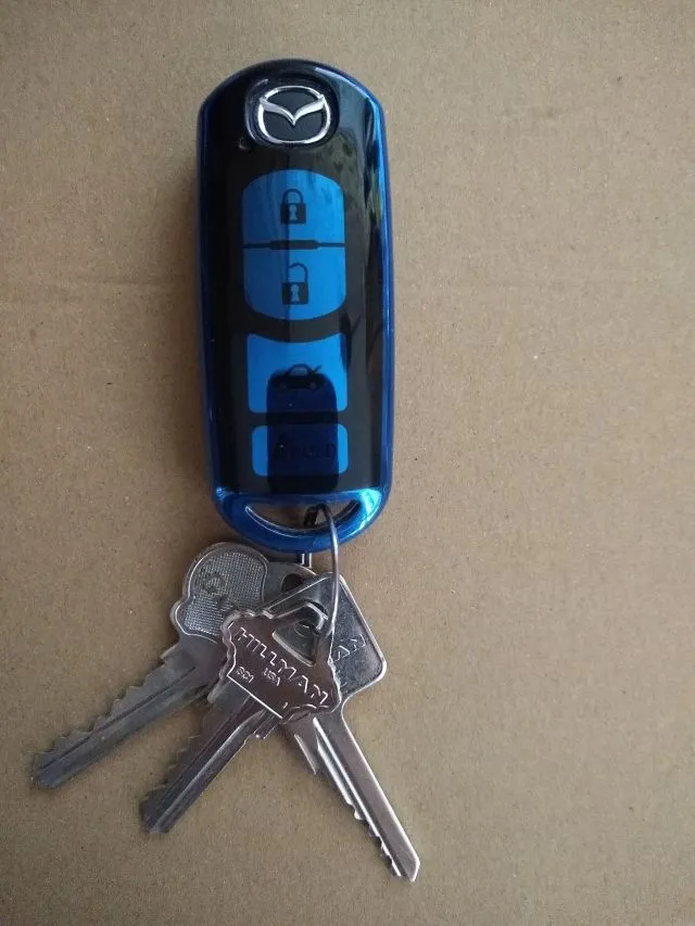

I've not had that issue, but purchased https://www.amazon.com/dp/ (commissions earned) fobs on recommendation of a fellow member:
This is an enclosed case. The fob goes in the back and then the rear cover slides into place. You have to push the icons on the case (they are screened onto a solid film) in order to engage the buttons on the encased fob. I don't use the fob to control the doors or locks, so it always stays in my pocket...this keeps the dust out, and provides the added benefit of requiring more pressure to engage any of the fob's buttons so it does not happen accidentally.

The issue with the blue one (and likely the red) is that the color is so dark, there's little contrast with the screened-on black icons in some conditions. It's not like the picture. Indoors, under incandescent lighting, you have to be at just the right angle to see each icon; otherwise, the entire thing is one dark mass.
When I first got it, I made sure to look at it in a marginally lit parking lot at night to see if this was going to be a significant issue, and the contrast was sufficient...under those specific conditions. I suspect the lighter colors give better contrast. And the only lighting conditions where I've had the "completely fades out at the right angle" issue has been directly under incandescent lighting.
Keep in mind the thing never leaves my pocket, so I never use it. I have "Walk Away" door locking turned on, always use the button on the door handle to unlock it, and always open the rear hatch by the dash or at-hatch buttons.
That being said, I like it. The fob is completely enclosed in the case to keep dust & lint off of the buttons. The case has a nice "heft" to it. It matches my car. I have one for each fob, even though I'm the only driver, so as to keep the spare dust-free.
I forget which member here recommended this. Maybe he can chime in on his color and icon-contrast.
This hasn't happened to me (yet), but as a precaution I've minimized what's on my keyring (only keyfob, house keys, mailbox key and LED flashlight). I also purposefully "separate" the keyfob from the other keys when I put my keys in my pocket. I never take my keys out until I need them, and they stay like this throughout the day. No accidental unlocks or trunk openings to date.

That was me, I'm pretty sure. My wife and I use the red one, but I haven't been in a lighting condition where I have been unable to see which button was which. That said, I'm like Avoidin in that I rarely take it out of my pocket. It's only been 7 weeks since I started using the cover, but it still looks brand new and I've put 1200 miles on the car. This is a very nice, not too big fob cover.
No accidental trunk openings to date for either me or my wife.

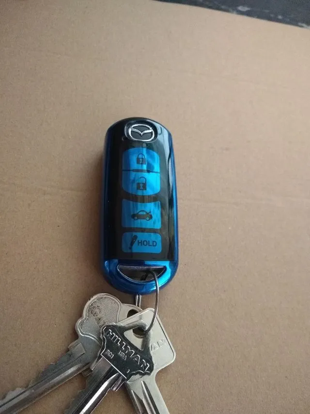

I love my fob. Thanks for the recommendation! I'm glad the red has no contrast issues. After I wrote my comment yesterday, I was outside (a sunny day) in the shadow of my garage. Looking straight on the fob, my reflection obscured the icons. I had to turn the fob to the side to see them.
Here are a couple of pics taken under a window to show you what I mean.
Standing back so I don't cast a reflection:
The reflection of my cell phone on the two bottom icons.
The fob is pointing at the window...I'm not blocking the light.
I can rock the fob slightly to one side in many lighting conditions, and the entire front will black out. As I said, I never use it for anything but the transmitter. And if I did use it regularly, I would instinctively reach for the right button without looking. But this is how the blue one is.
