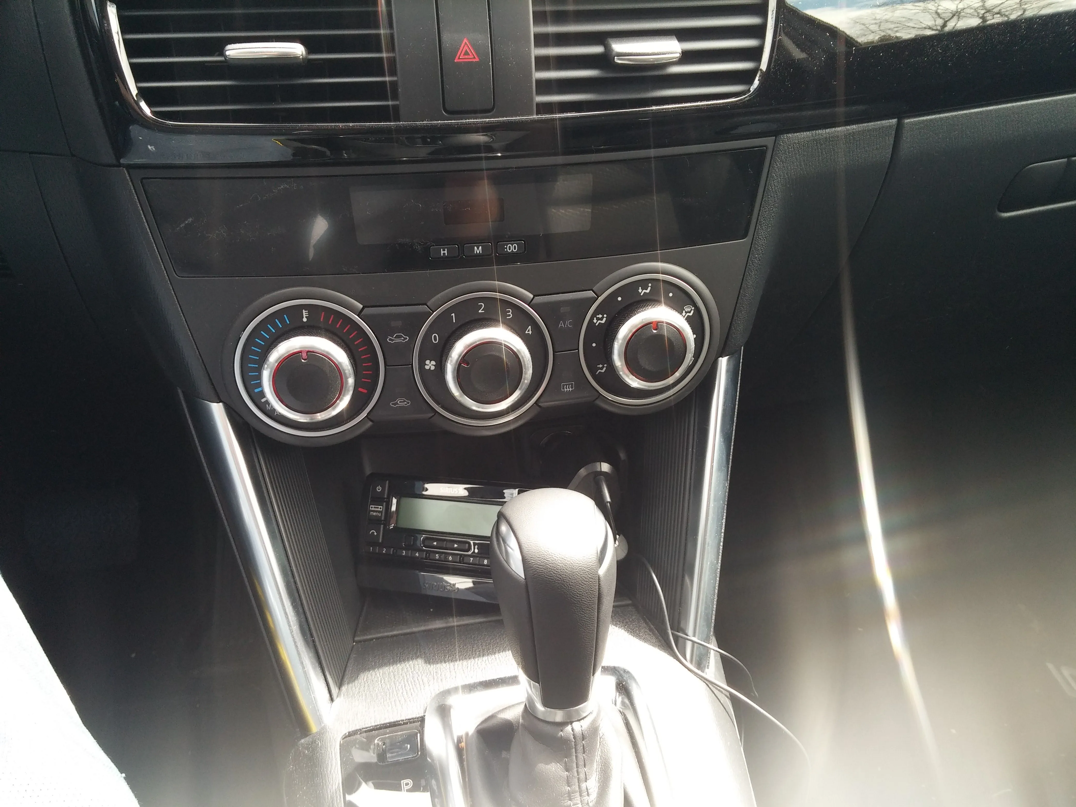

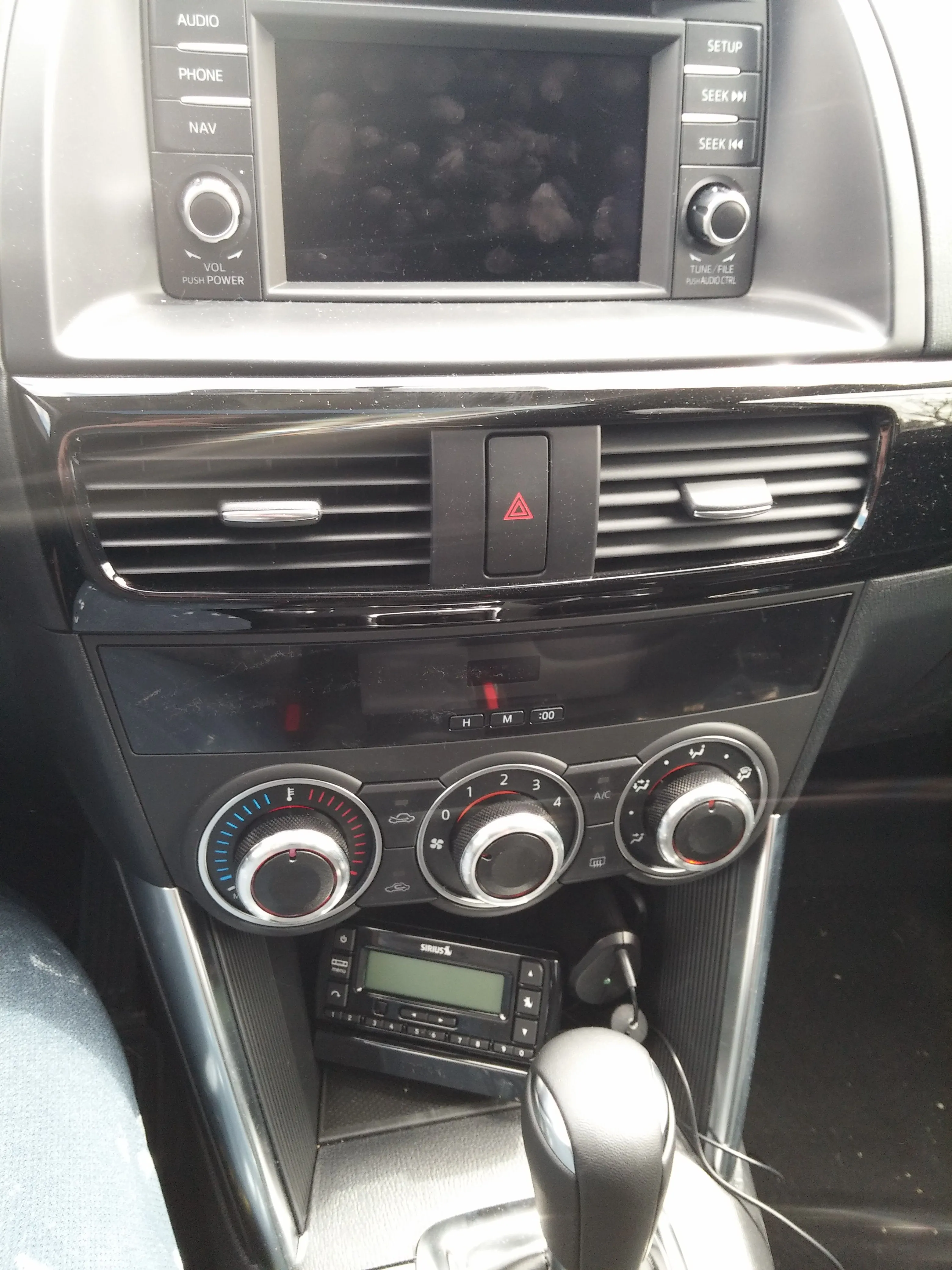

Well I just got them in the mail and I can confirm that the ones for the 2010-2013 Mazda 3 work just fine. They are not 100%, but are nearly 95% and look great.
Here are some pics.

Looks good! Does it light up when you turn on the parking/headlights? And you mention 95%... What do you observe that will put it to 100%? You definitely got me interested in this mod. :)
The modifications would be hard to make yourself. The HVAC unit is not completely flat behind the knobs so these rub slightly and have a tad more resistance then the stock knobs. Other then that they are perfect and really look much better.
As for the backlight the speed and mode knob are perfect. The temperature knob is not the same shade of amber and is washed out slightly. Nothing that a little paint won't solve. I'll take a picture when I can.
For less then $20 this mod is a no brainer.
