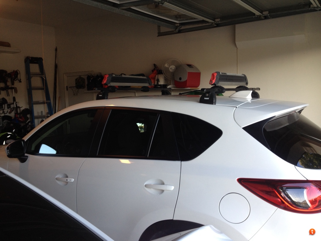

Any roof rack with the accessories (bikes, kayaks, ski boxes) affect the wind noise and mileage. I have a Yakima ski box and bike rack so ordered the Railgrab (4) mounts off eBay for $170 USD shipping included. Yakima gets $180 + shipping.

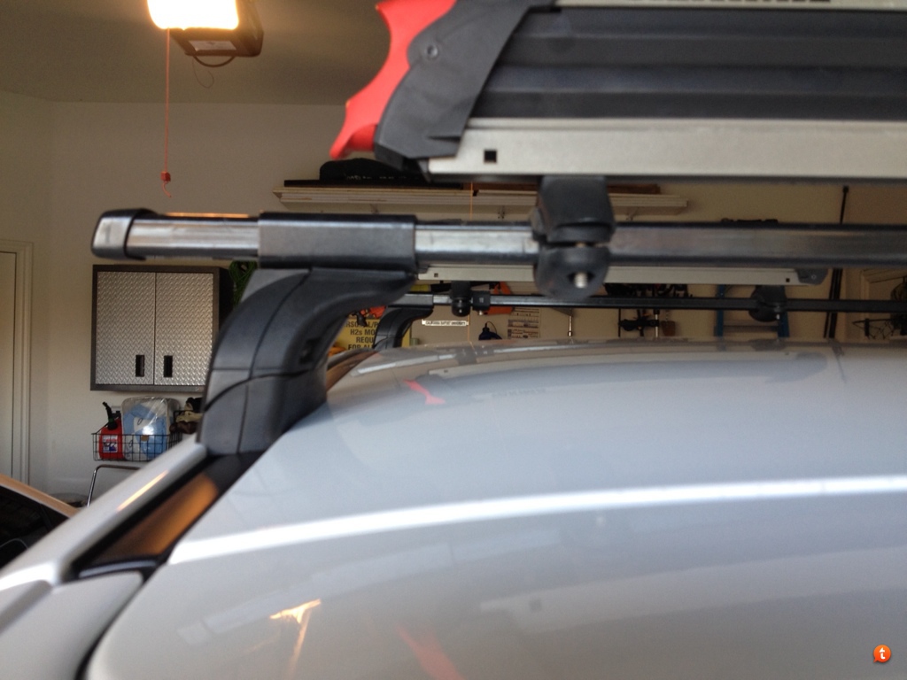

I took this rack off my 08 Subaru WRX before I traded it in for my '15 Cx-5 GT.
Sent from my iPhone using Tapatalk
AFAIK Thule doesn't list a podium foot fit for the CX-5, just the clip on style. So, two questions: what foot is that, and, does it fit? (Looks like it does).
More generally, rack manufacturers make a big deal of their "fit kits", but when you look at, say, the Yakima base for the Control Towers that officially fits the CX-5, it's just a rubber pad with no real contouring. It looks like it would be no better or worse than a generic mount.
I wish I had that information to give. It came on my '08 Subaru WRX hatchback when I bought the car from a private party.
It definitely fits. The rubber "feet" are conformed to the roof and grooves. It does not wiggle or anything. I didn't mod it to fit. I had to widen the feet to fit the CX-5 but that's it. I utilized the same hardware as well.
If you know where a part number may be printed on it I'll go check.

Hmmm...... do the cross bars on the Thule rig come off easy, and leave little stumps? I'm asking because Yakima makes something like that that officially fits the CX-5, but only for the round bars. Thule has what they call "Podium Feet" (which is what you have there) that will take aero bars, but with no official CX-5 mount.
Hey wait, I tracked it down-- fit kit for Thule on an '08 WRX four door is #3068. That's great info-- I'll get a set of those and see how they fit. Thanks!

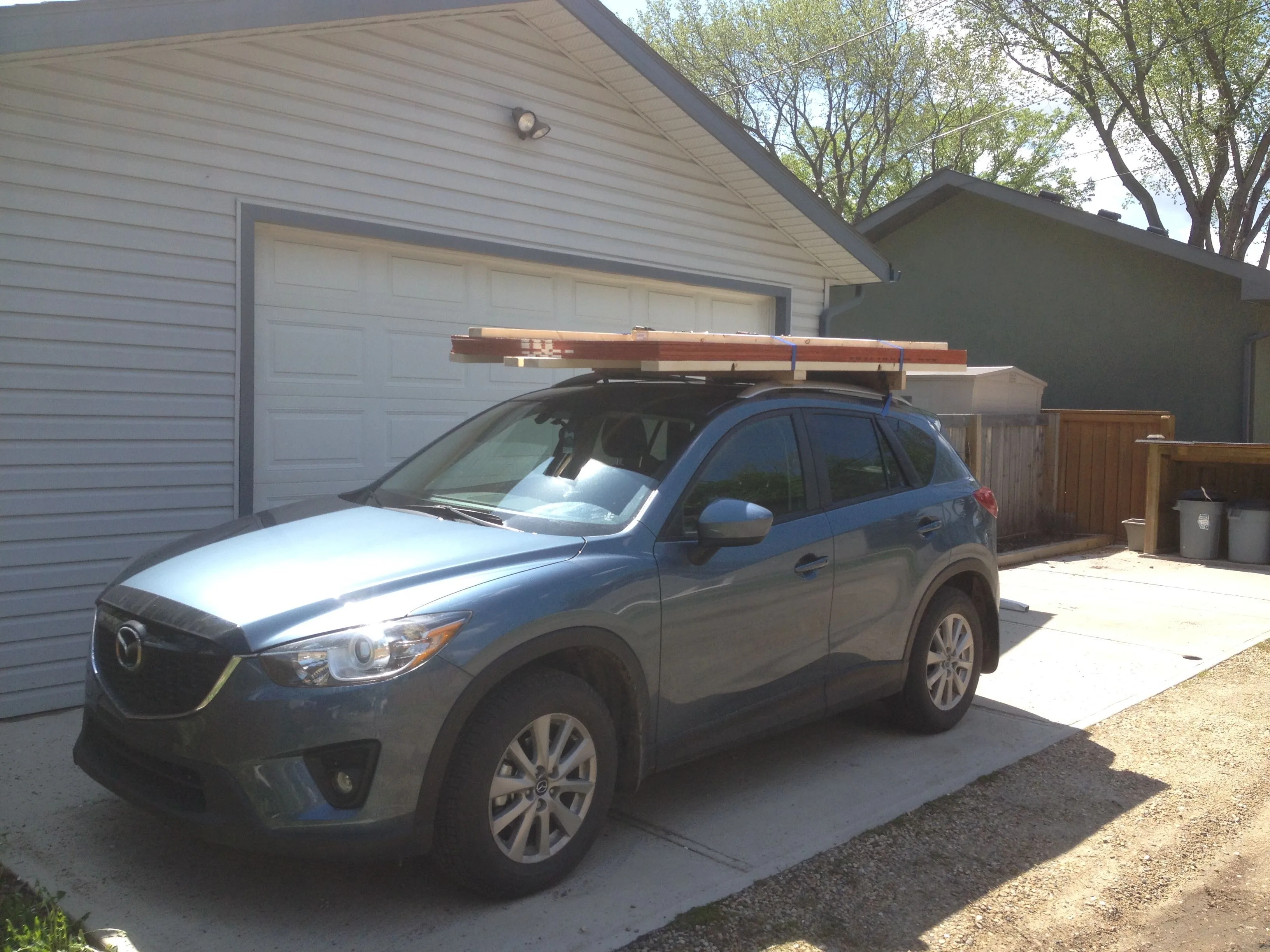

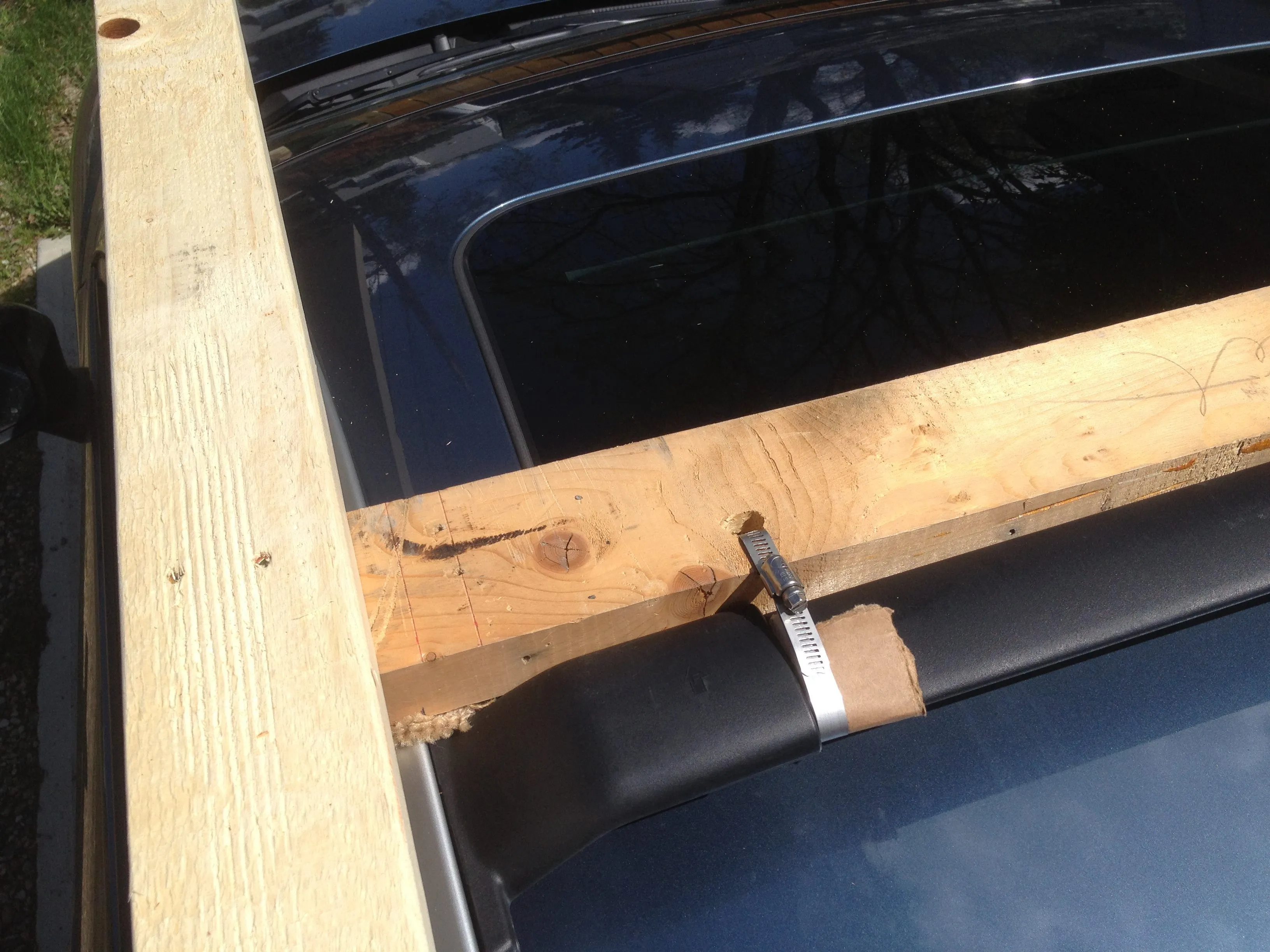

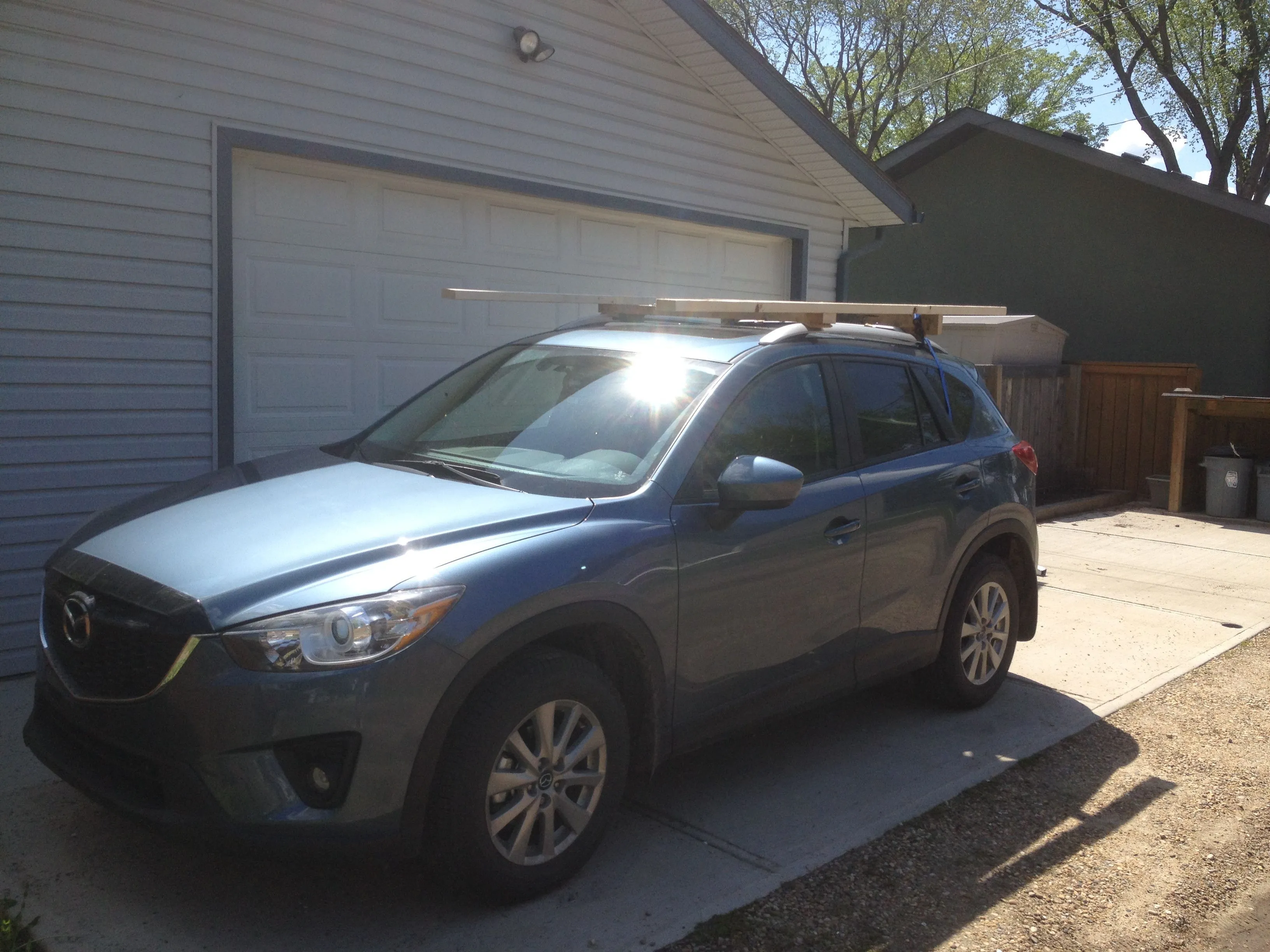

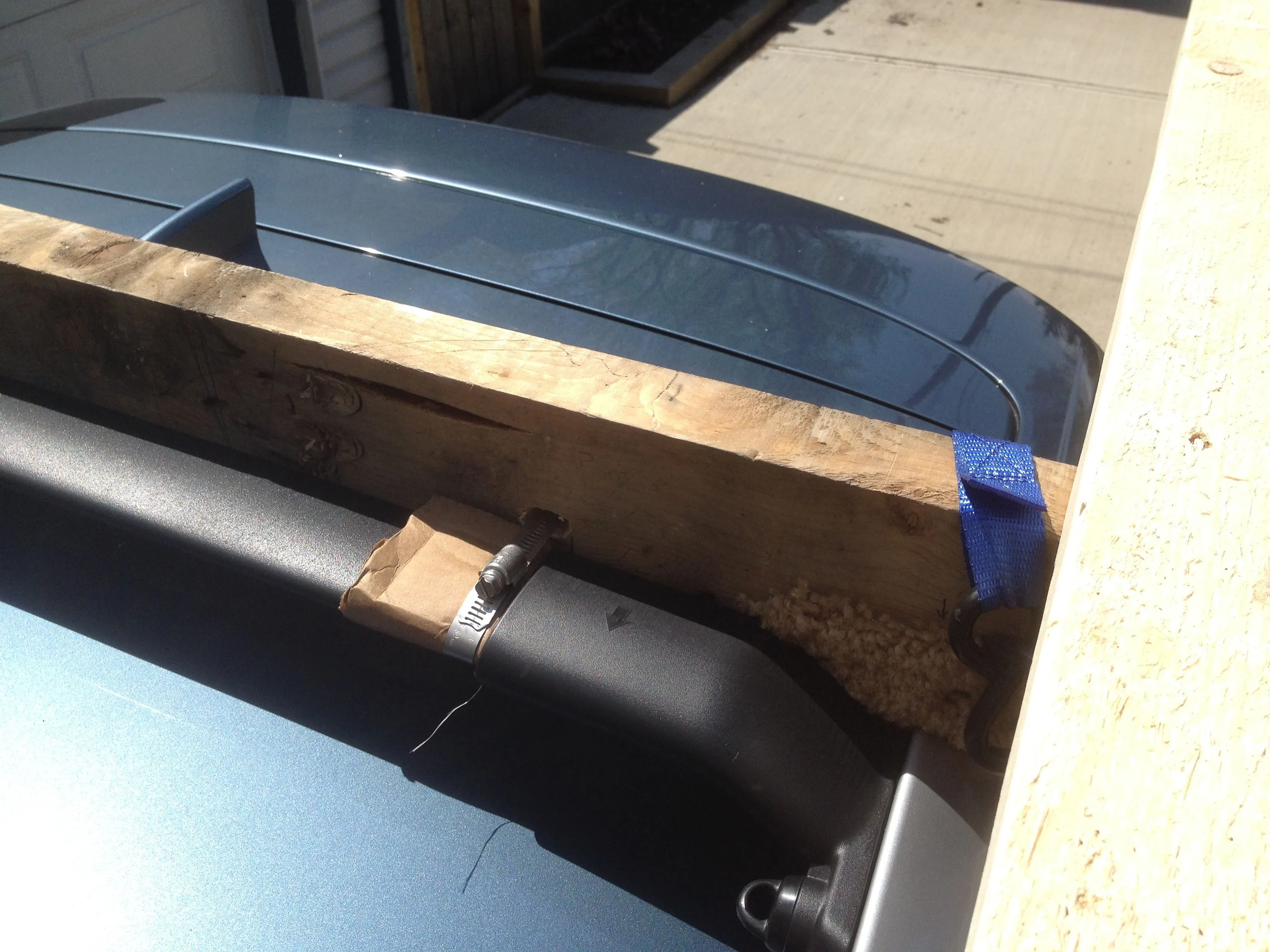

I have the OEM rails and cross bars. I wanted to carry some 4x8 sheets and dimensional lumber on occasion, so I built a quick-n-dirty roof rack out of 3 8' 2x4s and some pipe clamps to attach it to the cross bars. Works really well and you can cinch the load down really tight with ratchet straps without worrying about your crossbars or rails.
Putting the front 2x4 flat and the rear 2x4 on edge creates a rack that is basically level with the wheels.
You could replace the pipe clamps and straps with something a bit more elegant but I was making it up as I went and wanted it cheap -- would love some suggestions on doing it better
Cool! Thanks for posting that, I have considered making something similar. The 2x4s on the flat and on the edge to level things out is genius.

I built it in the Home Depot parking lot before loading it up -- got some funny looks.
Do you feel like the factory bars have enough spread to give you a good base for the wooden rack?
Seemed very stable to me when loaded up with 300lb of sheet material and 2x4. Mounting the 2x4s outside the crossbars gave a platform that was about 3' long. That gave an overhang of 2.5' on either side. The weight sits on the rails, not the crossbars (which I believe are only rated to a little over 100lb), but the longest 2x4 I was carrying was 10'. The attachment to the crossbars prevented the load from shifting/lifting.
I think if you wanted even better stability, add straps or some sort of clamp to the front like the blue straps at the back, which attach the rack directly to the rails instead of the weak plastic crossbars.
That is a great example of parking lot engineering. Well done.
