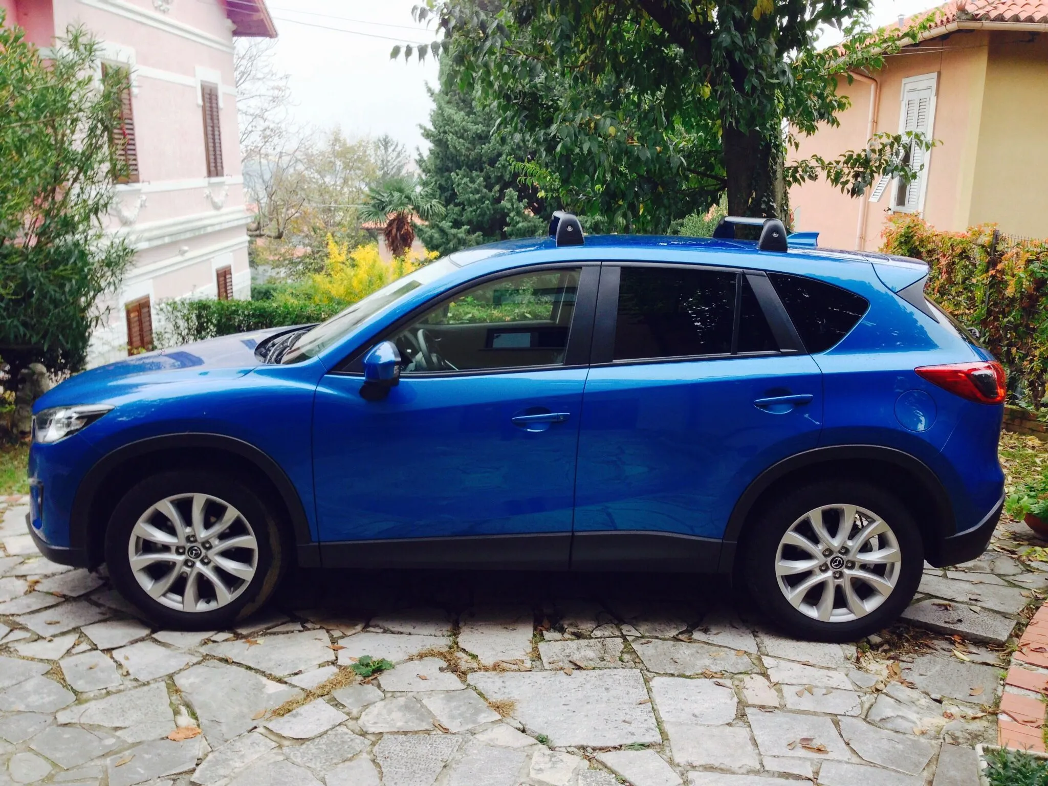

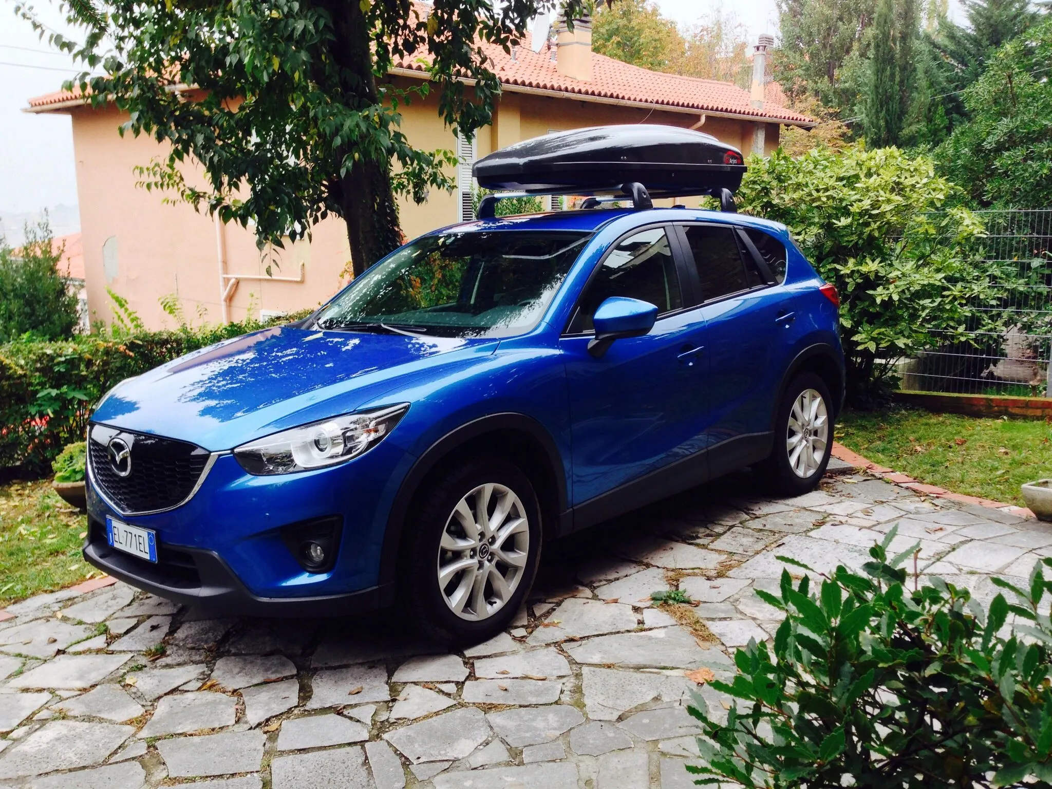

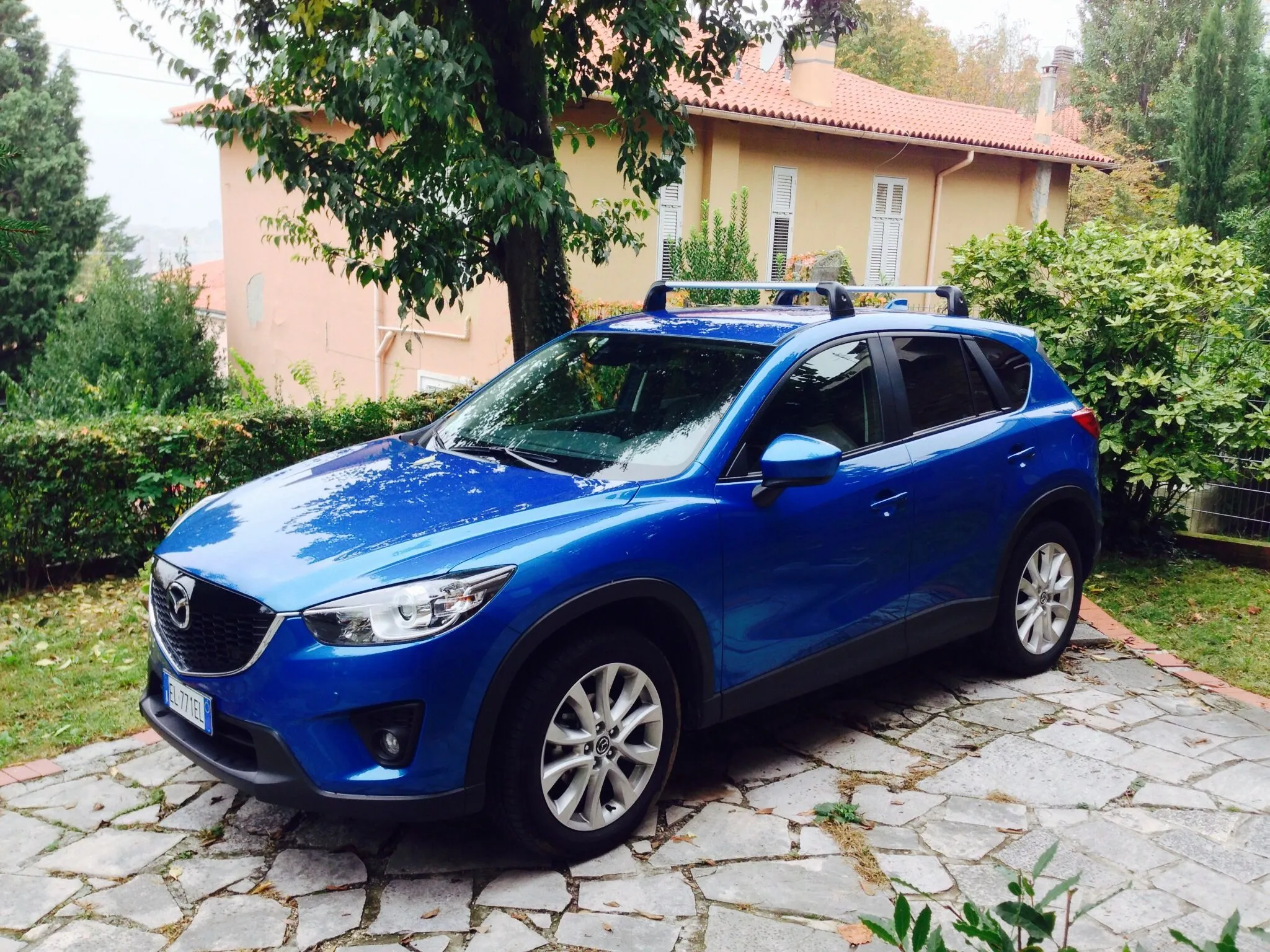

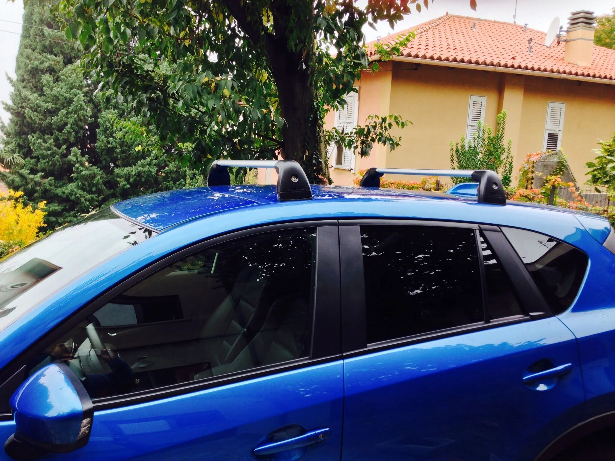

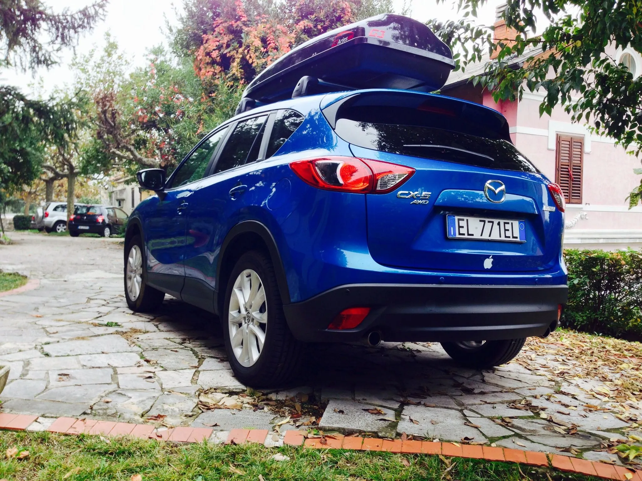

Just mounted my OEM crossbars and my old roof box. Aesthetically not bad IMHO and not so difficult/slow to mount and dismount.
